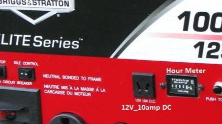

EDIT - a while back on this thread @Flintknapper was kind enough to post a photo of his generator.
I now notice it's labelled as "Neutral Bonded to the Frame." Not sure if good or bad.

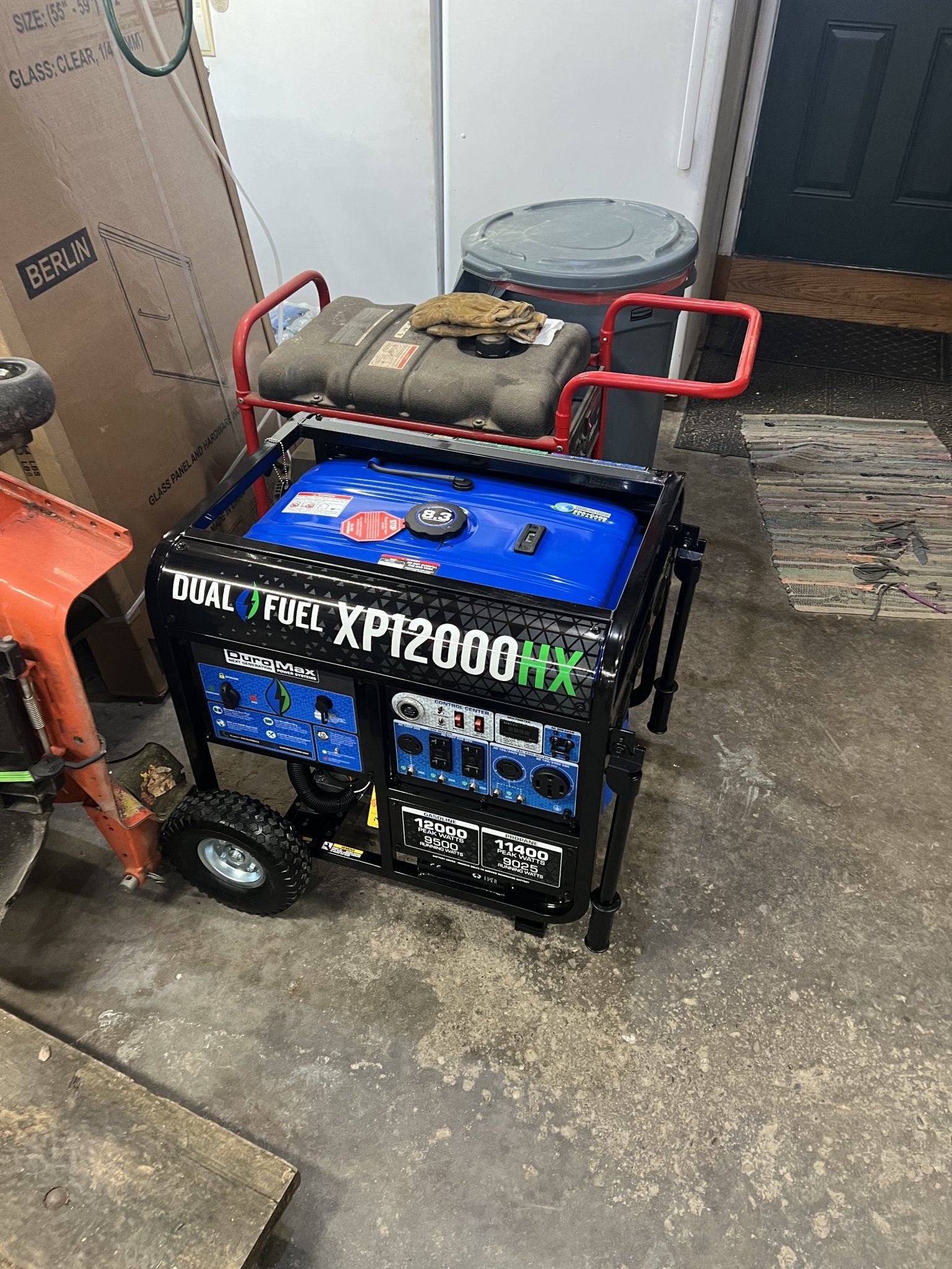

Generator delivered yesterday. Haven't even put oil in it yet.
Contractor is due anytime for second bathroom project. Connection to the house will be part of that project.

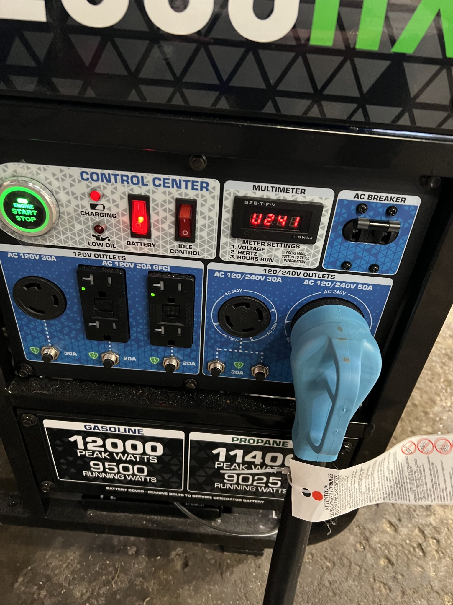

Genny is 12,000 watt/9,500 gasoline or 11,400/9,025 propane. Doubt I'll use propane, but it is an option.
It is a floating neutral. Should be good for the 50A (4 conductor) connection to the house and has an option to ground if needed.

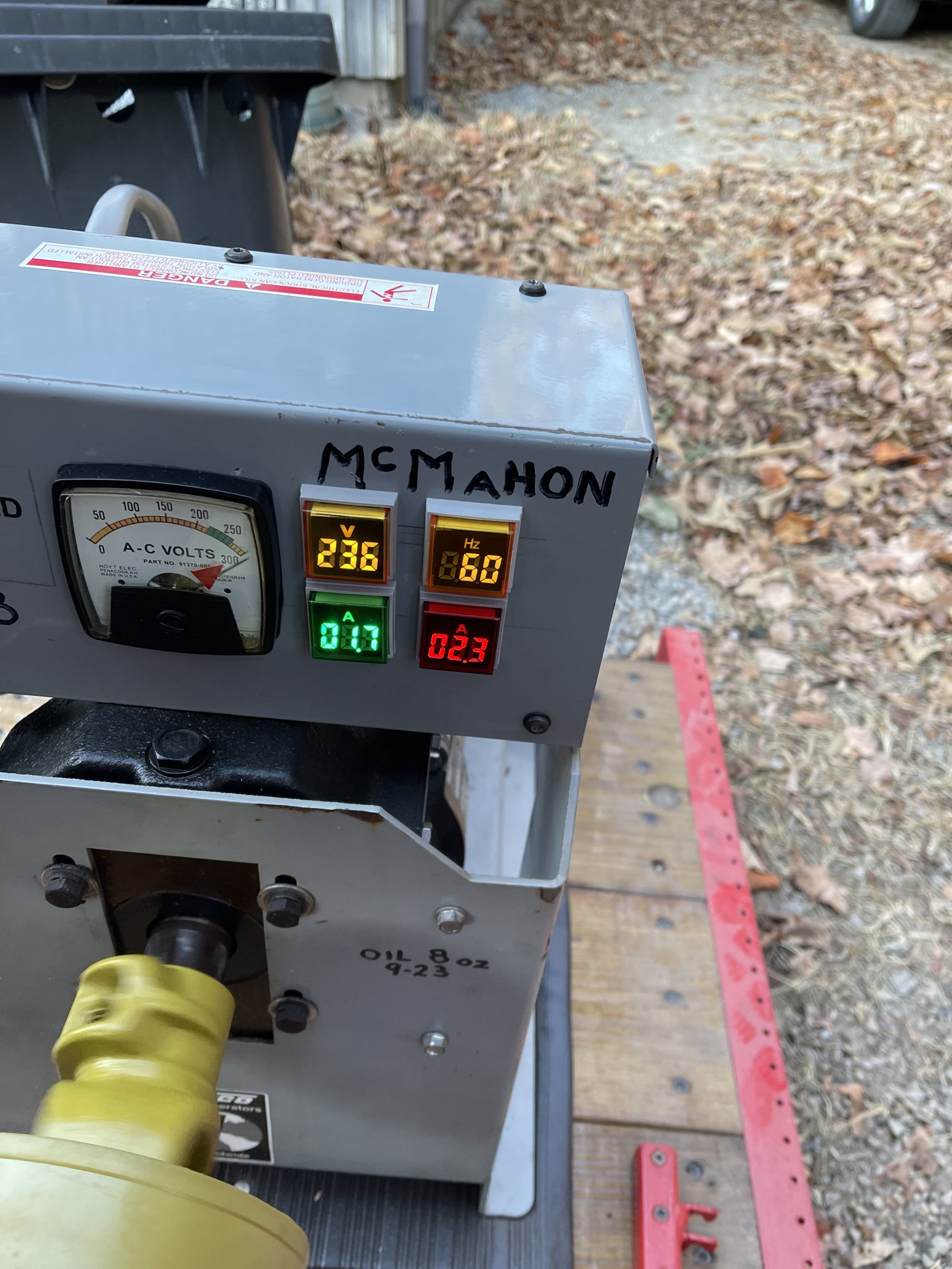

Preparing for power outages with my pto genset has eliminated them!….so far. Do enjoy the low maintenance aspect.
Do have combination of small or large portable generators that have helped the past decades.

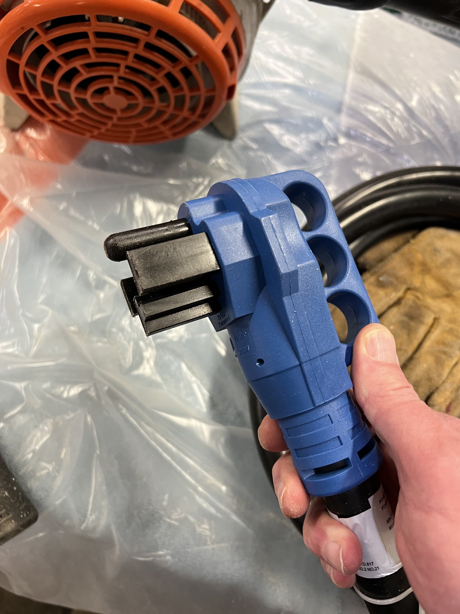

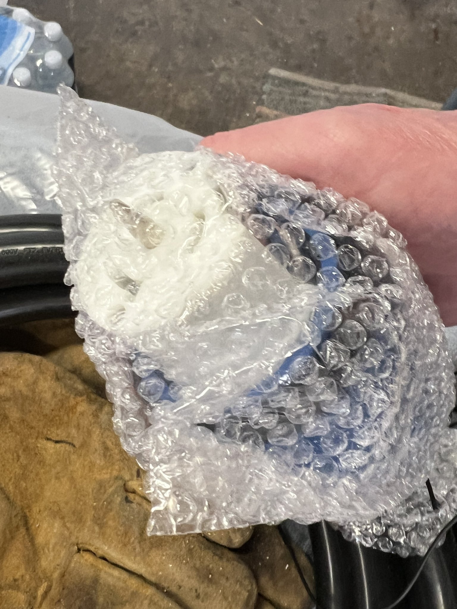

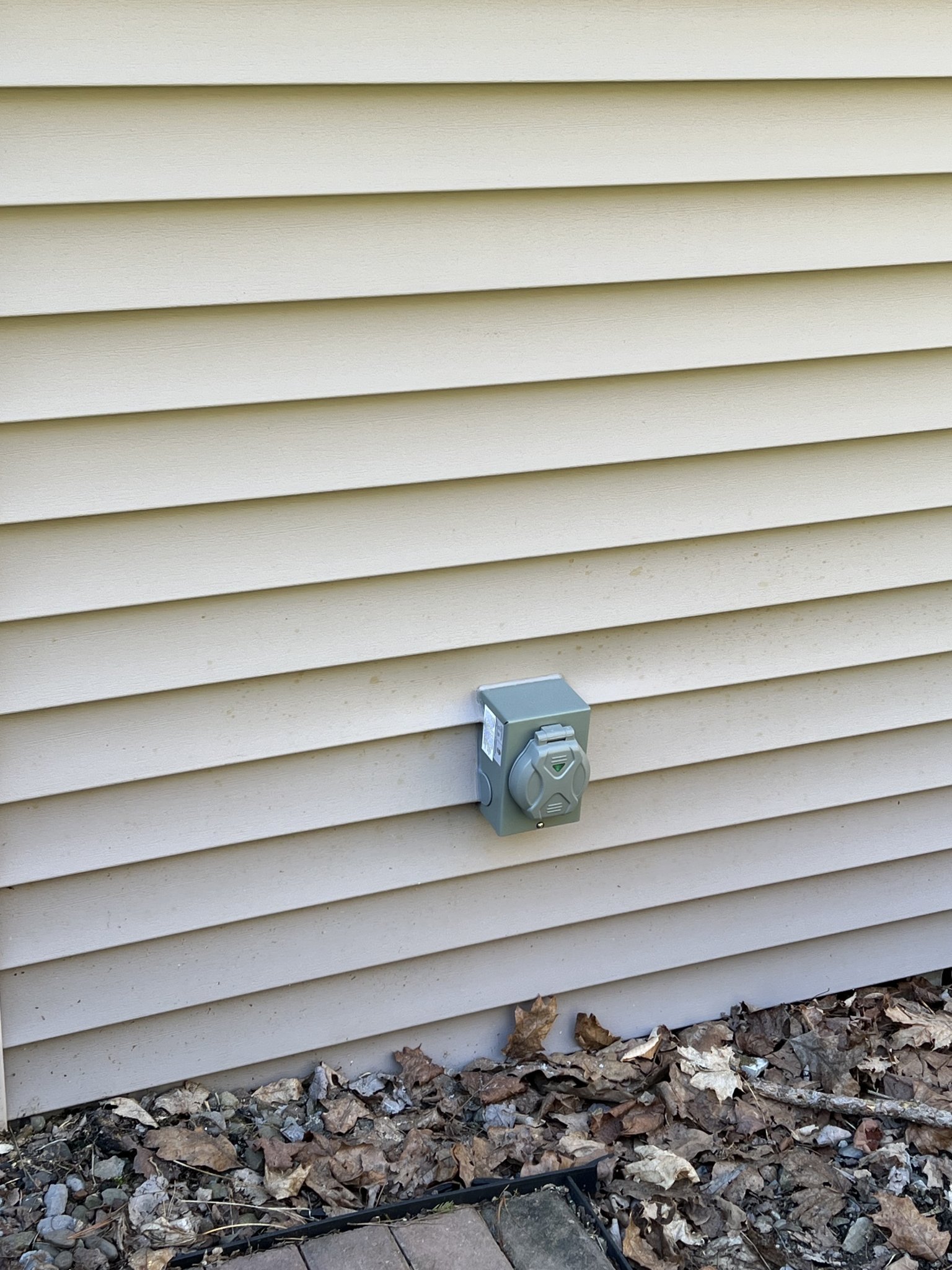

Generator plug installed and a cord ready to go.
House plug. At the end of our patio. Good spot.
Cord - only 15 feet long, but I can make a longer one if need be.
Generator side 50A
House side to plug

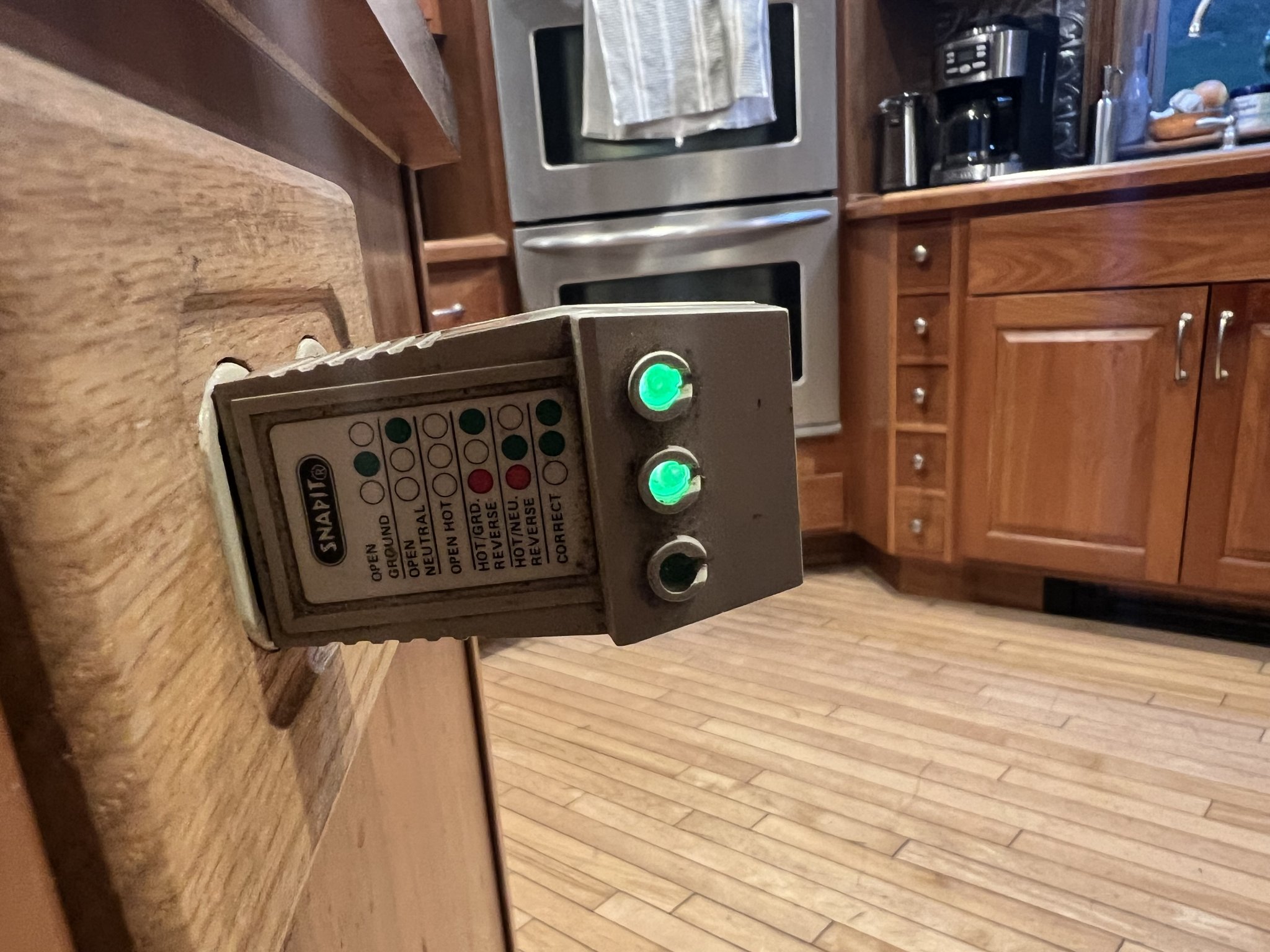

Going to be windy next couple days so did a test run of the generator.
All worked great. Interlock on the breaker box prevents generator from feeding load center with main on.
Generator ran the whole house. Of course big loads like dryer and wall ovens were off.
At 12kw, generator engine barely changed when putting load on it.
I also checked a couple outlets to make sure they were working properly, which they were.
Happy with the results.
