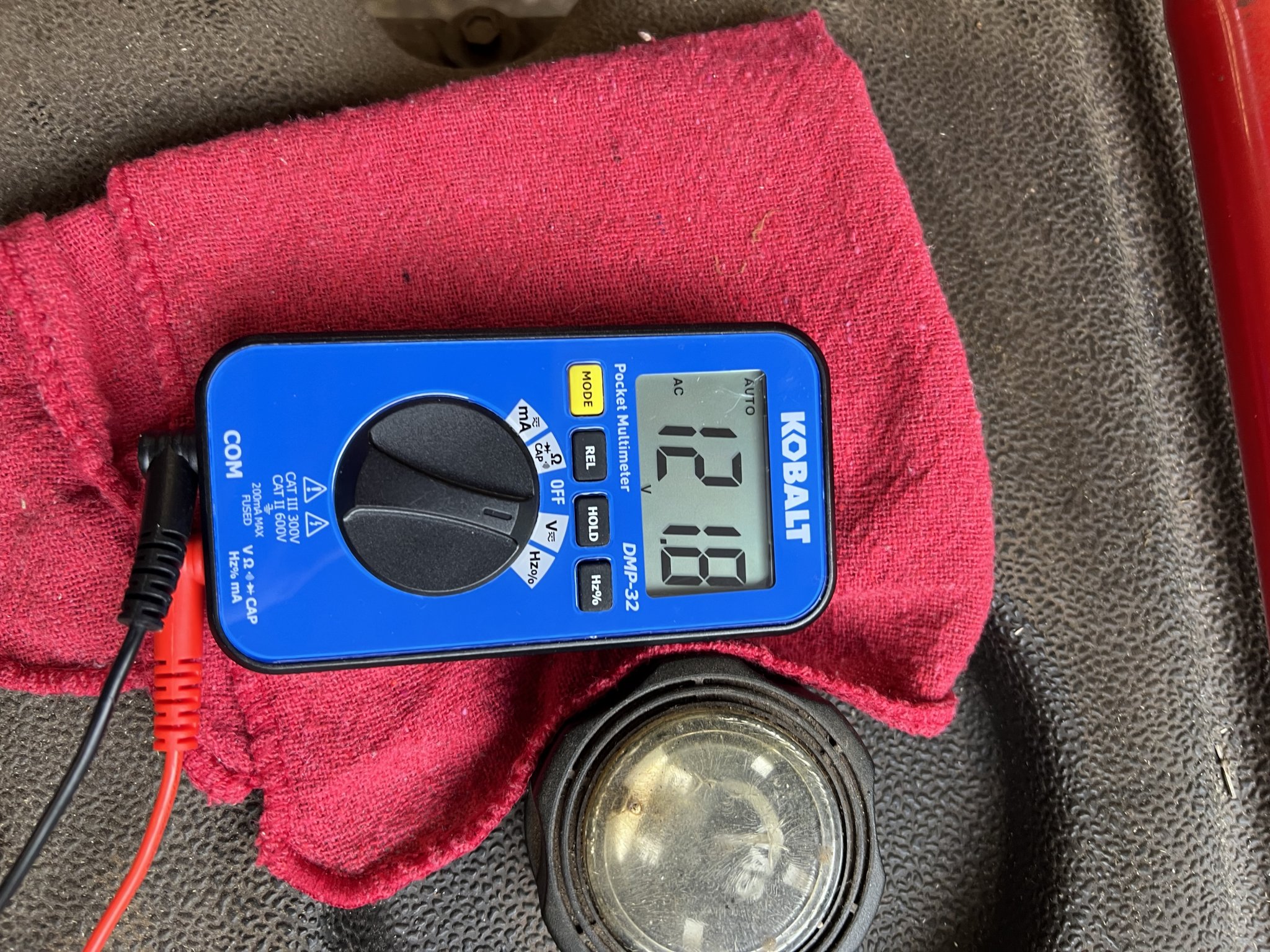

Magicman gave me a good reminder to check frequency. My multimeter doesn’t do frequency.
Stopped at Lowes after work and they had a simple pocket meter that does for $30.
Voltage on 120v outlet
Hertz same outlet. Other 3 measure similar. Didn’t check them under load. Also didn’t check the 240v outlet.

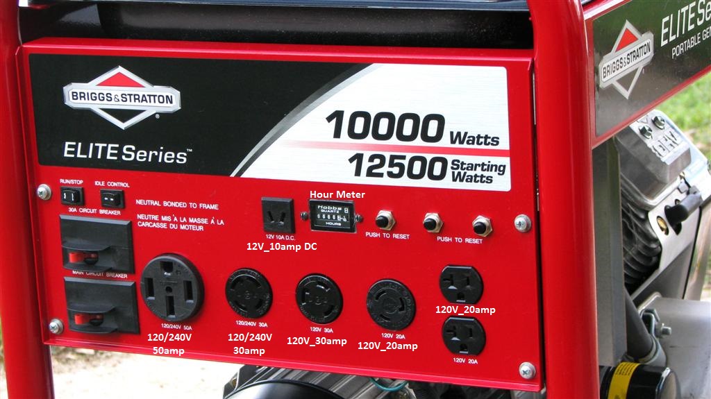

I think I prefer both 4-120v outlets, as well as both a 30A and 50A-240v outlet to plug into the house....I think...:rolleyes:
Yes, definitely get something with as many different receptacles as possible. I use the 50 amp to plug into the house and sometimes run a heavy cord on the 30amp twist-loc in the house and split it off to several shorter cords.
Thanks - - that's what I was looking for. I can see times I'd want to work it different ways depending on weather, length of outage, etc.
I like that yours is a B&S generator. Seem to be an industry standard for a while.

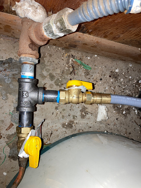

My generator choice was because I have Champion experience with two others, but mainly because it is Tri-Fuel so no bother with gasoline nor LP which can be a genuine pain plus expensive during extended outages.
My water heater and thus natural gas is behind that wall.

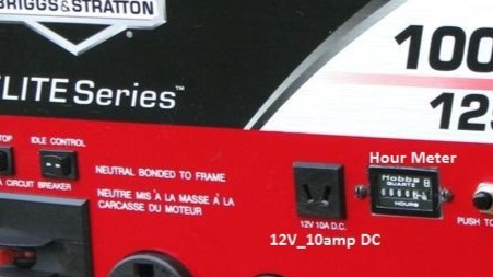

EDIT - a while back on this thread @Flintknapper was kind enough to post a photo of his generator.
I now notice it's labelled as "Neutral Bonded to the Frame." Not sure if good or bad.
Your home already has a bonded neutral. Look in your breaker panel. Ground and neutral wires are probably landed in the same bar. Most portable and standby genes are Floating Neutral because the structures electrical system is already bonded.
In the case of an RV, there is no bonded ground already. That's where a BG gene would be needed.
