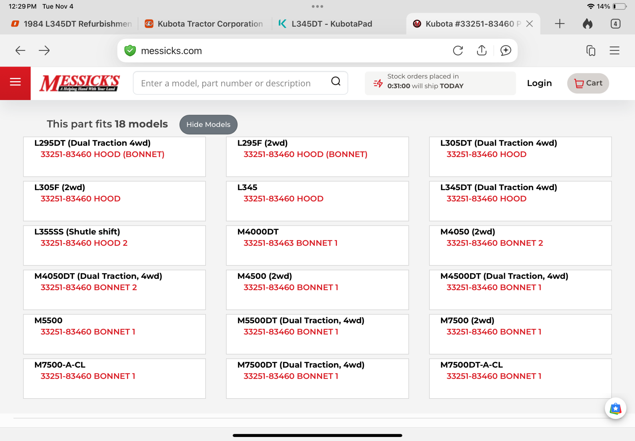

My L345 came without a hood pin. This part is discontinued. Anyone have a source or ideas on how to build a latch to keep the hood from flopping around when I put this thing to use?
Hole where pin secures hood...
Get a picture of one and get "Runs With Scissors" to make one. He likes weird challenges.

That part fit 18 models so you might have a good chance of finding one.
There are used parts available for L series at this place in California
