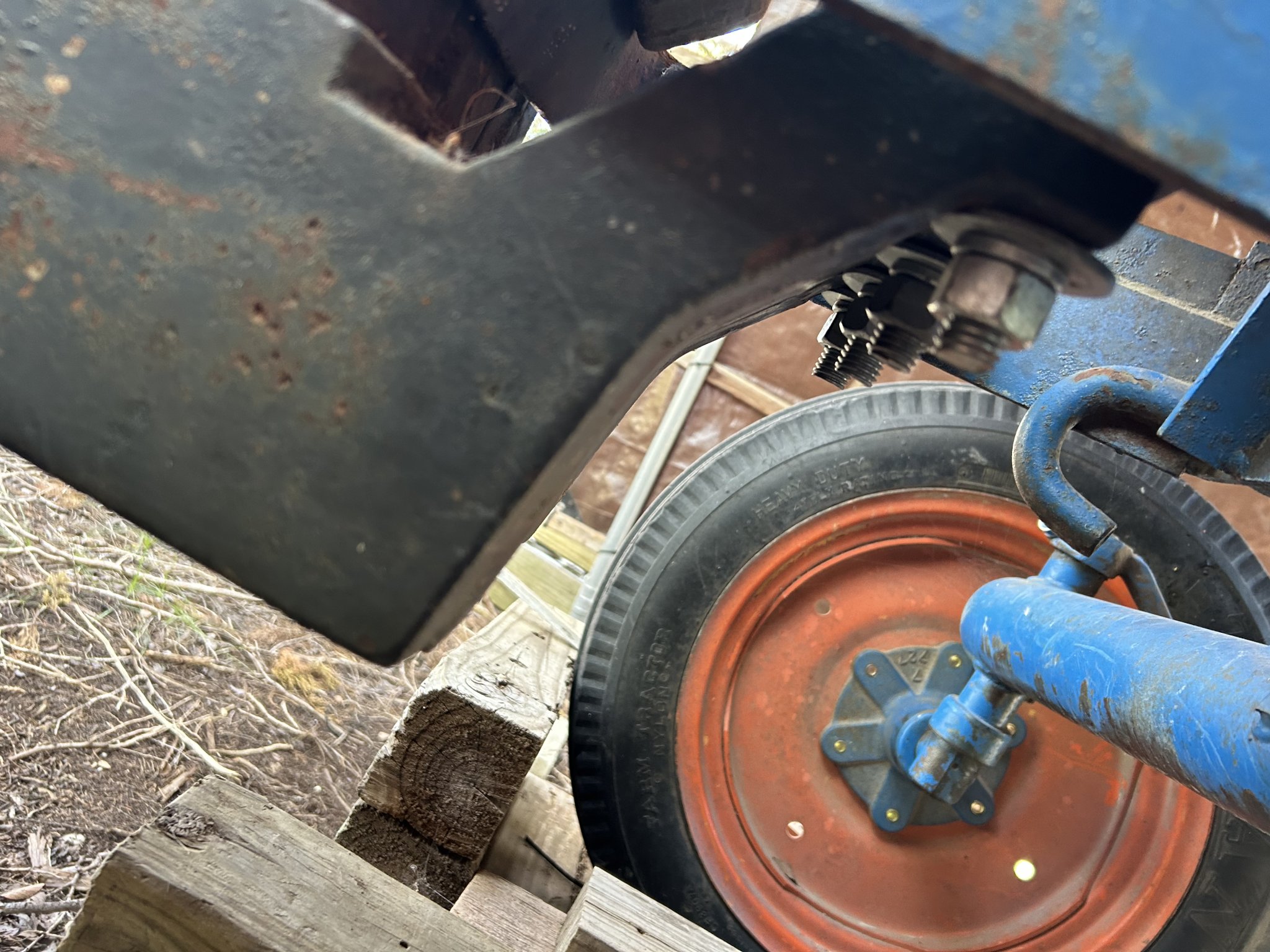

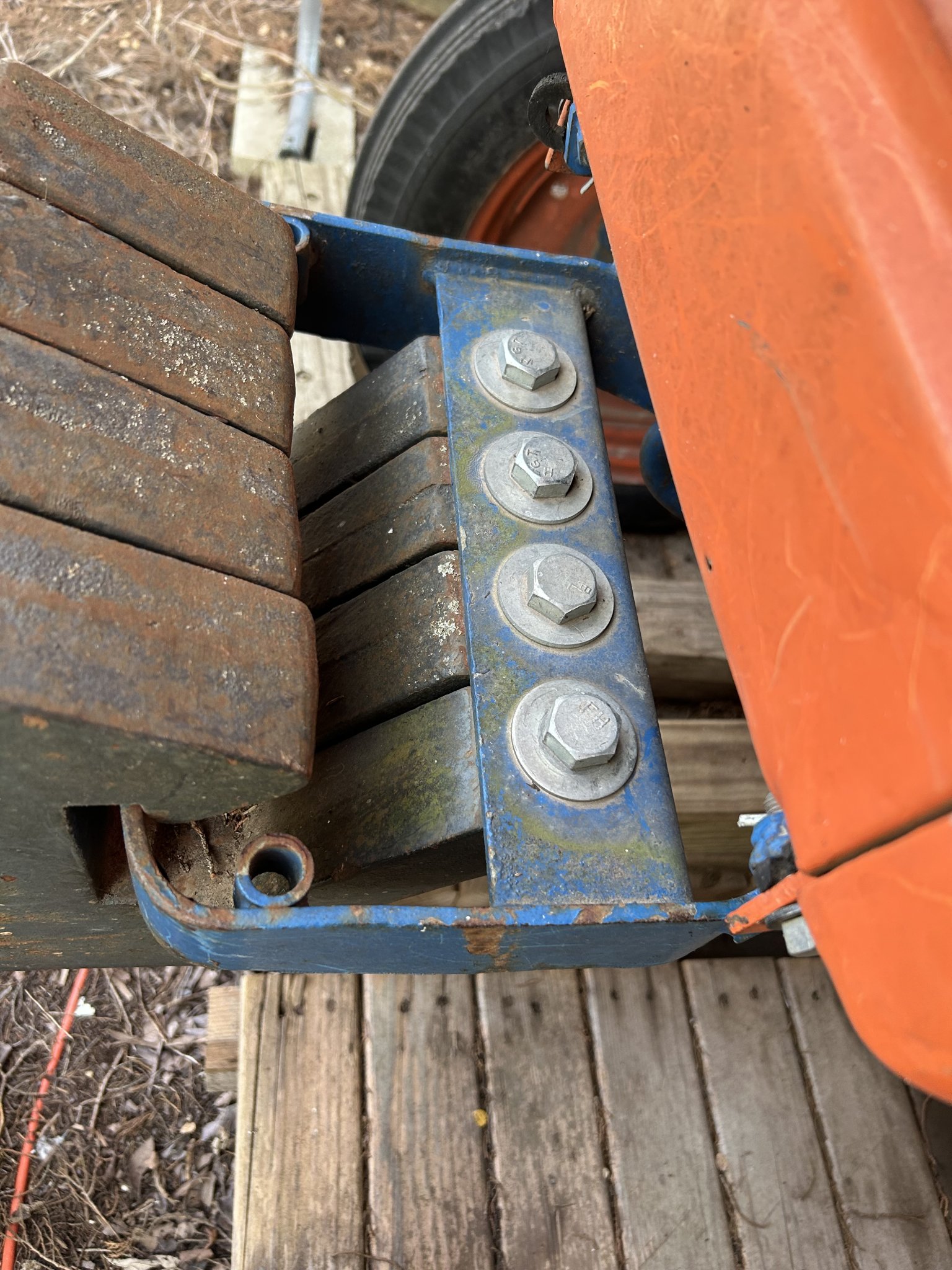

I have a similar L185 that is smaller. The front bumper looks exactly like yours. I bought the 55 pond weights for mine from the dealer. I think that 70 pound weights might fit.
There is a place to bolt them down, I just used a common bolt, nut and two flat washers.
I’ll try to post a picture later, can’t find one now

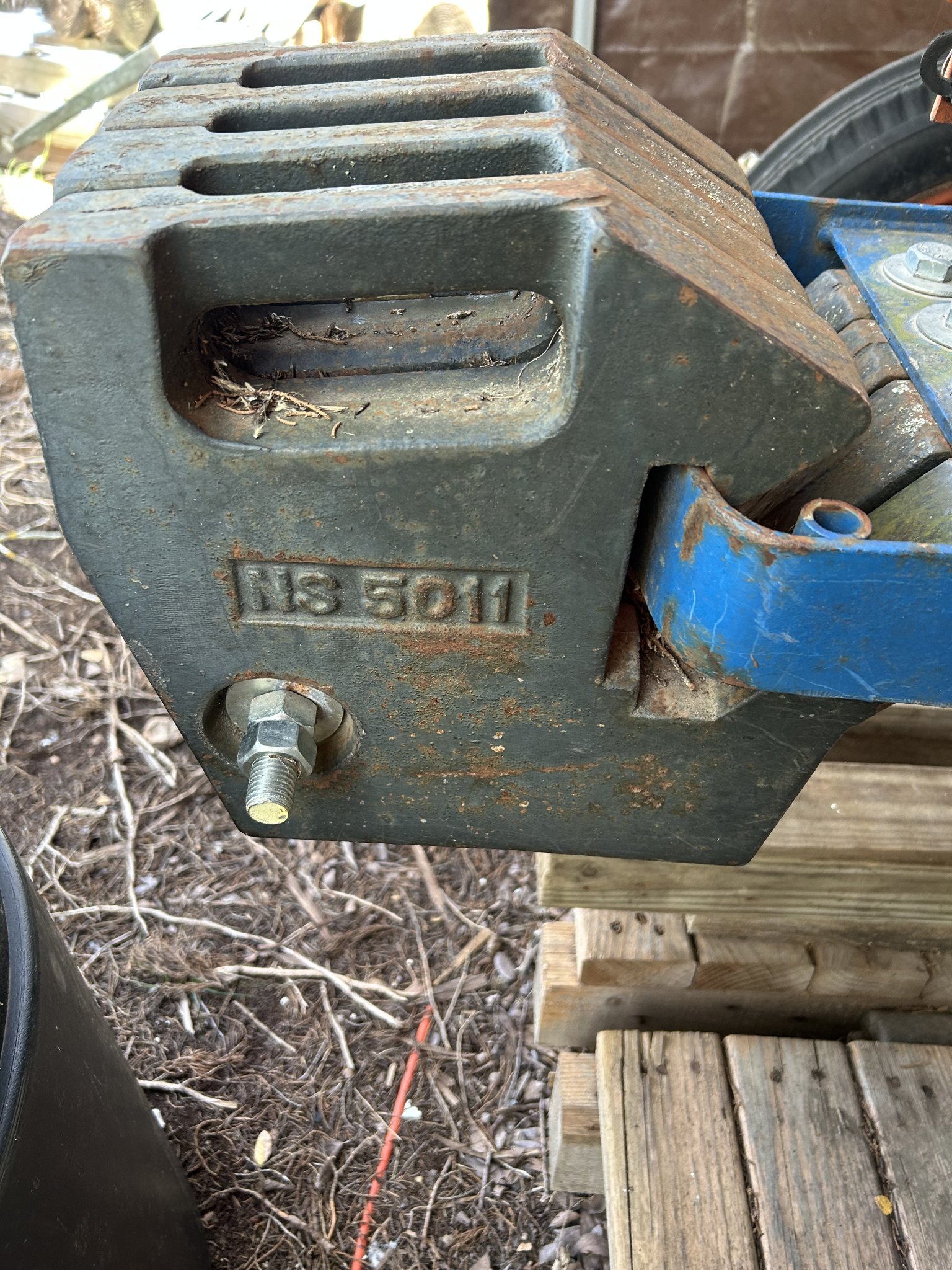

Any pic would be greatly appreciated. There are some tractor weights available for sale in my area on FB marketplace, but I'm not exactly sure the appropriate style to purchase.

Any guidance on the correct style of suitcase weights for this model? Can someone point me to a picture of them?

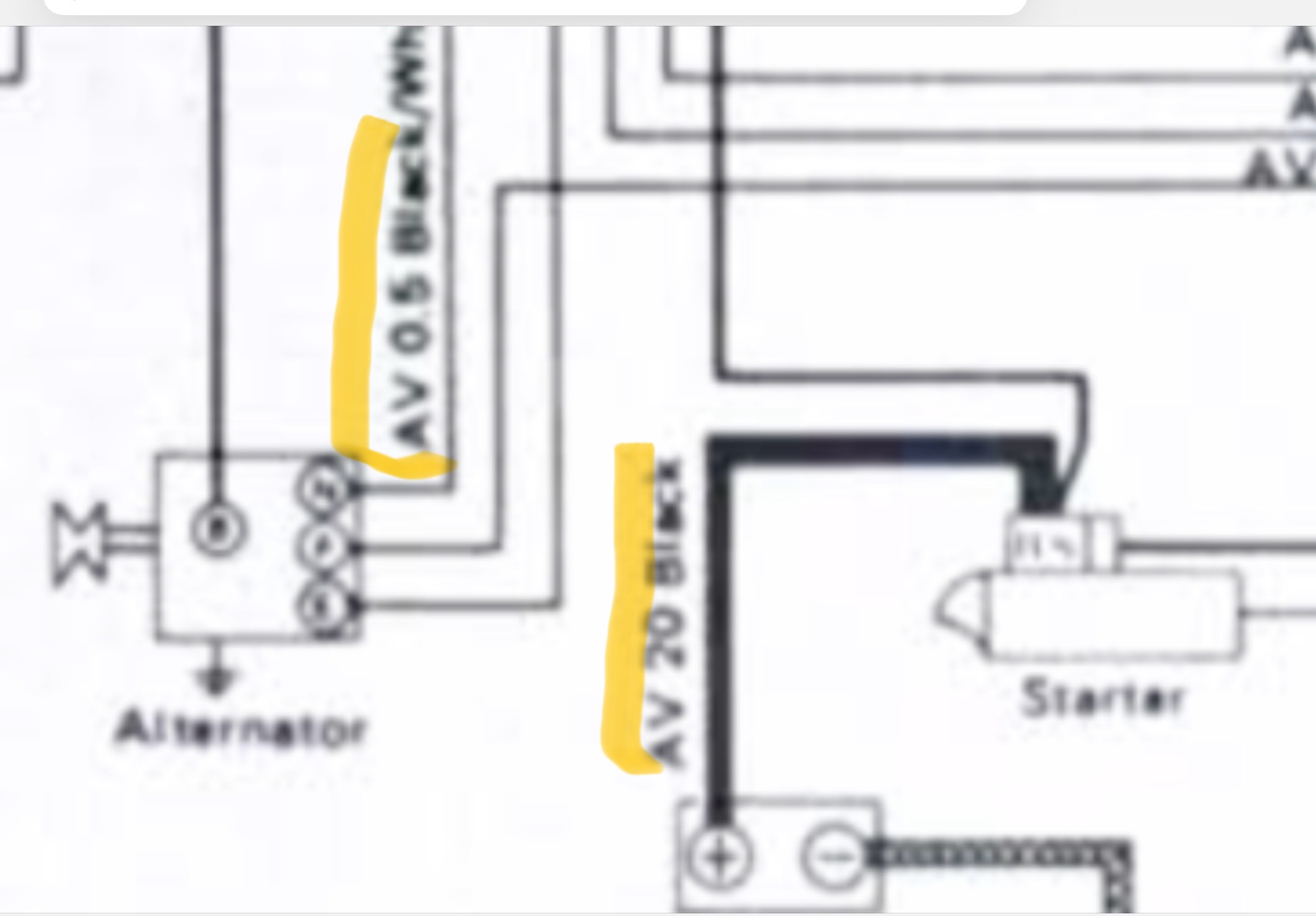

What gauge wire do you use for the system? I imagine it's 2ga for the battery leads, 14 for basic energizers, and something in the middle for power to the glow plugs? Any guidance there? I've printed the service manual and plan to laminate a blown-up copy of the wiring diagram to make life easier. Ordered a new starter and alternator too. Will probably replace the fuse box with a blade type and pick up another voltage regulator to have a spare. Ignition switch should arrive soon as the key in the current one just spins.

On the weights, I was just at the property and completely forgot to take the picture. But will try to remember Saturday when I get back out there again.
The schematic shows the metric wire size in mm squared. There is a term ”AV” in front of the number but I can’t remember what that stands for. After the number is the color code. Here is a sample of the schematic with a highlight on the marks

According to the web the AV 0.5 Black is a 20GA AWG vinyl insulated black wire. The AV 20 Black is a #4 AWG Black wire:

Well miracles do happen (not that you really need the pictures any longer), but here are the pictures of the front weights on my L185F.

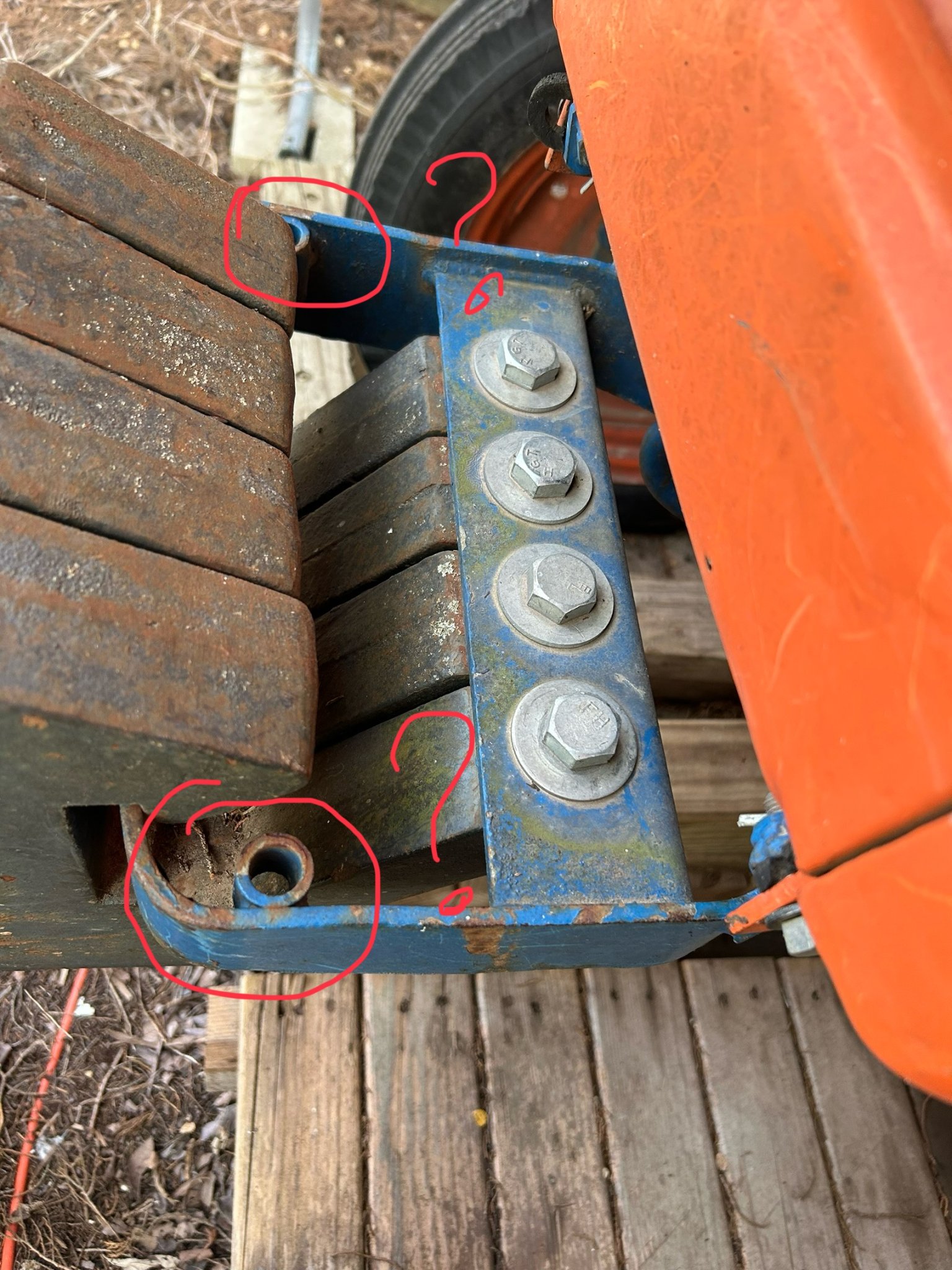

Does anyone have any idea what the vertical tubes are used for in these older L series front brackets? Circled in red in this picture.
