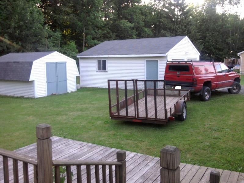

My .02 cents worth.
You can never have a trailer thats too big. But a trailer that is too small can be a hassle.
If i had a choice, i would be looking for the biggest trailer my truck could handle-within reason of course.
Deck on mine is 14 feet, way too short for a lot of things i want to move, yet somehow i find a way to make it work.
