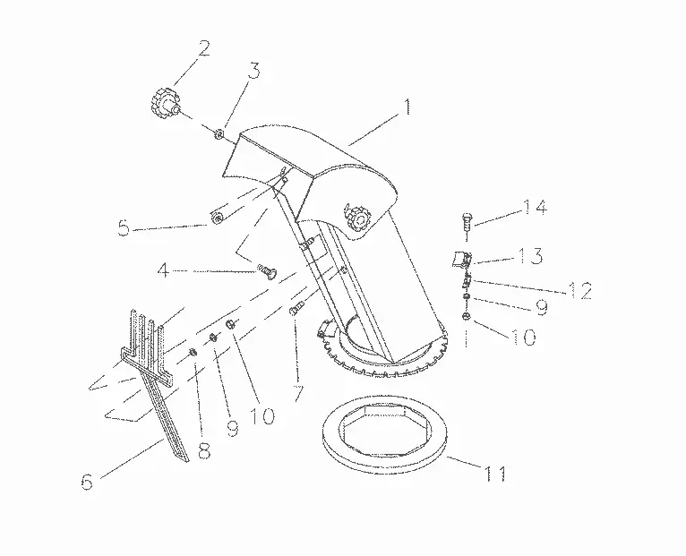

Possibly this will help you..
Thanks...I have all the info as shown on messicks (great company) the issue is the details on the type ofpuller or bolt thread details to get the fan shear sleeve off the keyed shaft...I believe it’s similar to taking off a snowmobile clutch but I am in need of the technical specs before I just mash in a wrong thread puller.
