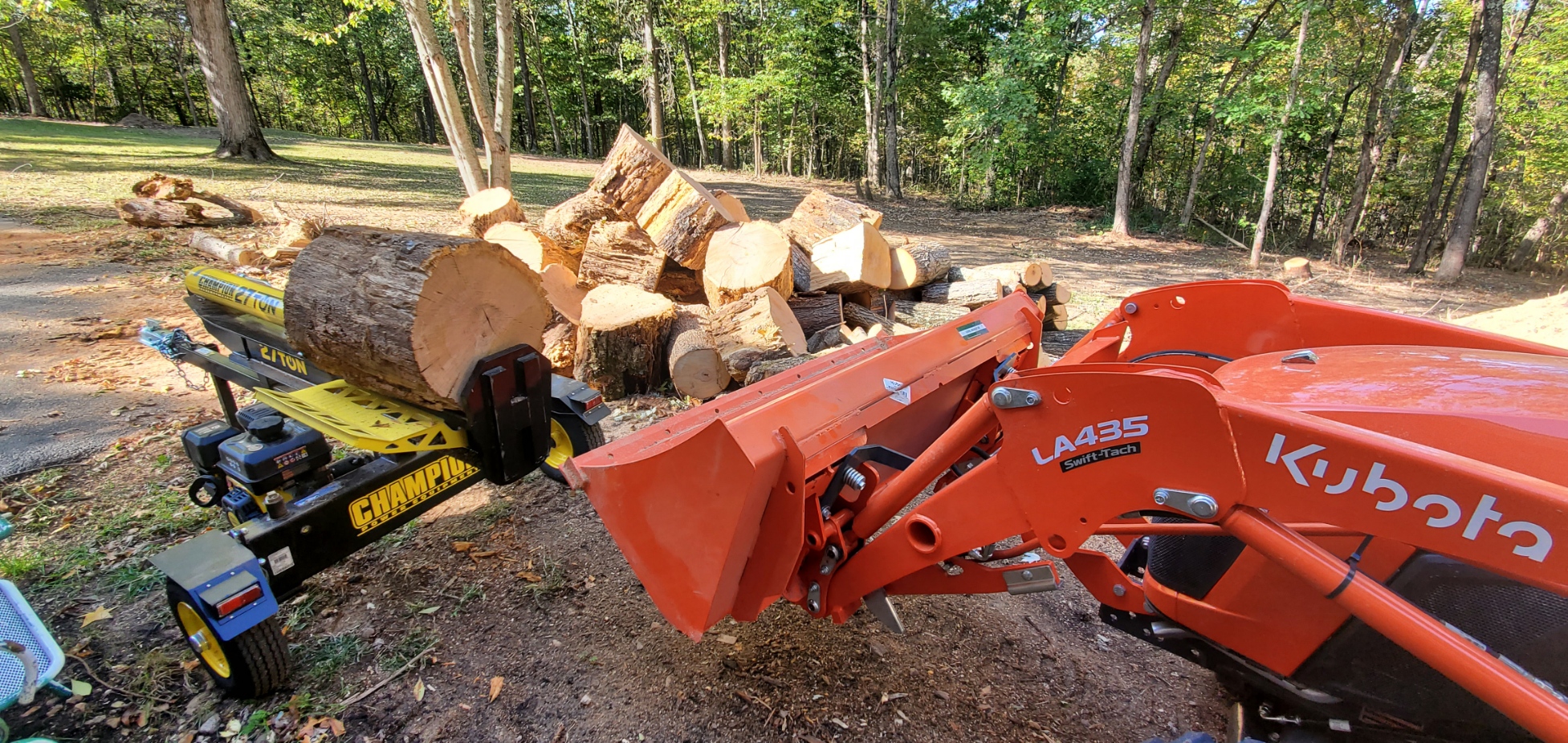

We had the same discussion when getting our splitter. I went with a used stand-alone.
I am glad I did since I use the bucket to kind of feed the splitter. I load it with cut logs and level the bucket to the splitter. Then I roll them out of the bucket right onto the rail. After they are split, I throw the wood into the Brinley.
Couldn't do that with a PTO set up.

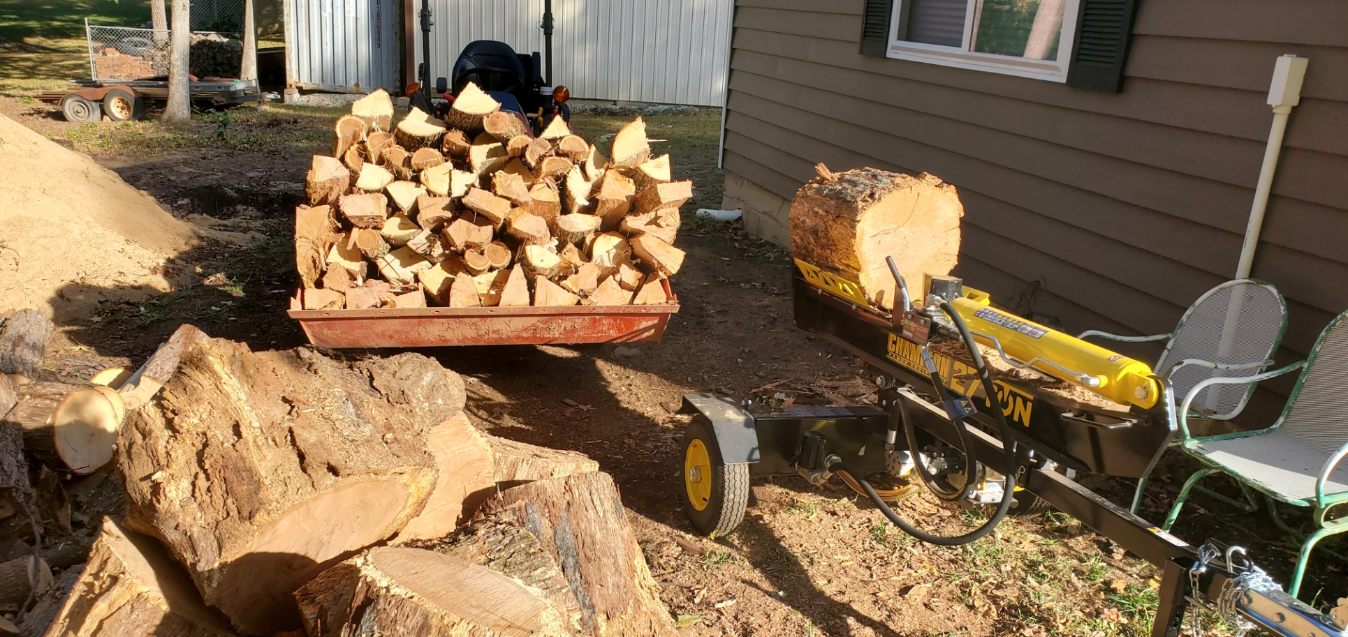

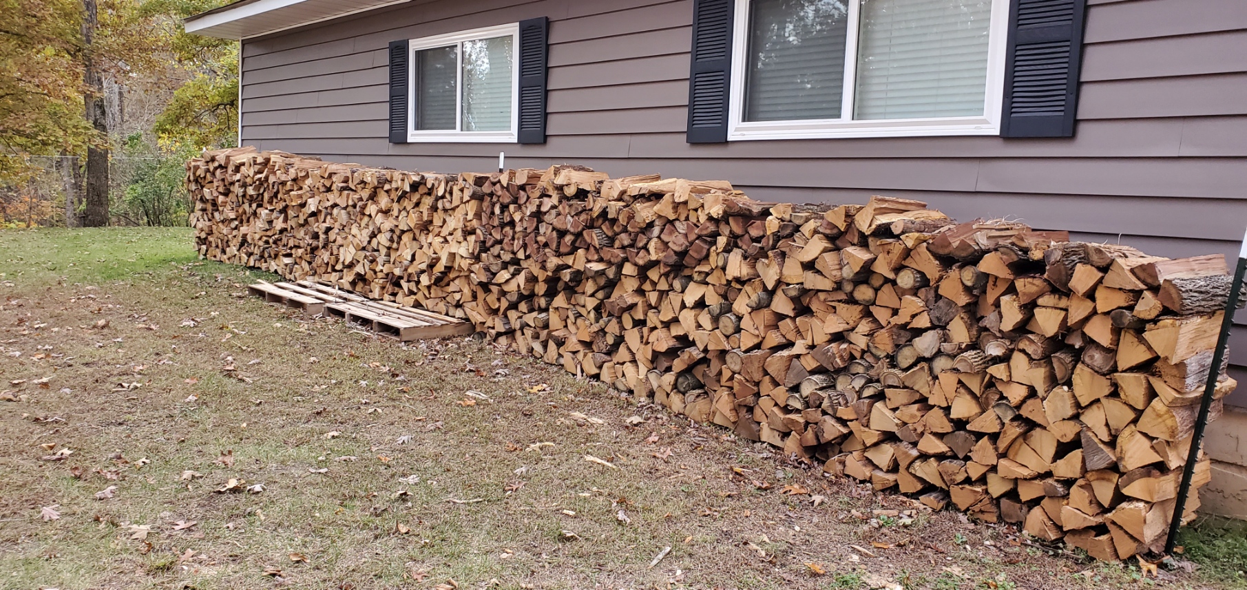

Yep, I do kinda the same. 27 ton splitter about 1300 bucks. Transfer is level to bucket, moved and unloaded where ever ya need it at the height ya want. 1.jpg 2.jpg

Yep, I do kinda the same. 27 ton splitter about 1300 bucks. Transfer is level to bucket, moved and unloaded where ever ya need it at the height ya want. View attachment 69154 View attachment 69155
Having seen those pics, that seals the deal for me. I'm going to go with self-contained. I can definitely see the value of having a free tractor, and it barely costs more than PTO driven. Thx all! Alex
You are pushing that 27 ton ram to its limit from the looks of it. That is what I have to do this weekend. Cold weather coming and I'll need about two cords to get through winter.
Most of it was from dead trees, so easier splitting. It strained a bit, but plunged right through. Got a lot done in a few days. (-:
