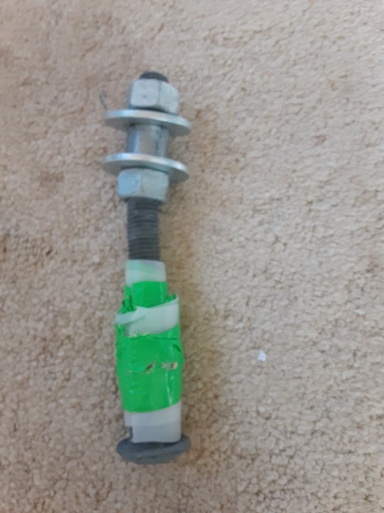

I have two approaches I'm focused on:
1 - Make longer bottom "pins" for the implement. The photo below shows my cheap steel mockup, which bent almost immediately (the green duct tape was my mock bushing). I've ordered grade 8, 8" x 3/4" bolts to see if I can make longer pins that are strong enough. If so, this effectively widens the width of the baler, so it'll fit on the QH15.

I don’t think you will ever get long bolts that would work. You could probably get a larger diameter bar machined at one end as the pin and threaded internal hole at other end to bolt to the implement and replace the existing pins.

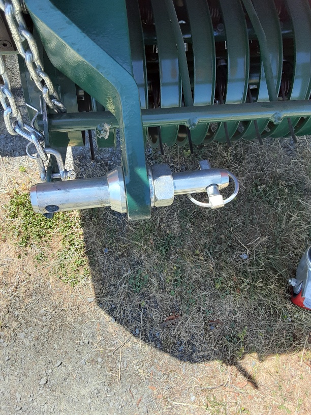

Ok, I'd like to know ,...
just what IS the baler's 'pin to pin dimension' ?
I went back through this thread, because I thought I'd said that earlier. I'm slightly off the hook though because I did say earlier how wide the QH is and how long, long-enough bolts would be :)
But to answer the question directly: when I set the pins so the Cat I's are on the outside, it's 23 1/4".

Are you using the inside pins? If so can you reverse them and put them on the outside? It's not clear from the photo but it looks like it has dual pins
icehorse
L3901, box blade, tedder rake, mini round baler, drum mower, rotary cutter, misc
Aug 10, 2022
156
31
98261
My bad. I took that picture before I reversed the pins. The cat I pins are now on the outside, and that pin to pin dimension is 23+inches.
