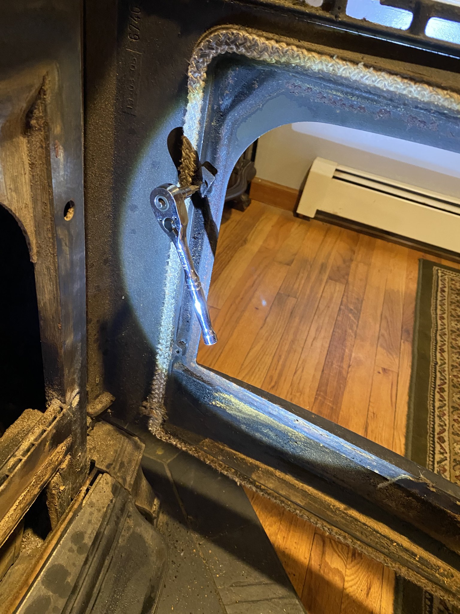

Replacing door glass on my 15 year old pellet stove. Stove has a cast iron body.
One hinge-side bolt was tweaked a little and didn't want to give. 5/32" allen, that I stripped. 80 tons of pellets, and 15 years made it a lil wonky.....
Drove a torx bit in it....I could hear my Grandfather, my Dad, D2Cat, Fordtech, Daren and many others saying "don't crack that cast door....."
All I could think was if that were not the hinge side, it would be so easy......
Success.
It's never the ones you can get at the give problems. Again, this is pretty mild compared to many machines today....everything is so tight.
