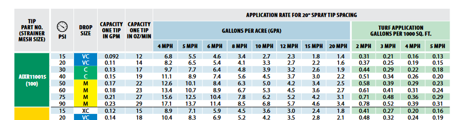

I downloaded some TeeJet information and it looks like my sprayer might have nozzles similar to the AIR INDUCTION XR FLAT SPRAY AIXR110015 nozzles given the output I measured at 25psi.

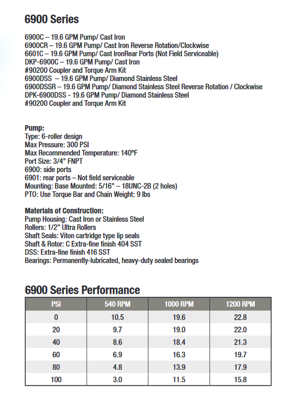

@bird dogger, I am going to investigate the idea of making a wider boom. My current FIMCO sprayer has a Delevan 6900C 6-roller pump with more than enough GPM to run a wider boom with more nozzles given the ~9GPM capacity at 25psi or so.
I see a FIMCO system similar to mine on CraigsList and perhaps there's a way to add two 55 gallon tanks in parallel to increase capacity. I have time to figure this out and there's always handing over $4k for a turnkey solution. :)

Is an agitator needed when so much fluid is being bypassed back to the tank? My post above shows the capacity of the 6-roller pump and it's moving way more liquid than is coming out of the nozzles.
You can try but agitators work better. If your mix separates you wont like the results.
