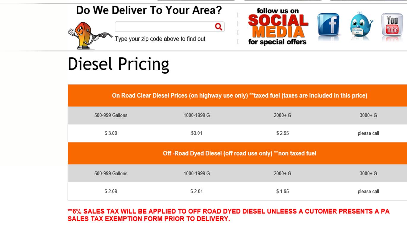

I see Skeet's lives in PA, therefore the spread between On-road and Off-road diesel is a lot more than 20 cents/gal. State tax alone is a $0.75 per gallon, so it can add up.
If there are two pumps at a station. One selling diesel at $2.75 and the other is $2.00. Which one do you pick?
Below is an example from one supplier....
