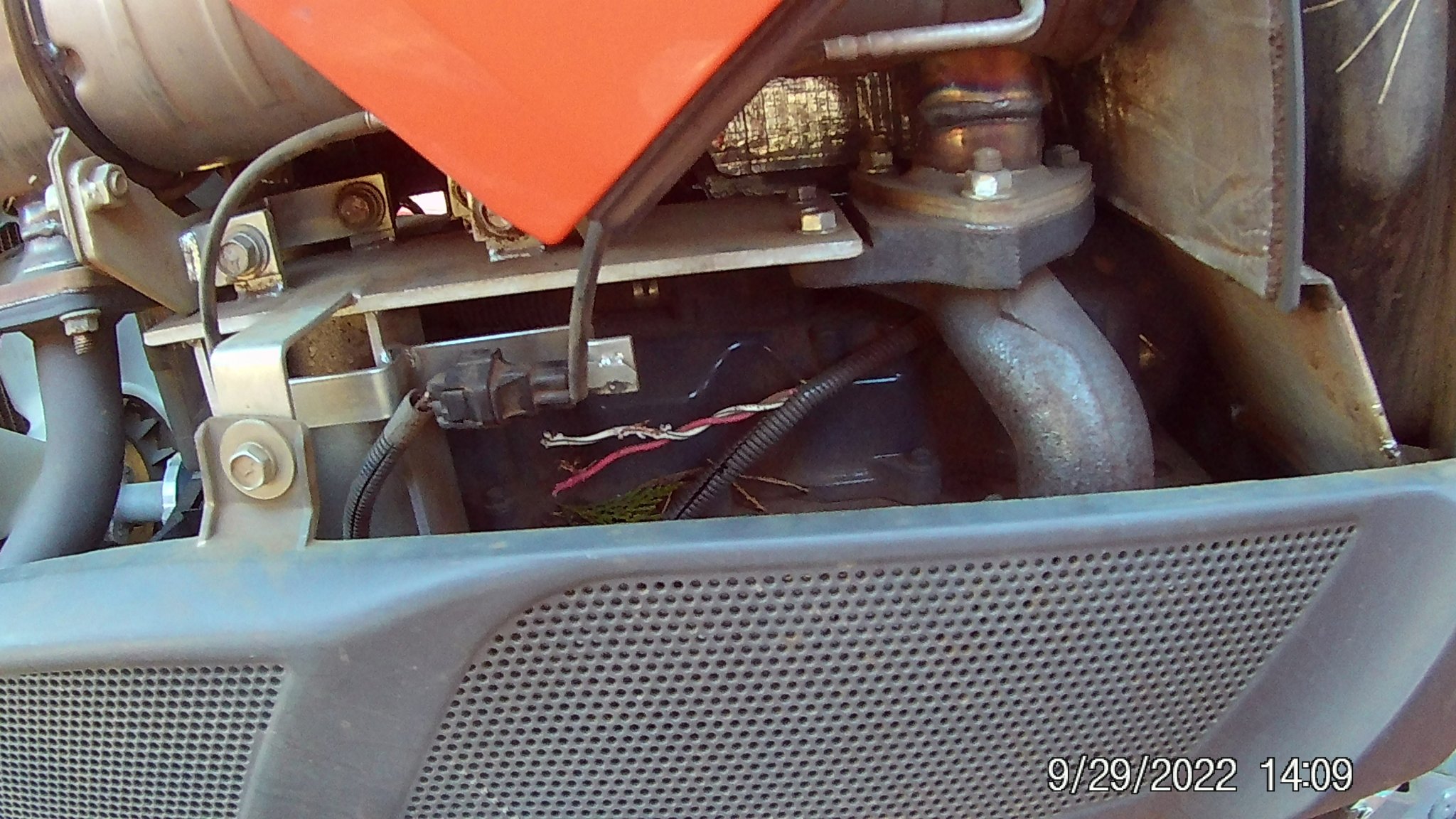

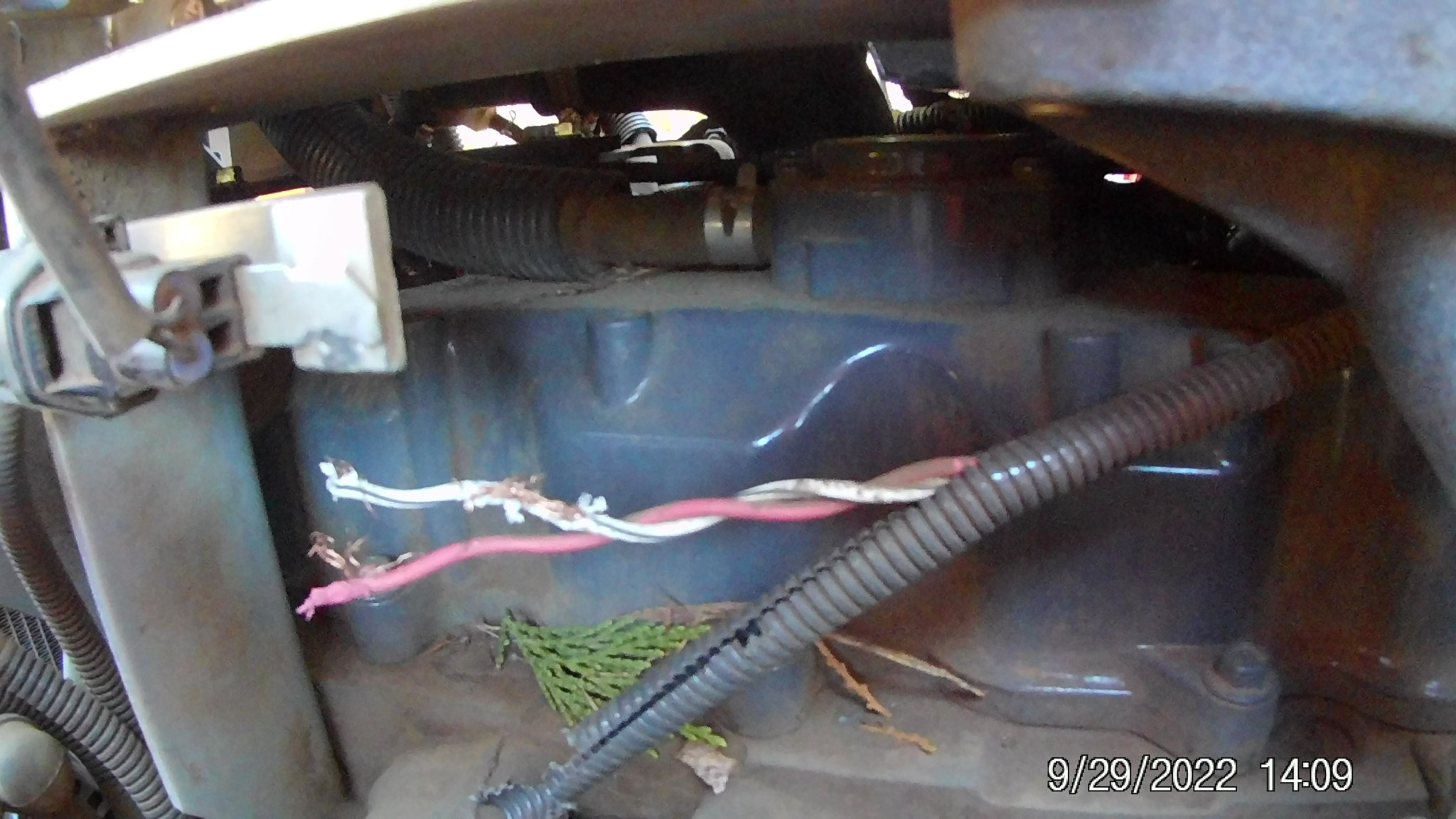

Pack rat chewed up the wire in the pic, its the only one i have found. Not sure where it attaches. Any help would be appreciated.
Thanks

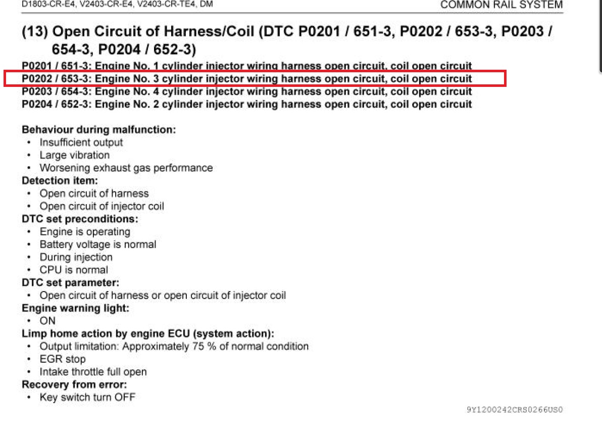

I have pasted below the page from the Diagnostic Code manual.
Look at injector #3
I am not a code expert and just providing what I can find.

It goes to those wires that are chewed in the bottom side of the pic wrapped in plastic conduit. Make a jumper… wire them back together….then cover them ALL in conduit.
Find a cat.
