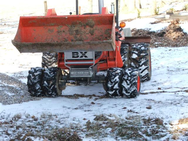

And here we are worried about adding a couple inches of spacers to our BX tractors!
Picture from a TBN thread started by Milkman 15 years ago. I think he ended up removing the duals, but not because something broke. For another reason that eludes me...
Pretty Wicked looking!
Something would have broken.
