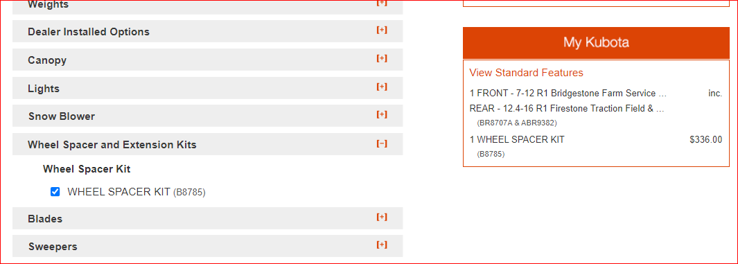

This is off Kubota's web site ........ now this is for a B series - B2650 ( did NOT show spacers for BX)
