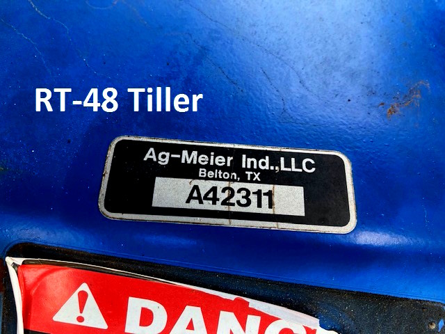

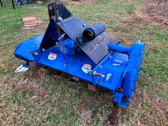

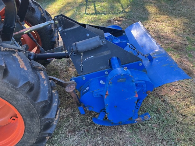

I have a four foot 'Ag-Meier' which is built almost identically to a King Kutter (pro model).
King Kutter 4' Pro Model:
My Tractor is only 20 PTO hp, but it will run the tiller just fine in dry, virgin sandy loam with native grass to penetrate.
This is video (recent) of a single pass with the tiller depth set to about 3.5"
