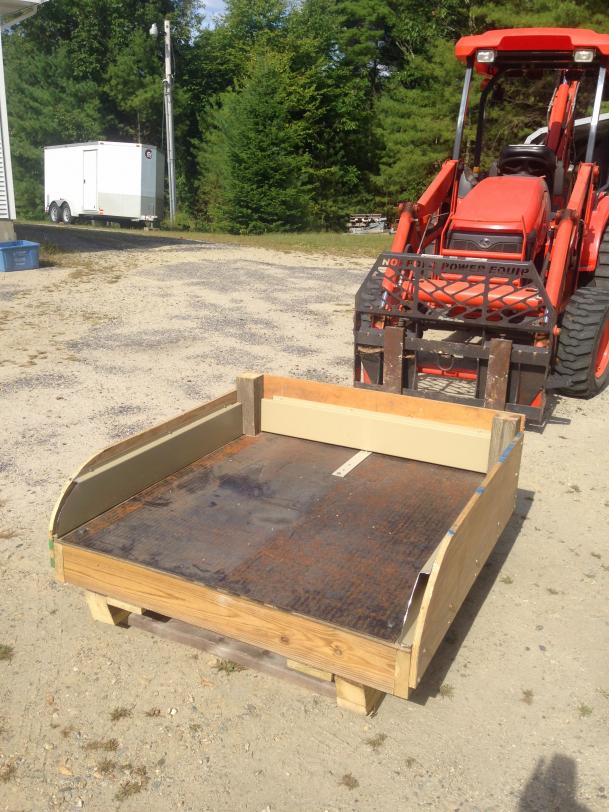

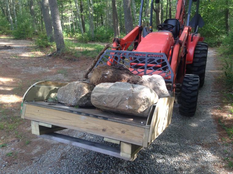

Made this "rock box" out of some scraps I had around the house. I made it because I had a lot of rocks on my property to pick up. The rocks are to heavy to lift by hand and to light to roll easily into the front loader. I pick the rocks up with the backhoe and place them in this rock box, then I dump them like you would with the front loader.

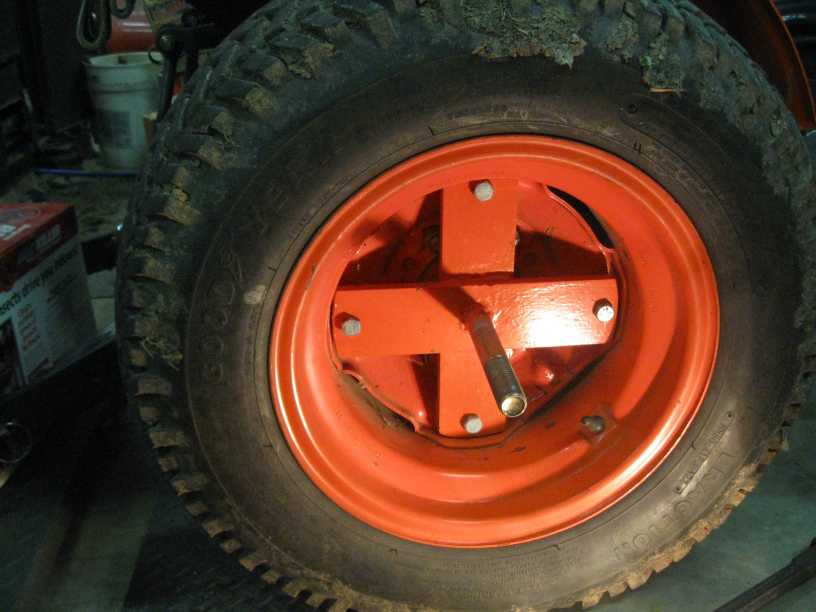

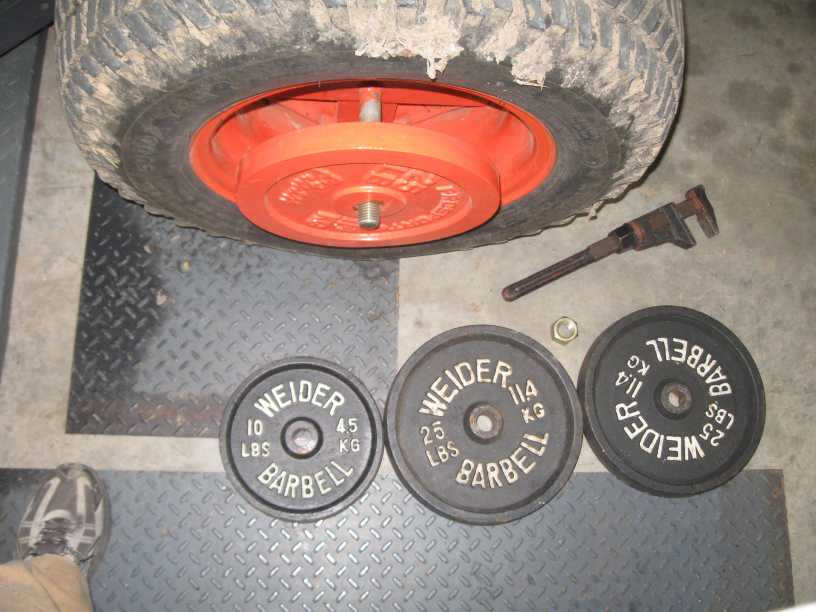

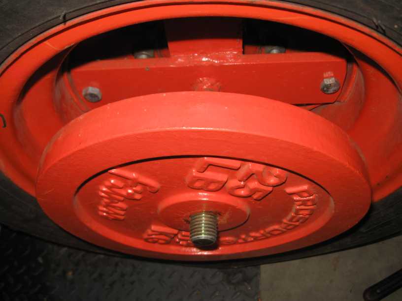

Wheel weights made from bar weights from scrap yard cost 22 cents a pound. 100 pounds per wheel.
View attachment 9816 ,
mike
How are the weights attached to the wheel? :confused: Could you post pictures of that?
Thanks in advance:)
Thanks in advance:)
Anders
volp,
check out post number 70 the pictures are posted there. let me know if you have any questions.
