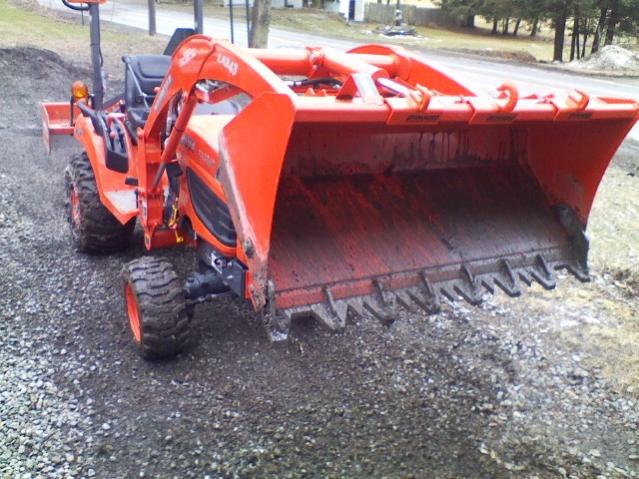

Made a snow blade from a B5000 dozer blade for my G1900. MAde the front receiver to mount on the tractor. Made a rear hitch and weight bar for it also.
Wrong color, built the entire front end loader from scrap on the little satoh. Also made forks, hay fork and a rear hitch/suitcase weight holder. Just sold the Satoh and bought a BX2230, so more fabbing coming soon

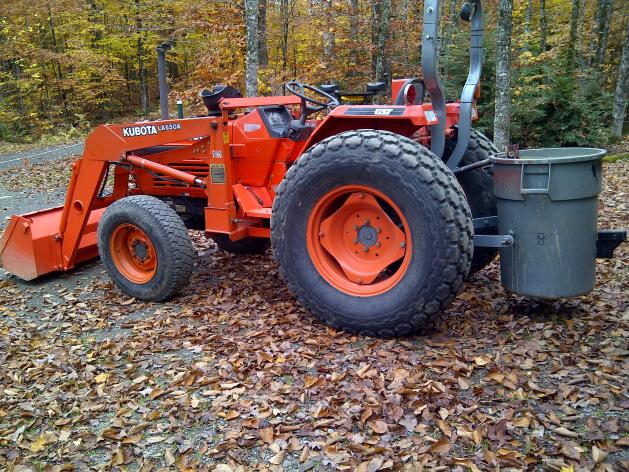

Made this last fall for skidding logs. Not pictured is the choker chain to keep the log low and close to the tractor.

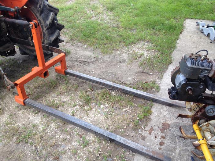

Centre pocket is for ball hitch. It works great for moving trailers around my storage building, easy to line up.
Forks fit pallets well,would guess moved 500 lb pieces no problem.

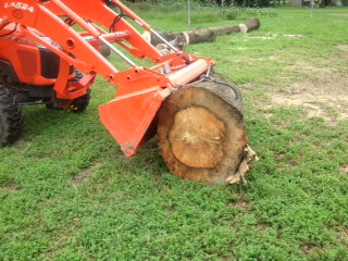

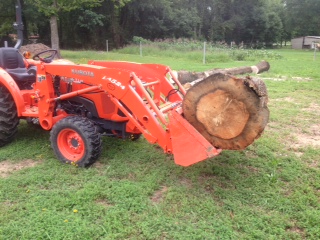

Welded two chain hooks to the bucket. Attached a chain hook to an old logging hook. I can stretch a chain between the two hooks on the bucket and hang the logging hook from the center. To move a large log I just position the bucket and tap the logging hook into the log and it will hold it enough to keep the log in the bucket. Works good when the log is too big to roll into the bucket.

BRILLIANT I love the loggin hook idea. Does the hook turn the log loose ok when you're dropping the log?
oldenough
Feb 26, 2014
Arkansas
Yes, the log will drop right off when you tilt the bucket down. You don't even have to get off the tractor to drop it. If you have a helper to set the hook you don't have to get off the tractor to load it either. Just be careful with a big log and don't raise it high enough to drop it into your lap.

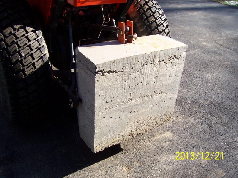

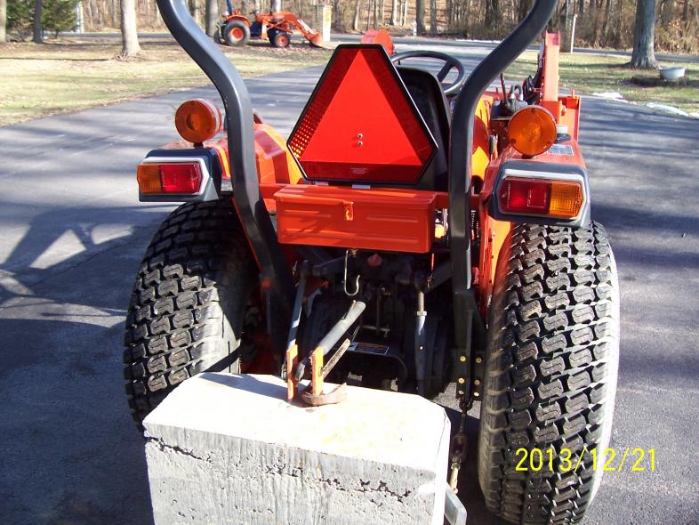

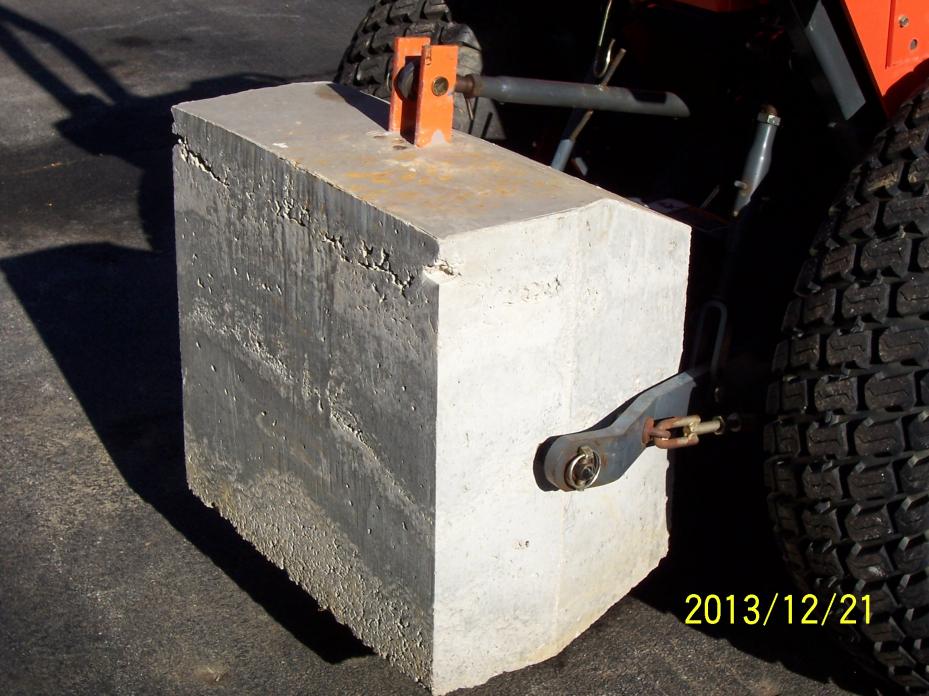

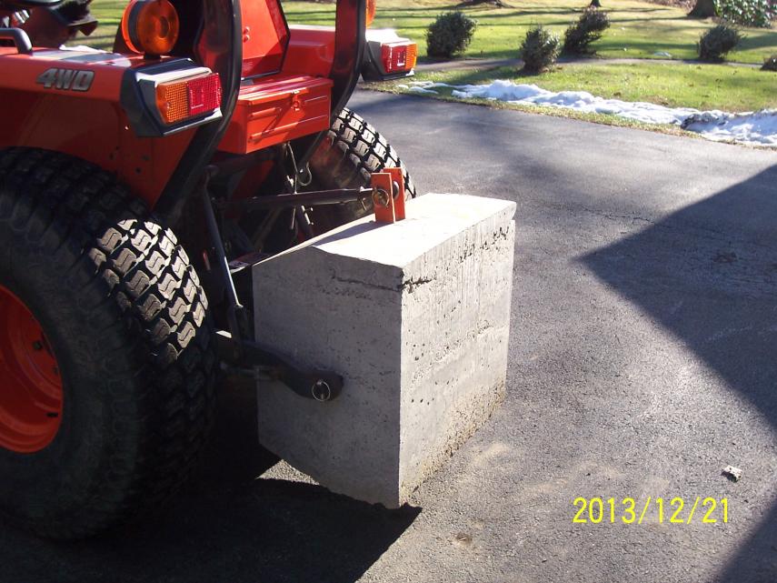

Made a heavier counterweight for the front,32"x6"x3". Should be an improvement, about four times the weight of the other one. Need it for snowblower and rear forks.
