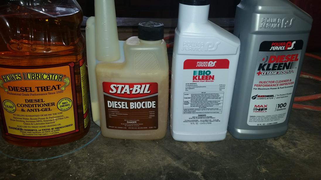

I am in Canada as well and I use Howes conditioner and have used it for years in all diesel equipment I have operated from trucks to generators.
Fuel conditioners are designed to stabilize fuel from separation, increase lubrication and remove water (typically results from condensation created by temperature differences between the fuel inside the tank and the outside environment) by emulsification using an alcohol or methanol (gas line antifreeze) which is part of the mix and makes the water flammable allowing it to pass through the combustion chamber without interfering with the firing cycle.
Pick one and use it... don't mix them!
Some additives don't react well with each other and can actually cause gelling in the fuel!
ATF is NOT designed to burn in a combustion chamber and WILL leave behind unwanted residuals, not to mention the added toxins to the exhaust!
I would not add it to my fuel!!!!
JMO

i have been a diesel mechanic for 34 years in iowa the best thing you can add to your fuel is power service it gets rid of any moisture lubes the injectors and upper cylinders also i put in restore add it to the oil it fills in the sctatches that is normal wear in your cylinders when you get these scratches you lose compression and lose power from your motor and yes i have rebuilt alot of truck motors that ran neather and these motors wore out quicker as much as 200,000 miles sooner i put power service in everytime i fuel and restore every 2nd oil change and yes here we get blended fuel 50-50 #1 and #2 diesel that we run in the trucks at work with out it well lets just say i have spent 15 hours in one day dejelling trucks some guys use red alart but i think it has to much alcohol in it

Power Service was #10 on the list, it did provide lubricity, just not much of it.

I had to spend over $600 last year, October for a complete fuel system cleaning of L 3800 with only 70 hours on it. Algae was determined to be the cause of tractor sputtering and shutting off during operation. (First season of owning)
With this said, can someone please advise on what they believe is the best additive to use. I keep a 5 gallon diesel container full for use after every time I've used by Kubota. I've placed a picture below on the different additives I've purchased and wanted the opinion of the OTT members. Dealer said that the climate here in Illinois last year...for some reason, caused the Algae to be extra tough on diesel fuel. Thanks.
