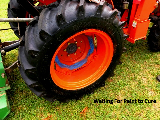

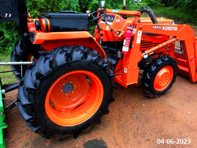

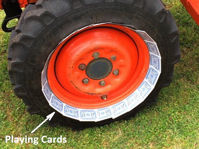

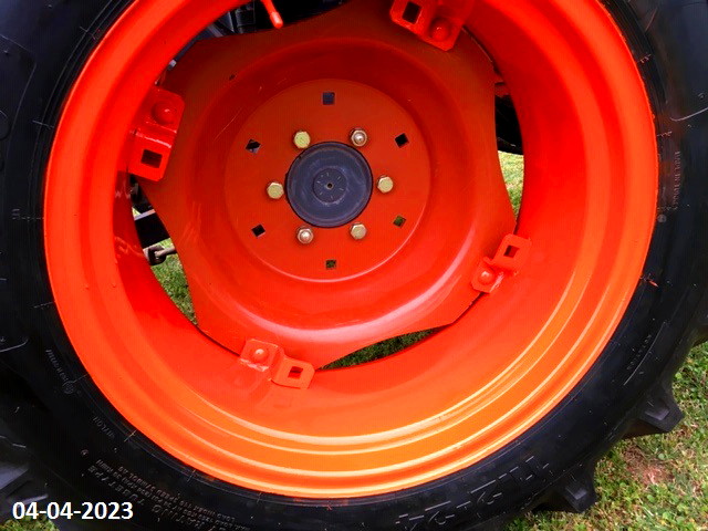

After 27 years my Tractor wheels were starting to look a little 'rough'.....so thought I'd just touch them up a bit. Not a proper 'repaint' where you'd dismount tires thoroughly clean the rims, prime and use a paint with hardener. But just an effort to make it look a little better and keep things from getting worse.
If your tires don't have a lot of 'bead sealer' or otherwise fit ultra-tight at the rim, you can use cheap Playing Cards to 'mask' off the tires...so you don't get a lot of over-spray on them.
Spray the paint and them let it cure for at least an hour.
Then remove the Playing Cards and discard. If done carefully....there should be little to no over spray on the tires.
Since the rear tires on mine consist of a rim that mounts to a center flange....I opted to mask off the center portion with tape rather than paint over everything like the fronts, but it was minimal preparation.
I will let the rears cure overnight and then pull the masking tape. The rear tires had some amount of bead sealer around the lip of the rim so I wasn't able to seat the cards as deeply as on the front. Got a 'little' over spray because of that....but I can live with it.
Finished....except to 'gray out' the center hub on the front wheels and replace lug nuts with new cadmium plated.
