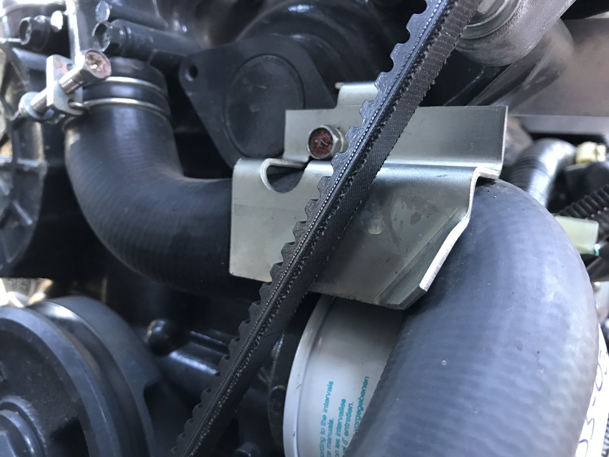

Decided to do my 50H service today. Started with the engine oil and filter. What I found is a 17 mm socket will not go on the oil pan drain plugs(paint?), but an 18mm socket is a bit loose. Well, it's a drain plug, so it shouldn't take much to back out the drain plug. I was right. Drained the oil. While draining, I start studying the oil filter and running all the complaints about how hard it was to get the OE filter off. First of all, just getting a strap wrench on it on the LX2610SU is a total PITA. UNLESS, you remove one little bracket that is actually a guard for the lower radiator hose. THIS:
While protecting that hose from the fan belt is a wonderful idea, perhaps rounding the edges of that piece is a much better idea. That thing is sharp as a razor on the edges. And it's there to protect rubber. Am I missing something? Ennyhoo, yanked the bracket off so I could lift the bottom rad hose, got the filter installed, put the bracket back on, oil in, fired up and checked oil pressure. Recorded the service thusly:

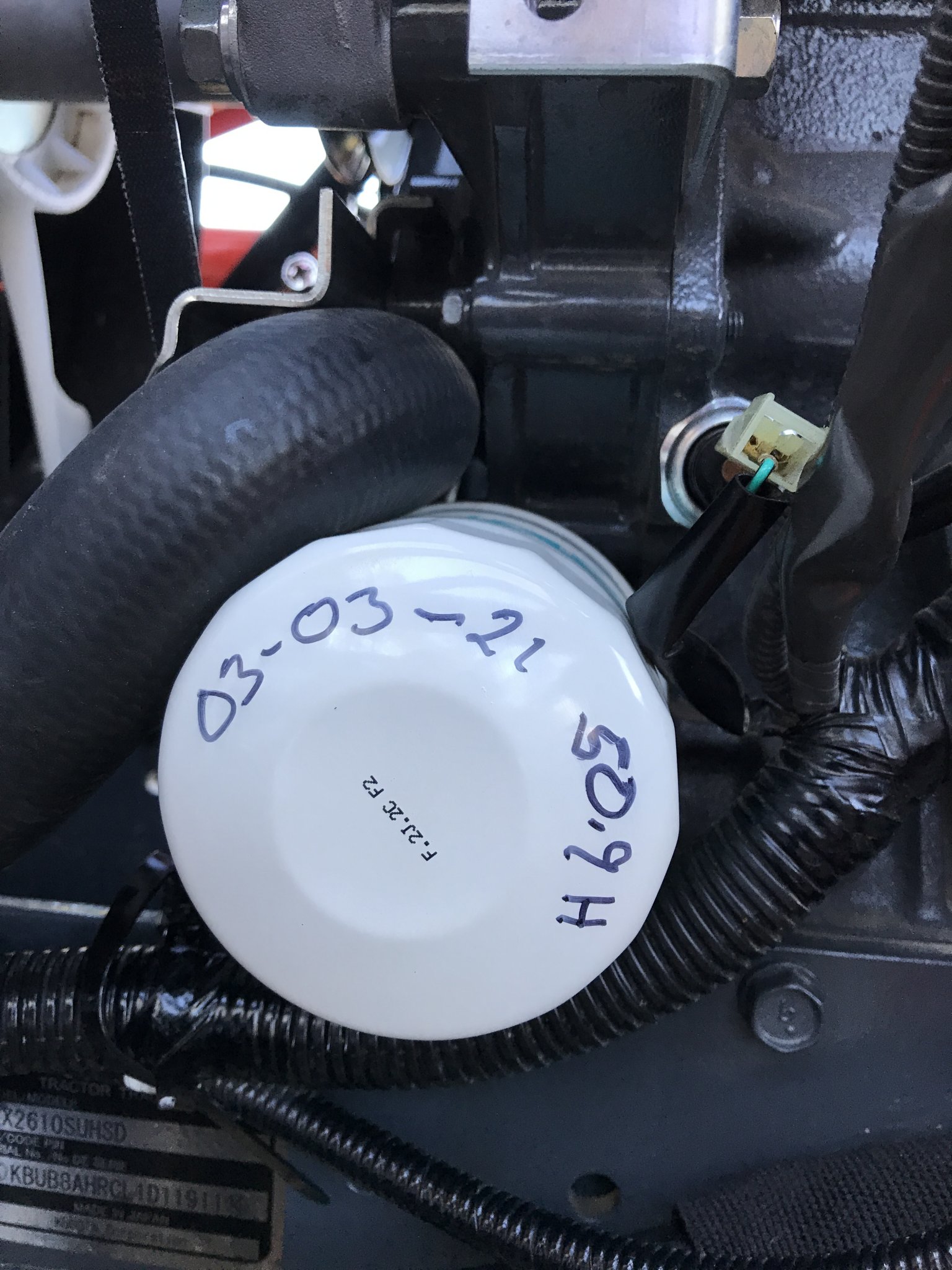

Please excuse my chicken scratch. The filter was wiggling like the Sharpie was tickling it, I swear.

great humor in your report on the 50 hour service, some people just get upset and have no humor. I was surprised how tight that oil filter was with surrounding items. I can tell you if you buy bigger tractors you don’t have that issue.
