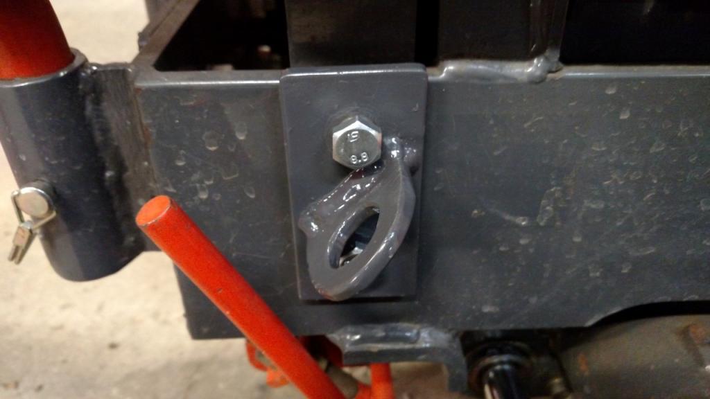

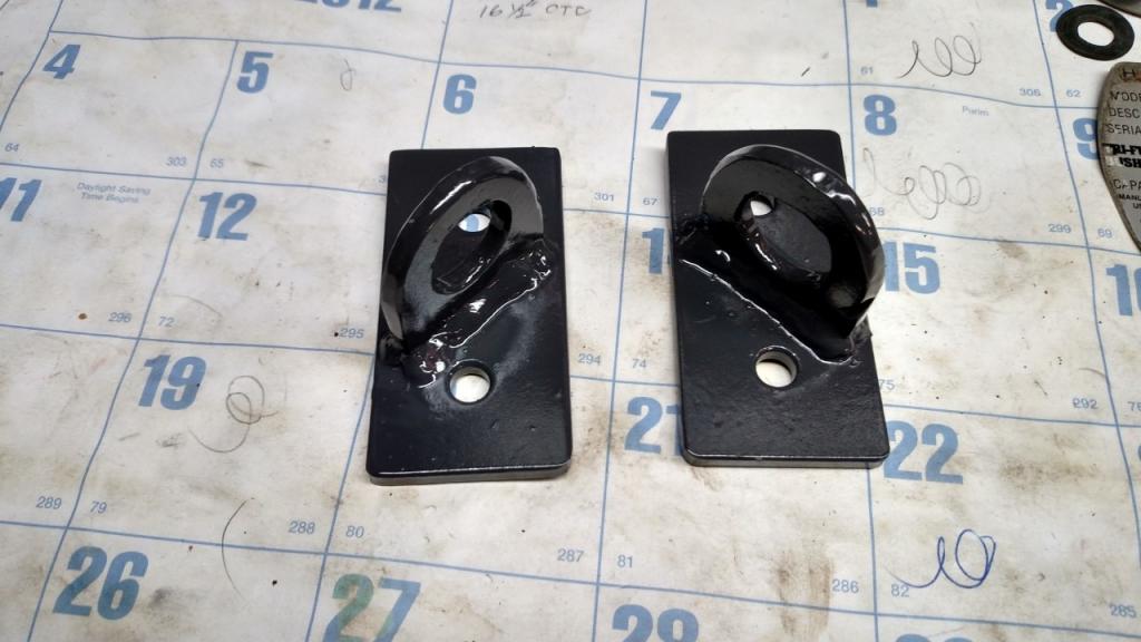

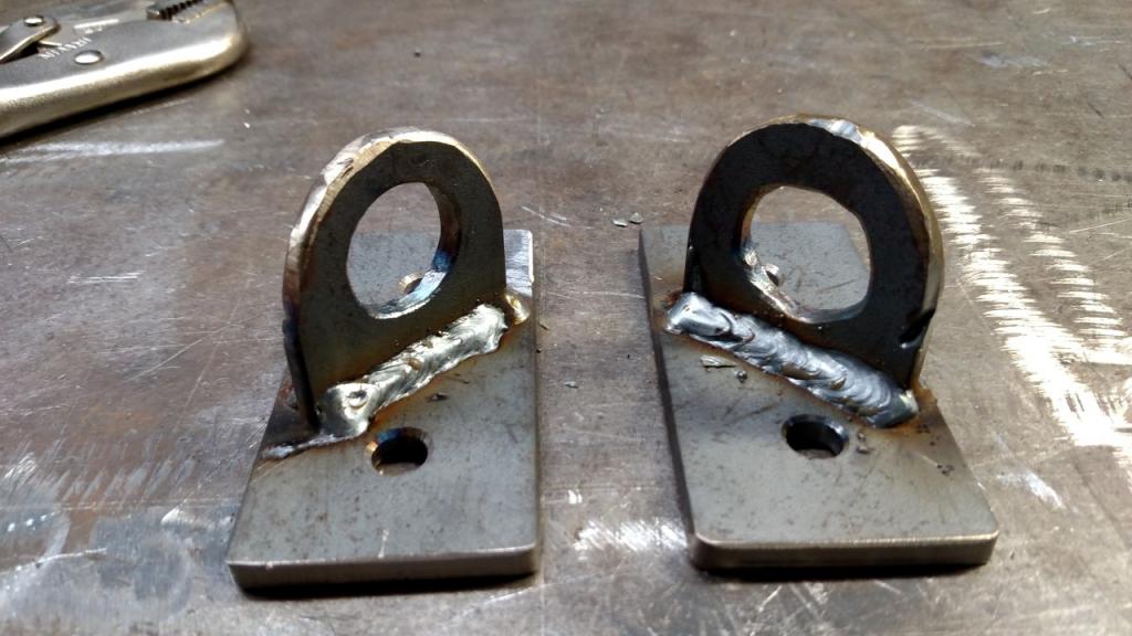

I made a couple of tie downs to bolt to the front of the frame on my BX. The girlfriend wants me to take it to her property in the UP of Michigan to do some work moving some piles of stone and pulling some old farm equipment and vehicles out of a thicket so a neighbor can cut them up and take them to a scrap yard. It's a 600 mile trip one way, and I want to have the BX properly secured.
I was looking at the rear of the frame and have an idea for a tie down on the rear of the frame too. Should be easy to fab out of some 1/4" plate with a bend, using existing bolt holes with 5mm longer bolts.
These only took a little over an hour to cut, drill, and weld up. I bead blasted them, primed them and painted them Kubota dark gray.

Why not tie down the rear at the hitch? The tractor is small enough that 3 points are more then enough to hold it in place.

I thought about that, but just decided to add the tie downs up higher and easier to get to than the hitch with the 3PH in the way.

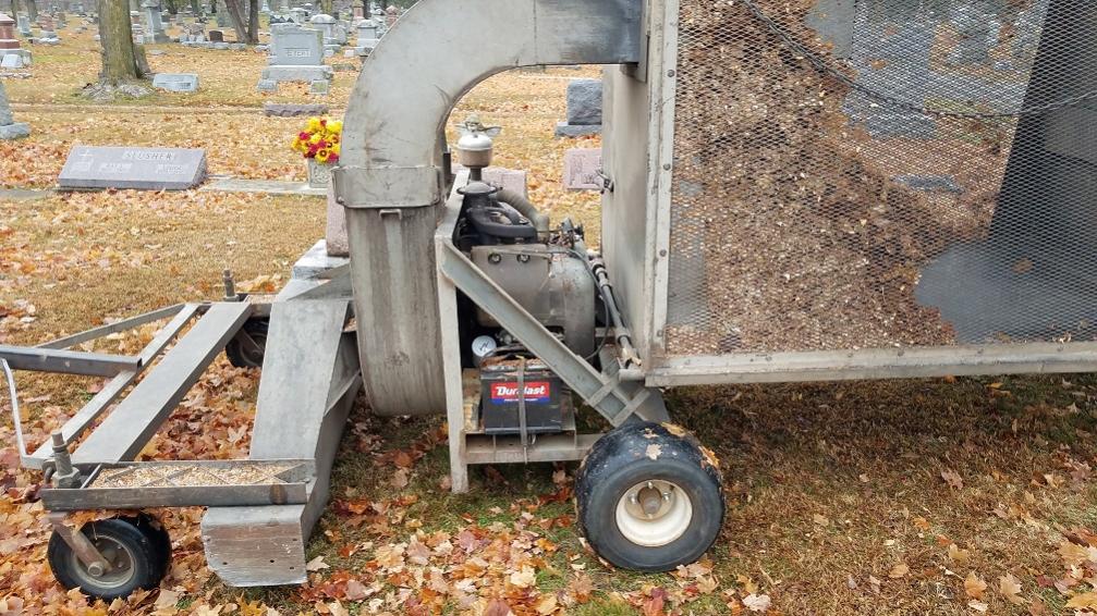

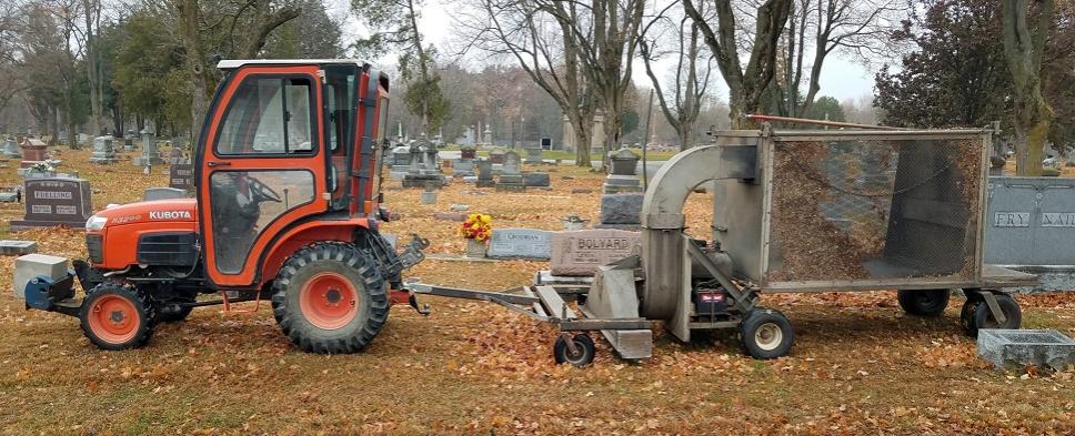

Been playing in the leaves today. I have recently seen some threads about leaf equipment. Thought I would show you what we have been using for the past 50 years.
It is a Giant Vac, built for a local golf course in 1967. They didn't like it, so it went back to the local equipment dealer that sold it. After renting it for 2 years, the dealer made us a deal to get it off their lot.
It has a Wisconsin VH4D engine, 6 foot wide snout, and a collection box that is 4 foot x 4 foot x 6 foot. It does a very good job of getting the bulk of the leaves off the ground, then we go through with leaf blowers pulled behind our ZD326 mowers to cleanup between the stones.
Not sure what we will do if and when the Wisconsin gives up.
Digger

You call someone like me that has a Wisconsin VH4D engine that is in excellent running condition, and it's sitting around doing nothing. ;)
Thank you Wolfman, that's good news. I'll keep that in mind. Since we started buying diesel powered equipment, I've been trying to figure out which Kubota engine to put in there to replace that Wisconsin.
Digger

Yep you could do that too, I was going to say that.
A real good engine for that task would be a V2203, they are very common and super easy to work with.
The only real issue is setting up a radiator to cool it.
