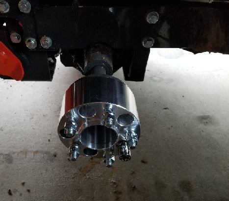

I almost rolled my BX the first night I was using it to back fill a retaining wall I built behind my swimming pool. I hit soft spot of ground and the front right wheel sank in and the BX flipped up sideways. Somehow it came back down and I just made sure to stay away from that spot the rest of the backfill. So, I immediately ordered the spacers just to be on the safe side. I have used it a lot since adding the 3" wheels spacers. And it definitely makes it seem more stabile. But, I also try to be extra careful now, since the first night's pucker factor...LOL

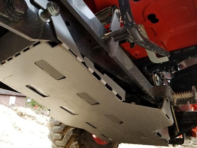

Yeah, I have had a few bad pucker moments and its funny but the worst I had was at the top of my driveway which isn't that hilly, I was prepping it for a delivery of crusher and I was removing a high spot and I had the same thing happen, I hit a soft spot with a front wheel and it started to go over but the loader was low enough that it stopped me. On a side note I'm not sure if you have yet purchased the under body armor but it is legit necessary, I ran my BX over a year with the factory skid plate with no issue even though every one on this site warned me and one day in the woods I had it happen, a stick went past the factory skid plate and right into my HST fan and sheared all of the fins off, service info says you need to split the tractor to replace it and I was fortunate enough to only have to unbolt the motor off the mounts and slide it a few inches forward to make enough room but it was still a decent amount of work, I did not buy the BXpanded armor afterwards because I looked at it and welded up my own similar skid plate and have had no issue (knock on wood) so far but without any aftermarket armor/skid plates you are begging for problems.

Already put the Bxpanded skid plate on mine..
