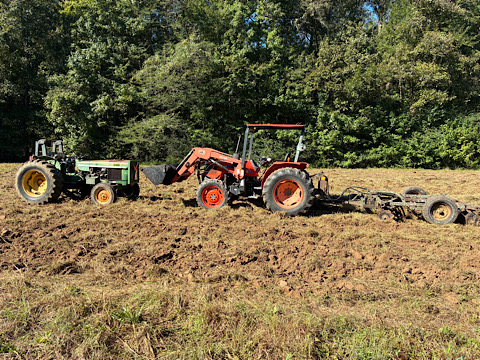

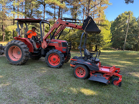

Five food plots needed a bit of 'tractoring' today.
My Son was on the old 1974 John Deere 1530 subsoiling and I was following with the Kubota M4900 disking. All went well but on the last plot da John Deere...

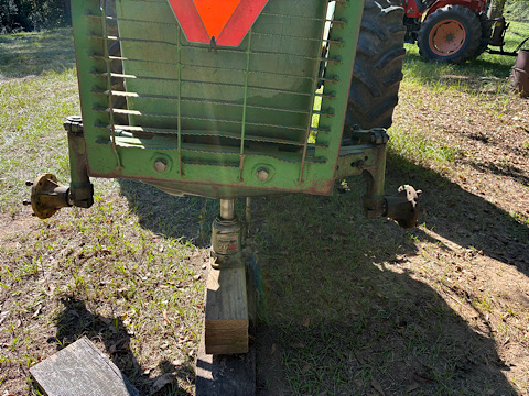

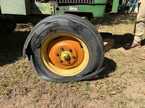

Broke a leg. I reckon that a 30+ year old tire has to give up the ghost sometime, sooo
Jacked her up, removed the wheels, and she will get two new tires next week.
We finished da day with a ZT that made a bad noise in the engine and then would not crank over. It might get jacked up and drive something new under it this next week.
Sometime tractoring can be sorta expensive.

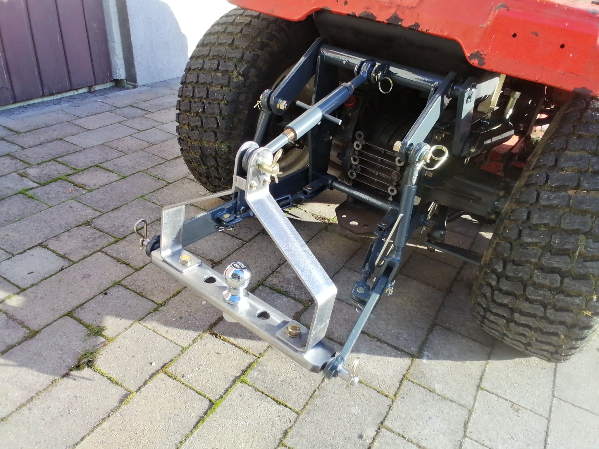

Attachment and three point hitch geometry matter. Only when lower arms and upper linkage are the same length and parallel the load stays at the same angle.
Was just looking at that making a tow bar ball attachment for my three point hitch. Modified a Cat.1 draw bar to Cat.0 and added arms for upper linkage. Limiter for negative load on the ball is still missing and painting of course :)
