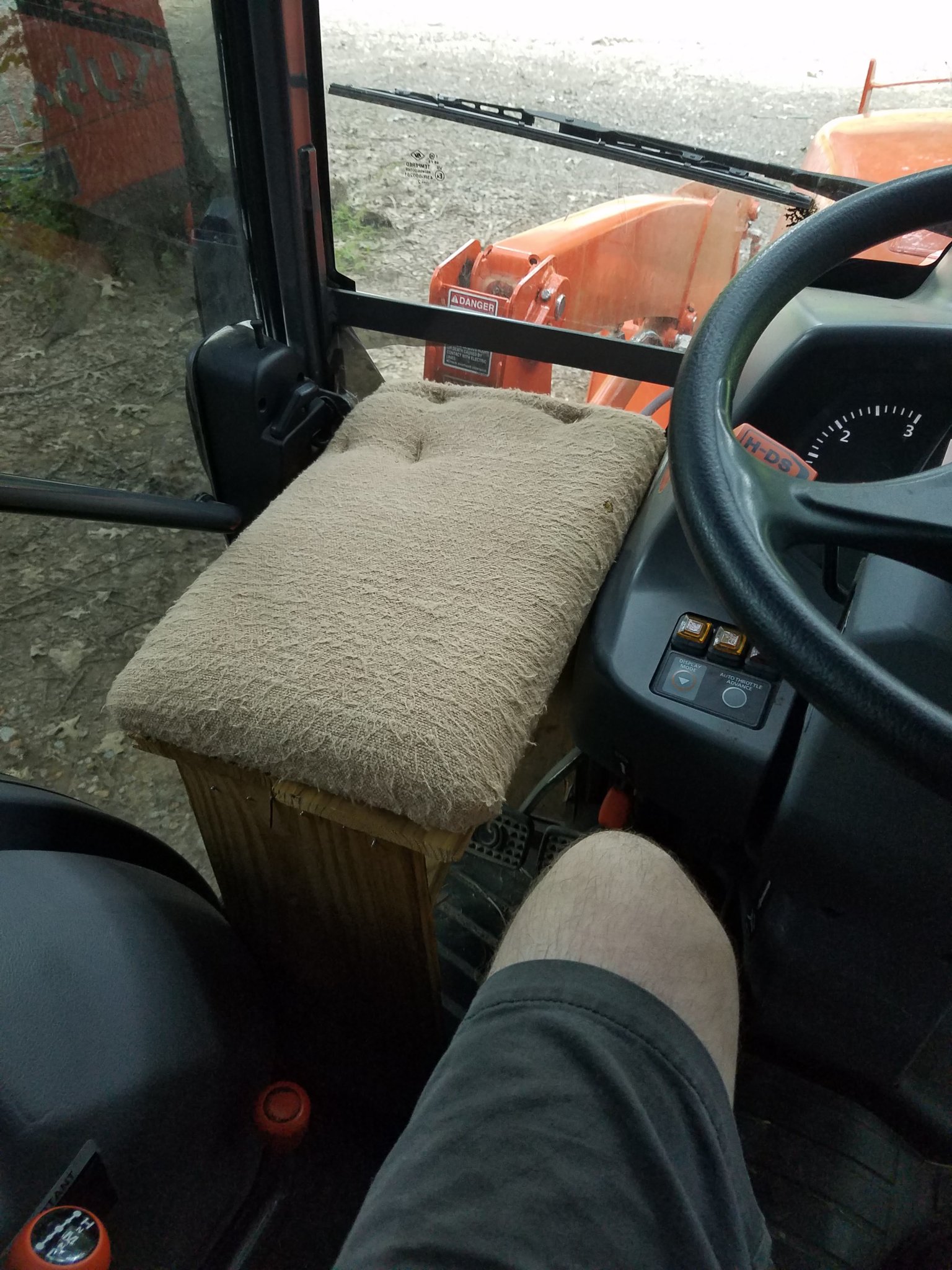

Can you post a picture of the stool? Wife probably won't want to be in there with me but the grandkids will.
This is version 2. Made it in about 3 minutes with a miluwaukee finish nailer lol. Don't judge me.
Version 1 was metal, half the size of version 2, but would bang up against the quarter glass. Sometimes rather hard when things got bumpy.
This one's ugly as sin, but it sits!

Function over looks. I may do the same.

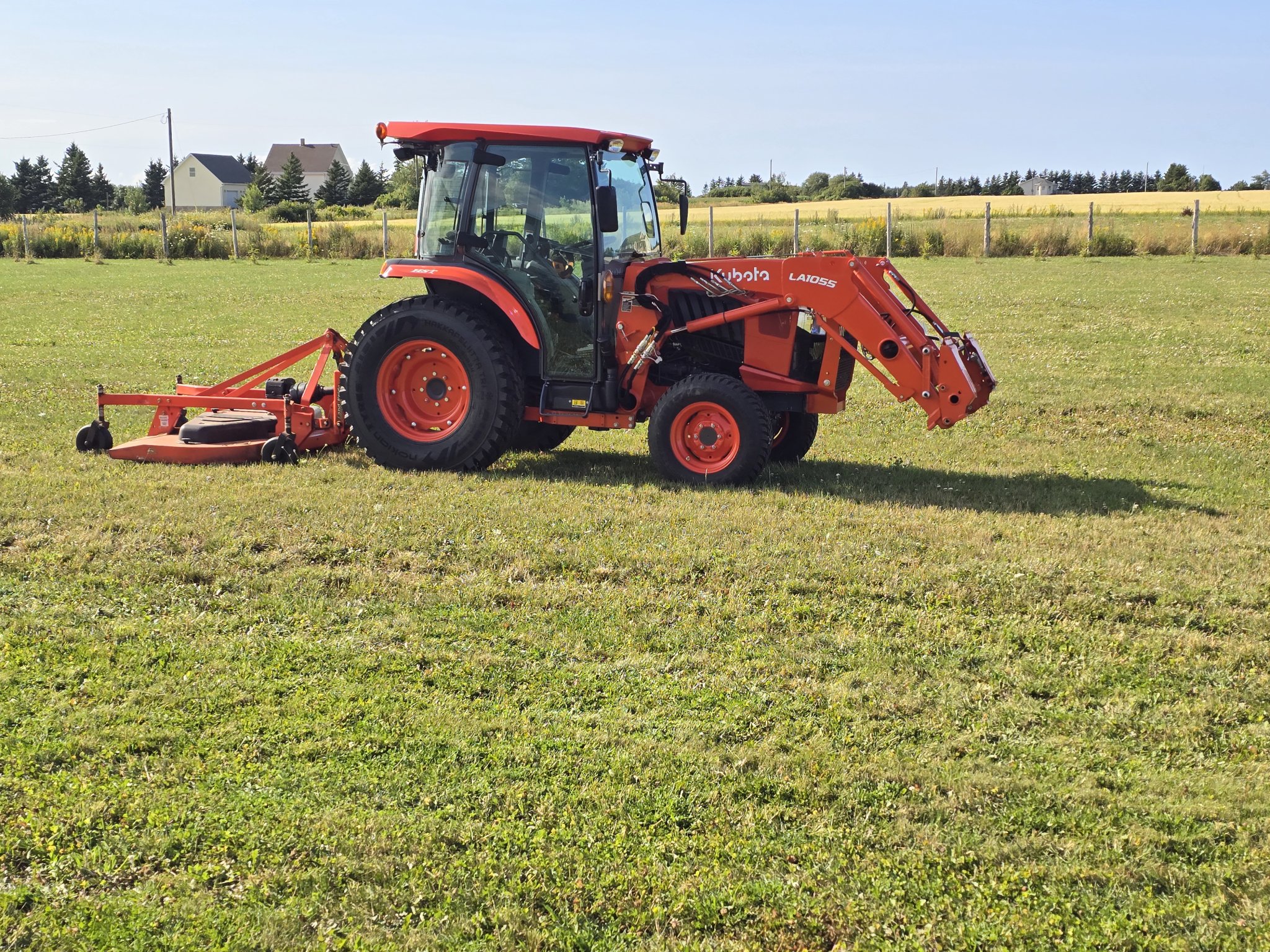

Yea she is....
That cruise control was a game changer for me.
Did your other one have cruise control? My 3301 did not.
The LX3310 had cruise control but I didn't use it. It made the hst whine worse so it wasn't worth it.
Haven't tried the cruise control on the L yet. The transmission is a dream though. I could feather the hst in the LX3310 but it was still Jerky. The hst is silky smooth in the L.

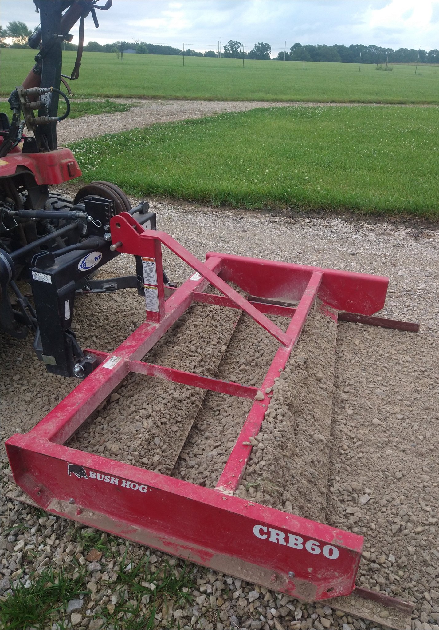

Plus room to hook a quick hitch to ... Just to "future proof" it ... This is a how mine hook on ...

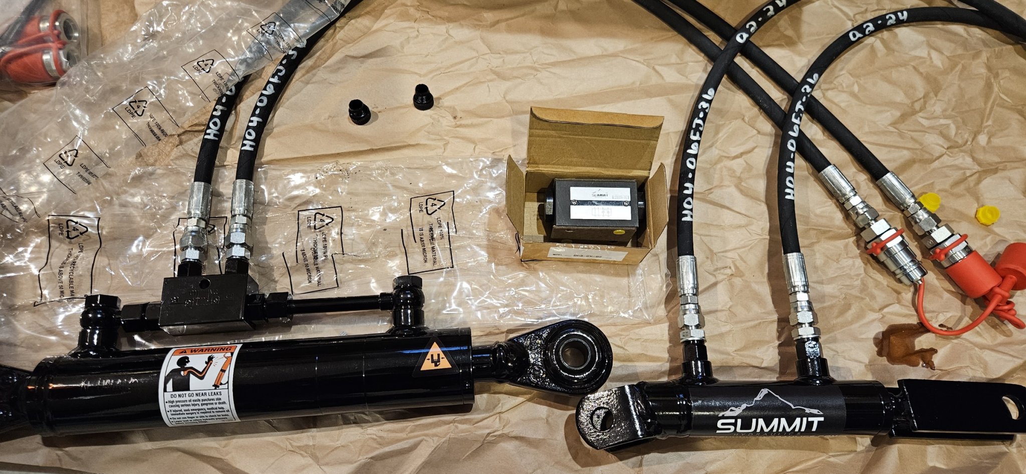

After waiting over a year for Summit to ship an "in stock" BX Top & Tilt Kit paid for up-front I rolled up to my desk Wednesday to cancel the order and fab my own suff--I don't know much about hydraulics but am sure I could git 'er done within three months of trial by fire (given the BX lives a few hours away). And...sure as Frank Lloyd Wright knows something about art, it showed up.
I don't know what tractor gods I pissed off, but the quick-connects are far to big to fit 1/4" "Kubota Factory Rear Remotes" which is one of the things thoroughly covered when ordering; everything working out of the box is why I went with a kit, from a reliable vendor, three months before I needed it. Add to that they did ship a Double Pilot Operated Check Valve for the side link, which is great since I paid for one, however it's a stacking component for a Summit Rear Remote and won't work with "Kubota Factory Rear Remotes"--can't win on that one.
Also, if anyone is wondering, China must be proud of their stuff because every single part is stamped with either a Chinese emblem or "MADE IN CHINA" in all caps. Well, at least the welding looks good, and I can't complain about paint coverage because they hit everything heavy, even inside the hydraulic ports; hopefully the fittings seal well and the paint doesn't break down when the system is full of fluid and contaminate the hydraulic system.
Waiting for Summit to email back on the issues....at least it's one step closer to install.

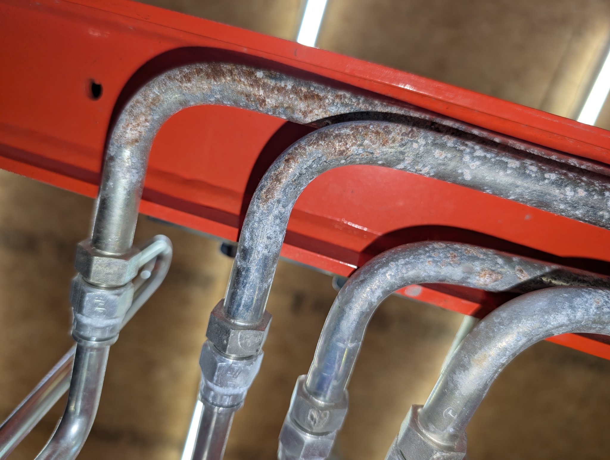

I was cleaning the tractor a bit this morning and noticed this.
The hard lines going to the loader are starting to rust. I'm pretty concerned about this. Would it be ok to take a stainless brush and clean it off and spray with protectant?

Use Fluid Film, it won't hurt the paint on anything else. In the future, look over everything and spray Fluid Film at any sign of corrosion.

Looks like mouse piss. Literally. Mice pee always as they crawl around and it sticks to the horizontal parts. Hit it with a disenfectant like OdoBan our Lysol and see if it comes off. JUST Spray it, wait a couple minutes and try to wipe it off. AND Wear gloves.
If it comes off, it is probably just rodent piss.
If it doesn't come off, it may be rust or otherwise.

Looks good in the picture. Would look a lot better installed. Once you get the bugs worked out and have it all functional, strongly suspect it will be worth all the effort and waiting. Still has to be disappointing to order a turnkey kit that doesn’t fit out of the box.
I waited close to a year on mine. Ordered about 2 days before COVID shutdowns, so at least there was a reason for that delay.
