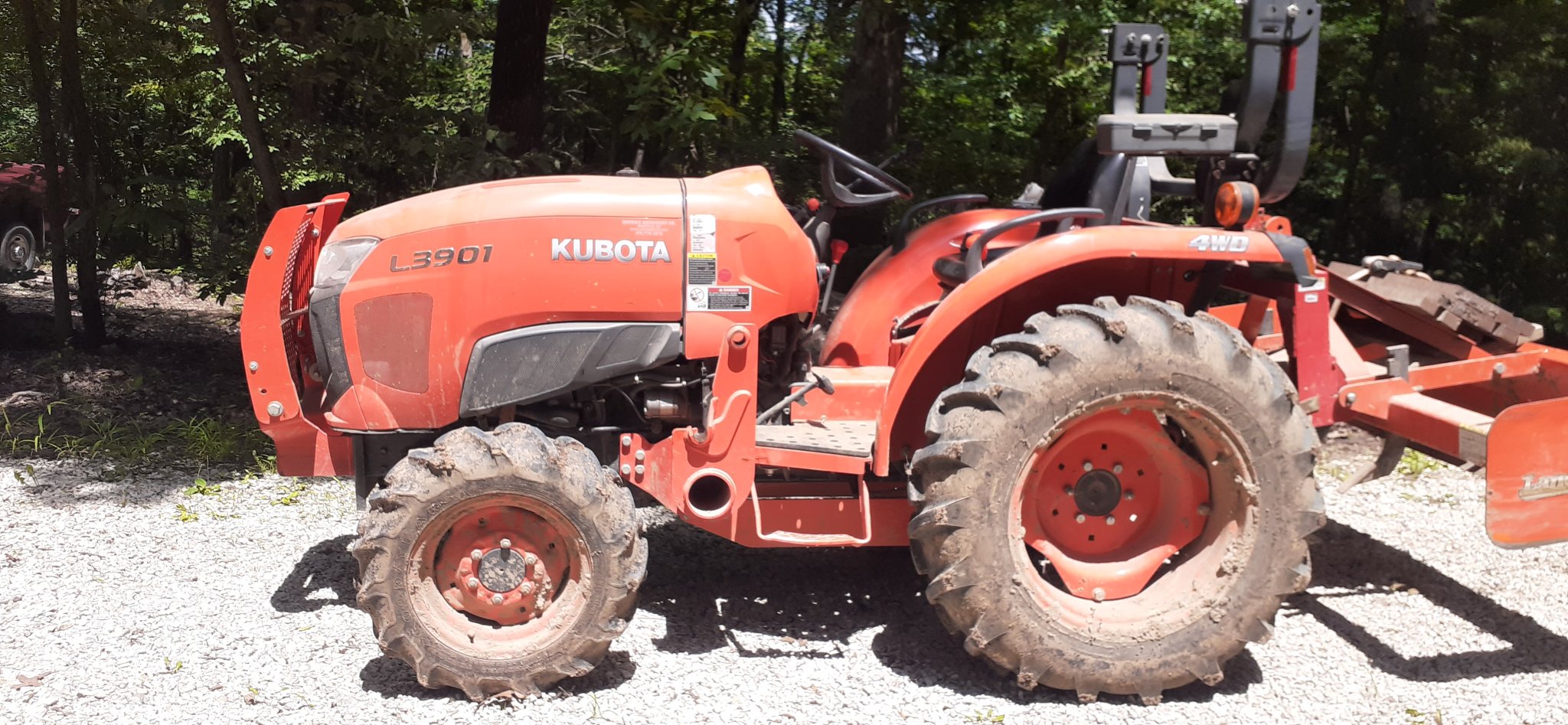

I changed the oil in the L3901DT today. The tractor has 628.5 hours on it now. I took the FEL off to make it easier to do the oil change. I also greased the tractor and FEL.
It was in the upper 70's when I took the FEL and in the mid 90's when I put it back on. I had to release some pressure from the line on FEL to get the lines connected back up. That will teach me no to take the FEL off where it will be sitting in the sun.
I think the tractor looks so much different without the loader on. It also needs a bath really bad.

How do you release the pressure on the loader when it's not hooked up?

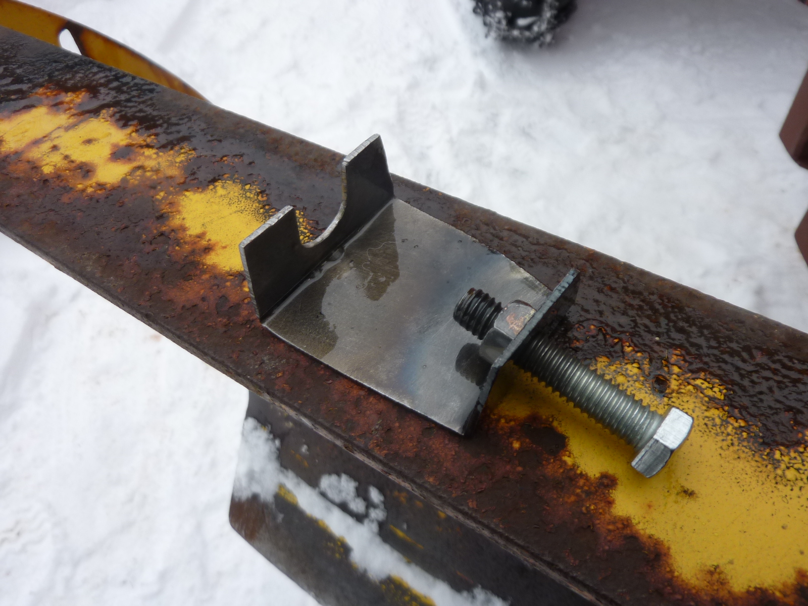

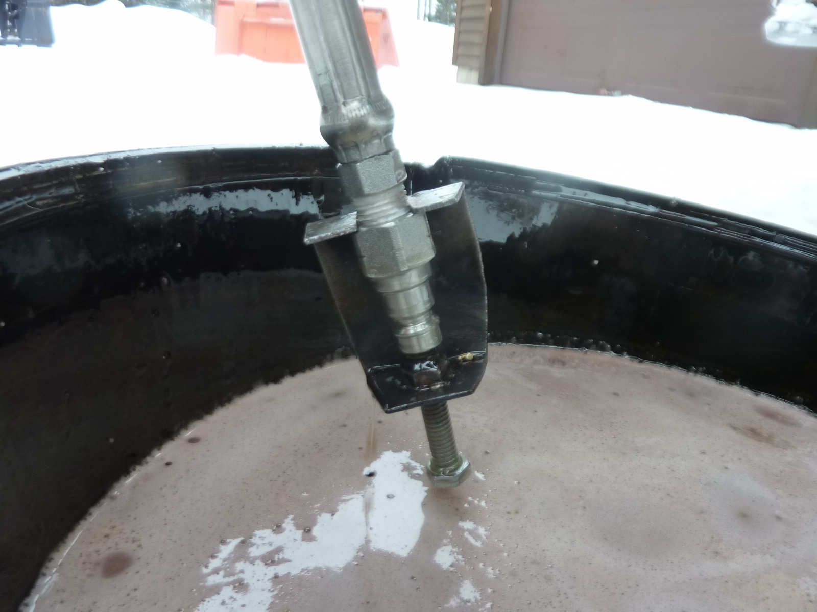

What I do is get a hard wood dowel about 3" long that fits loosely down into the female coupling on the loader hose. Grab the hose coupling with my left hand and smack the dowel with hammer to push down the poppet that the other end of the dowel is sitting on inside the connector. Oil will be released so draping a rag over the end of the dowel and held around the hose with your left hand is a good idea. May not be acceptable to some but works for me. You can also make or buy a tool to do this or remove the coupling with a pair of wrenches.
I made this tool to rinse old oil from a snow plow cylinder, It is a male coupler but shows the idea.

I just loosened one of the hard lines, this will let the pressure off. As g_man showed, you can make a device or you can buy one.
Well it's good to know that if I ever take the loader off to not leave it in the hot sun haha. Wonder if it would be safe to take it off in the garage?

I frequently have that happen with mine. It's stored in a shed. Not a big deal. If the connectors won't go together I use a small piece of hardwood and tap it in the female end of the fitting. I DO hold a few layers of old bath towel over the fitting/wood before striking it with whatever is handy - pliers, small hammer, etc. When the pressure is relieved it produces a brief powerful squirt. Often a second smack is needed to fully relieve the pressure.

Just be extremely careful if you relieve the pressure on the curl lines. That could cause the loader to shift and fall. I learned that the hard way and had to stand the loader back up by hand Once you disconnect it from the tractor, the boom cylinders should equalize. Turn off the tractor and push the stick to float. That dumps both ends of the boom cylinder circuit to tank. The curl cylinders may have a load on them because they are used to tilt the boom when removing or reinstalling the loader. The bucket is magically sized to counter balance the boom on the storage legs. Don’t attempt to remove the loader without the bucket on. I made that stupid mistake exactly ONCE. It’s hard to stand that boom back up and get something under the tractor end by yourself. I recommend leaving the loader on the tractor for any curl cylinder maintenance. Then you can easily relieve the pressure with no mess. I’ve never had an issue reconnecting the hoses on the loader. 3rd function is a different story but not that difficult to remedy.

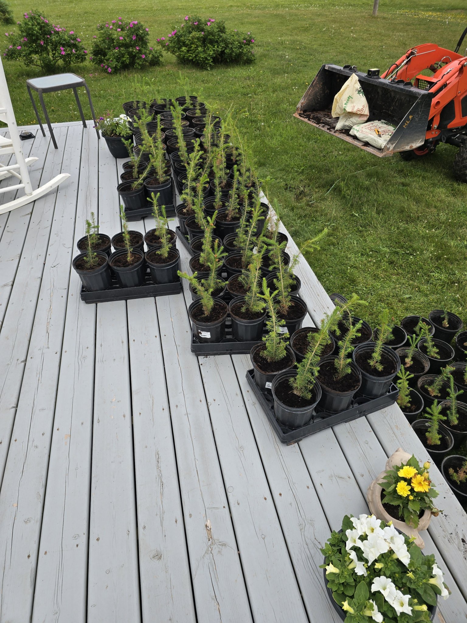

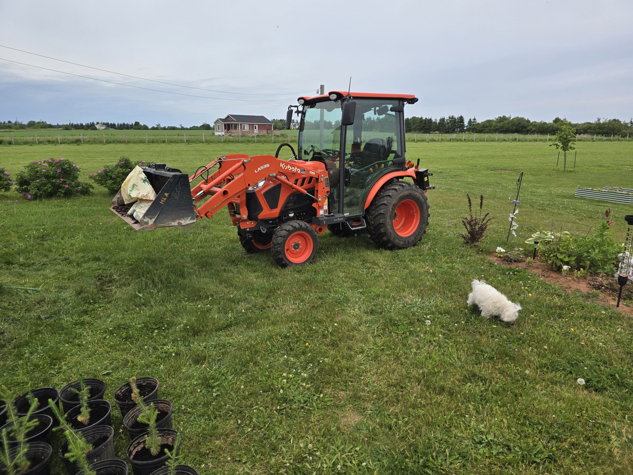

The LX was on sheep s##t duty. I had two trays of seedlings to transplant so my wife and I went to work. Had about 155 survivors.

It may still have a pressure difference parked in the garage. Like others said above, easy to release the build-up.

Looks like there was a big ball of wool mixed in with the sheep $hit! Hopefully you caught it before it blew over to the neighbor's property like a tumbleweed! 😂
