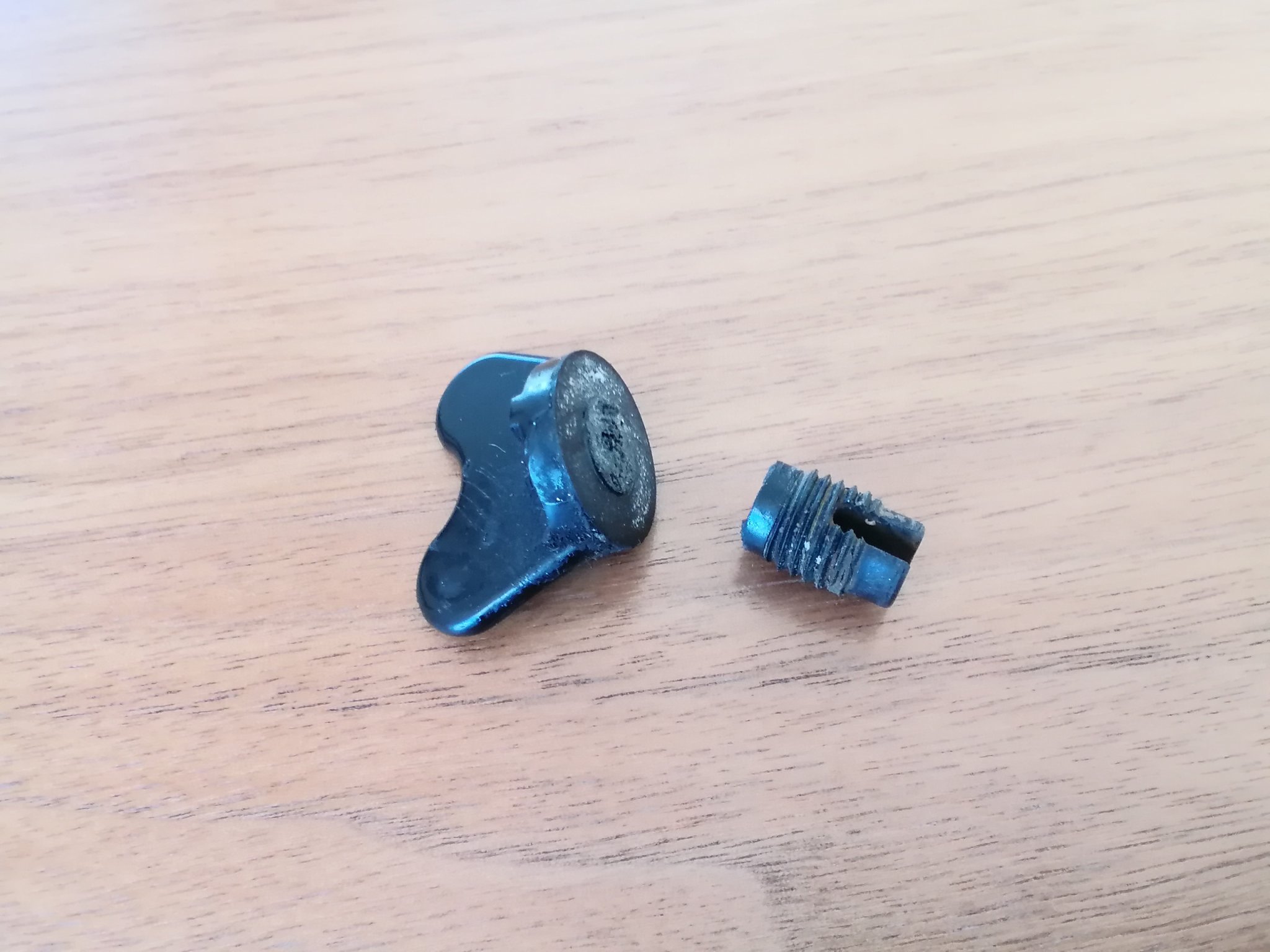

Drama free coolant flush and fill on the tractor. I used a fat washer and pliers to turn out the radiator drain plug. Pretty dumb idea for a drain plug. I can see many folks snapping them off. 👎

Mine snapped off too when I barely touched it. Made a replacement from brass instead of buying another plastic plug from Kubota.

My Hanix mini ex used exactly the same radiator drain that broke in exactly the same way.
Wish I had thought to make a brass replacement before I put another plastic one in. DOH!

You can still do that before the plastic plug breaks. May still save you time. I had to take the radiator out to get the broken off piece out.

Mine is a little different style.. a thick flat washer stuck into the slot and turned with a pair of pliers did the trick...no breaky lol

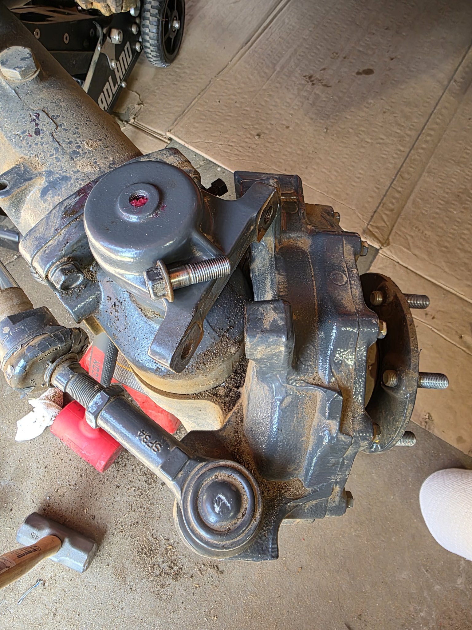

greased the front end wrong and it snapped a bolt. cost me two new bolts from kubota. idiot tax was only a half day down time and 16$.
