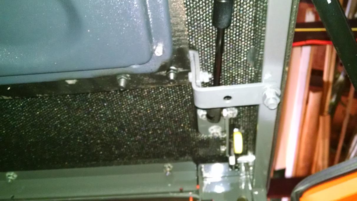

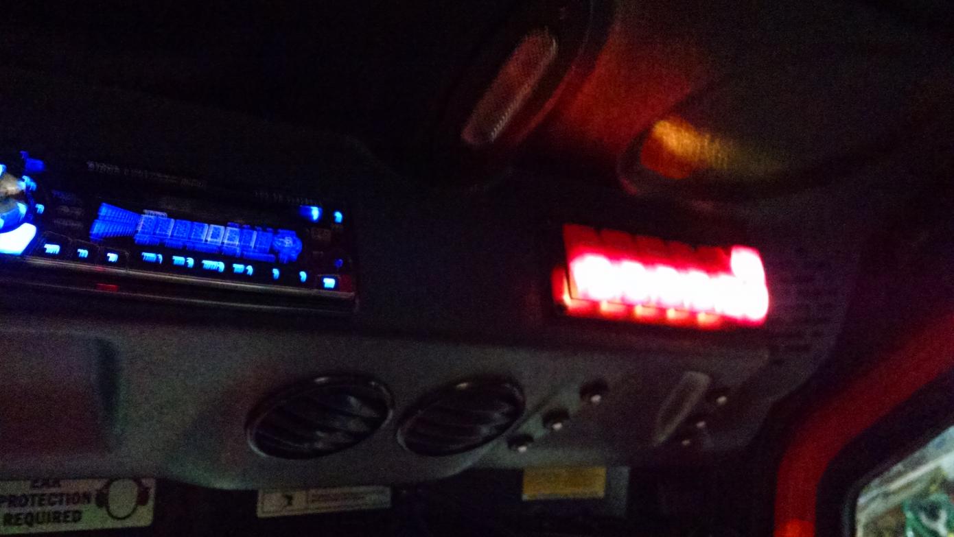

Console install completed! I didnt want to mount it to the roof as others did - I wanted it as close to the windshield as I could get it. So I used a board coated in Rubber (almost went with a metal sheet - but decided on wood to make it more light weight). Made brackets to be able to open and close the roof and open and close the doors without moving the overhead console
Radio with antenna
Cab Light
Switches to:
Front LED lights
Rear LED lights
Wiper
Heater hi and low
Window Fan
Console lights on and off
Lets see how well the console and switches hold up over time.

and....... since I had the front off to wire up the console, wired in the chute actuator to control up and down and put in a joystick switch for it.
So now I have left and right Hydraulic rotation and up and down electric.

There have been a couple of threads about the shaft seal leaking on linear actuators. The actuator either fills up with water and freezes or fails. Maybe your rubber seal in the picture will be better, but I followed the suggested resolution and installed mine with the motor up and the shaft down.
