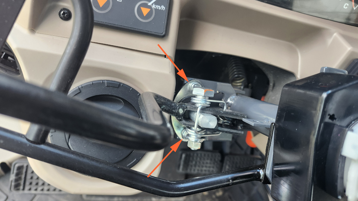

Yesterday while using the M6060 I noticed that the hydraulic shuttle lever felt a little "off". Upon closer inspection I noticed that the two bolts indicated by the arrows in the photo below were very loose. This morning I removed them, cleaned the threads, applied blue Loctite, reinstalled them and tightened them. The shuttle lever feels a whole lot better now.
I had to remove the plastic clam shell trim pieces from the steering column to get to the bolts but it was easy enough.

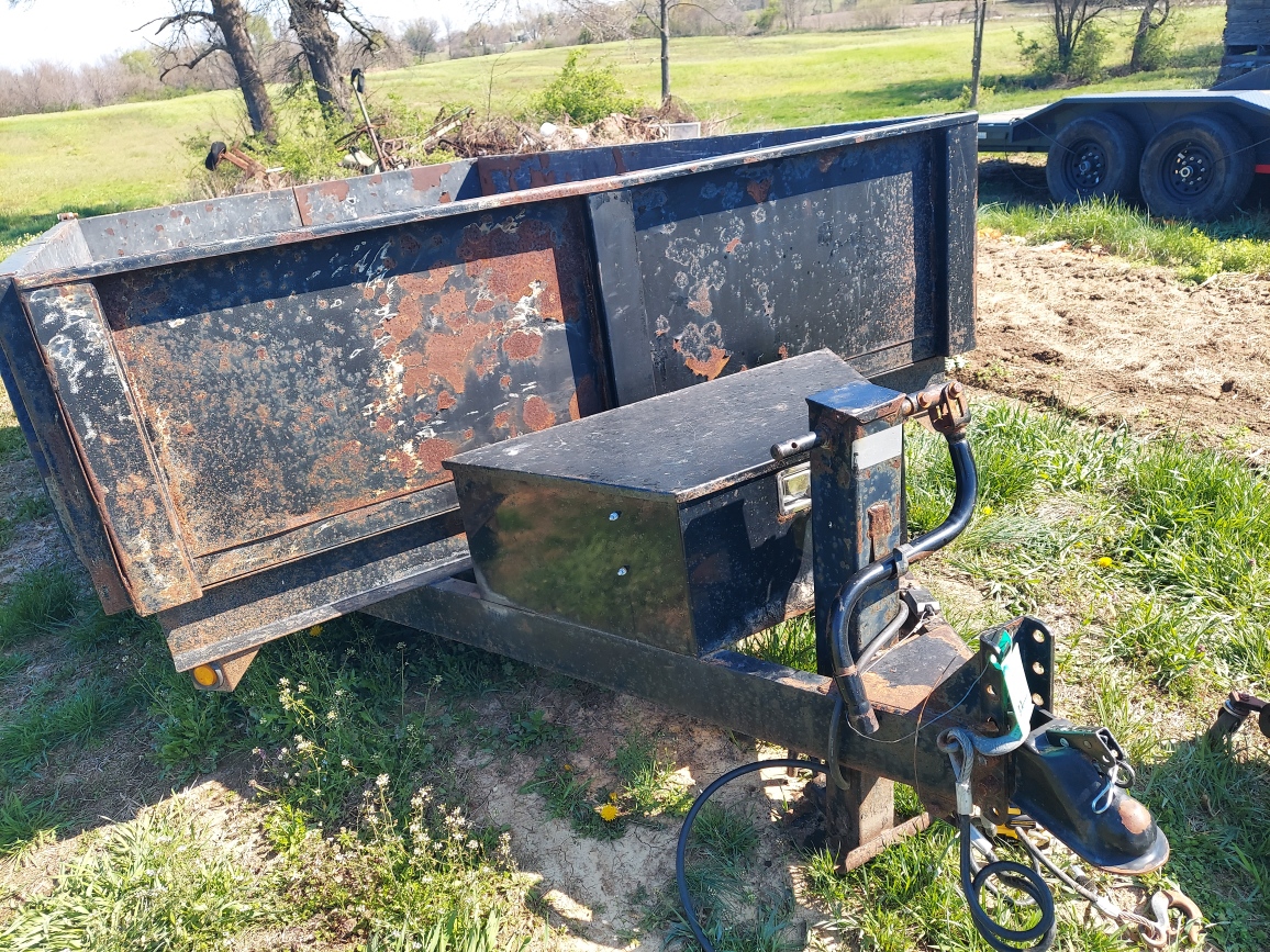

Then turned the attention towards the recently acquired dump trailer. We are by no means automotive restore experts. Realistically, we are just putting some makeup on a pig and trying to slow down any rusting.
Here is a picture of the front of the dump trailer before the work.

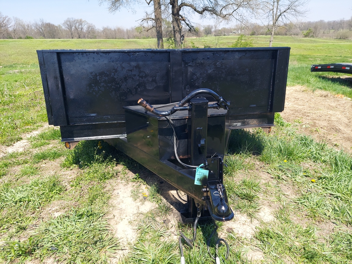

Here is a picture after we had finished most of the front (ended up breaking out another can and finishing the front before we left, just couldn't leave it not complete).
We went over and knocked off a bunch of the flacking paint and rust. Painted it with a Rust-oleum primer/paint combo that is supposed to help stop the rusting. This was just one coat. We hope over the next few weeks to try to tackle a side each weekend weather permitting. Then go over everything with a second coat and put the DOT reflective tape back on it.
It won't win any beauty contest, but hopefully we will be able to slow any rusting and have many years of good use out of it.

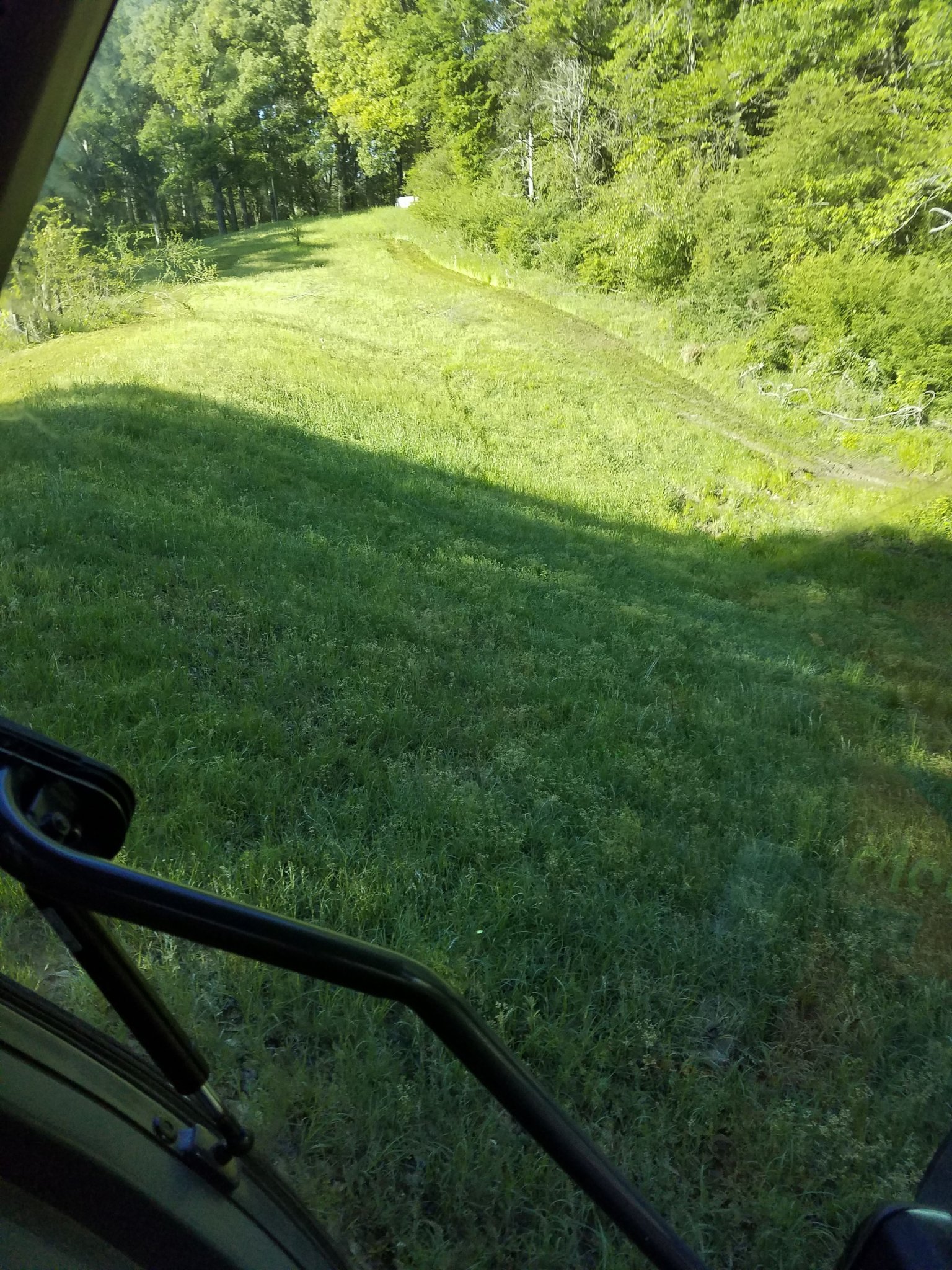

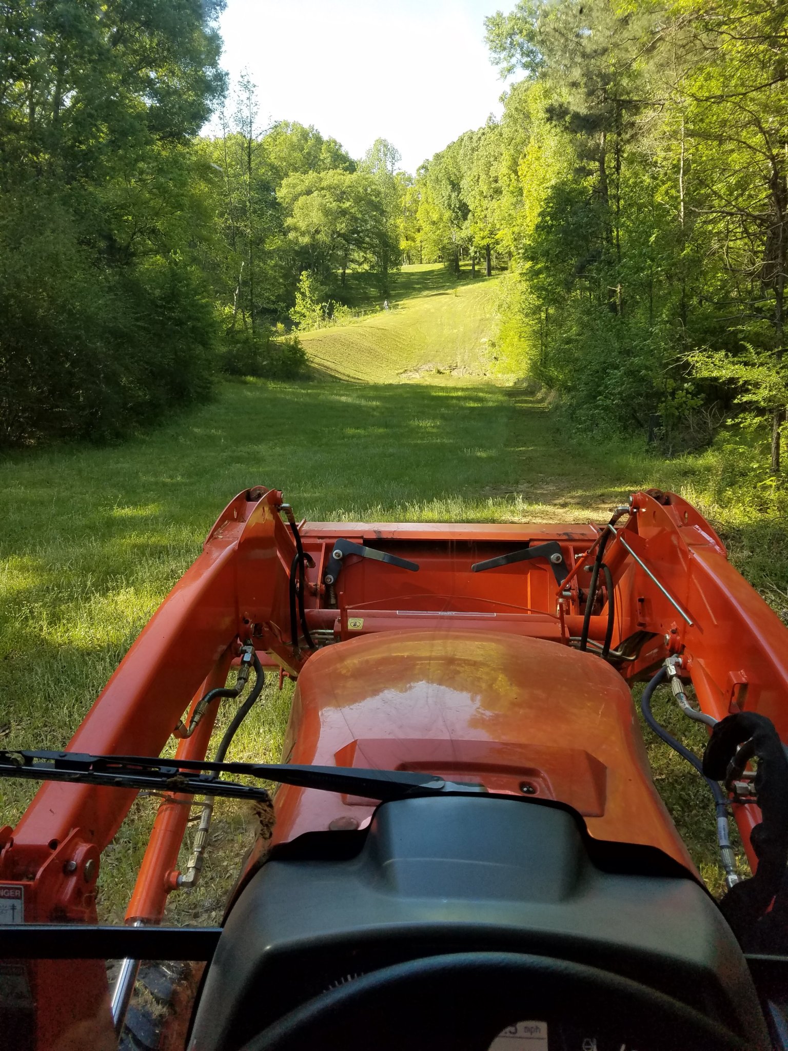

Saturday morning was a trip to the back forty where much attention was needed. Had to cut from here up to our front field by the road. Not too bad, couple hours worth.
That includes cutting the somewhat pretty steep pond dam. I keep the loader and bucket on when I'm back here just to keep a little more weight down low. Youngin getting the stihl ready so he can cut the pond side of the dam.
It aint too bad, my 3301 always walked up and down it with no problems. The 3560 does the same, only way more comfortably with that sweet a/c.
After that, had to go in and get ready for about a 6 hour run in the kitchen. So didn't get to hit the road frontage until after dinner.

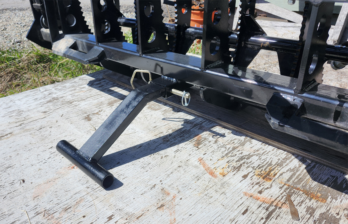

I finished up the grapple kick stand this morning with some welding, priming and painting. It came out better than I expected with very little in the way of planning or measurements. Sometimes you get lucky. The one thing I did think about was using a piece of pipe for the foot since it doesn't matter how the foot is oriented to the ground, there will always be line contact.
Removing the grapple was a cinch, and it seems to be very stable as shown. Another project crossed off the list.
