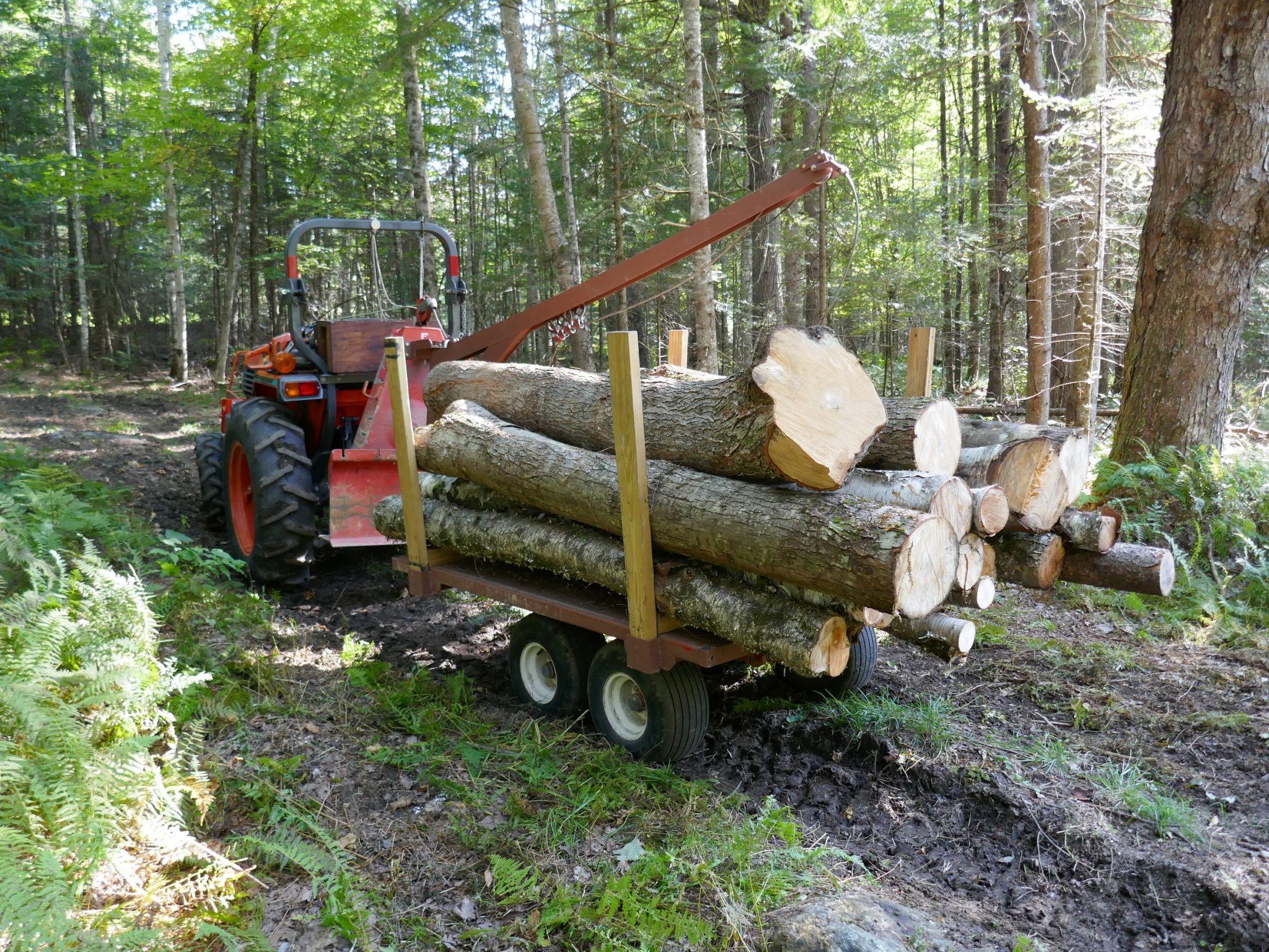

I've working on firewood the last couple weeks. Limb wood and sort pieces previously cut and laying out in the woods I pick up with my little crane and trailer.
Most trees I cut are from thinning or just low quality like this odd shaped 3 stemmed maple that is blocking light from the young pole sized red oak across the trail.

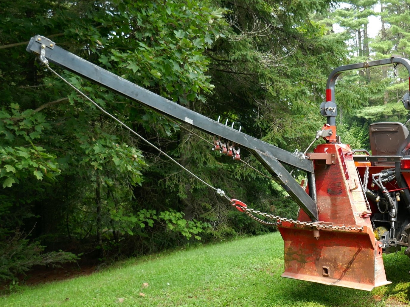

I like your crane, but I clicked on the pictures several times to enlarge them looking to see how it was attached. I finally noticed it was 2 different tractors and winches!
Tunnel vision because I was admiring the crane I guess.
Did you build that yourself or something you bought or adapted?
I made up an adapter from 3pt to SSQA and I can use the forks on back as I palletize my firewood .
I made a mount on that so I could use my HF pickup crane winch on there to pick up awkward things to load or move.

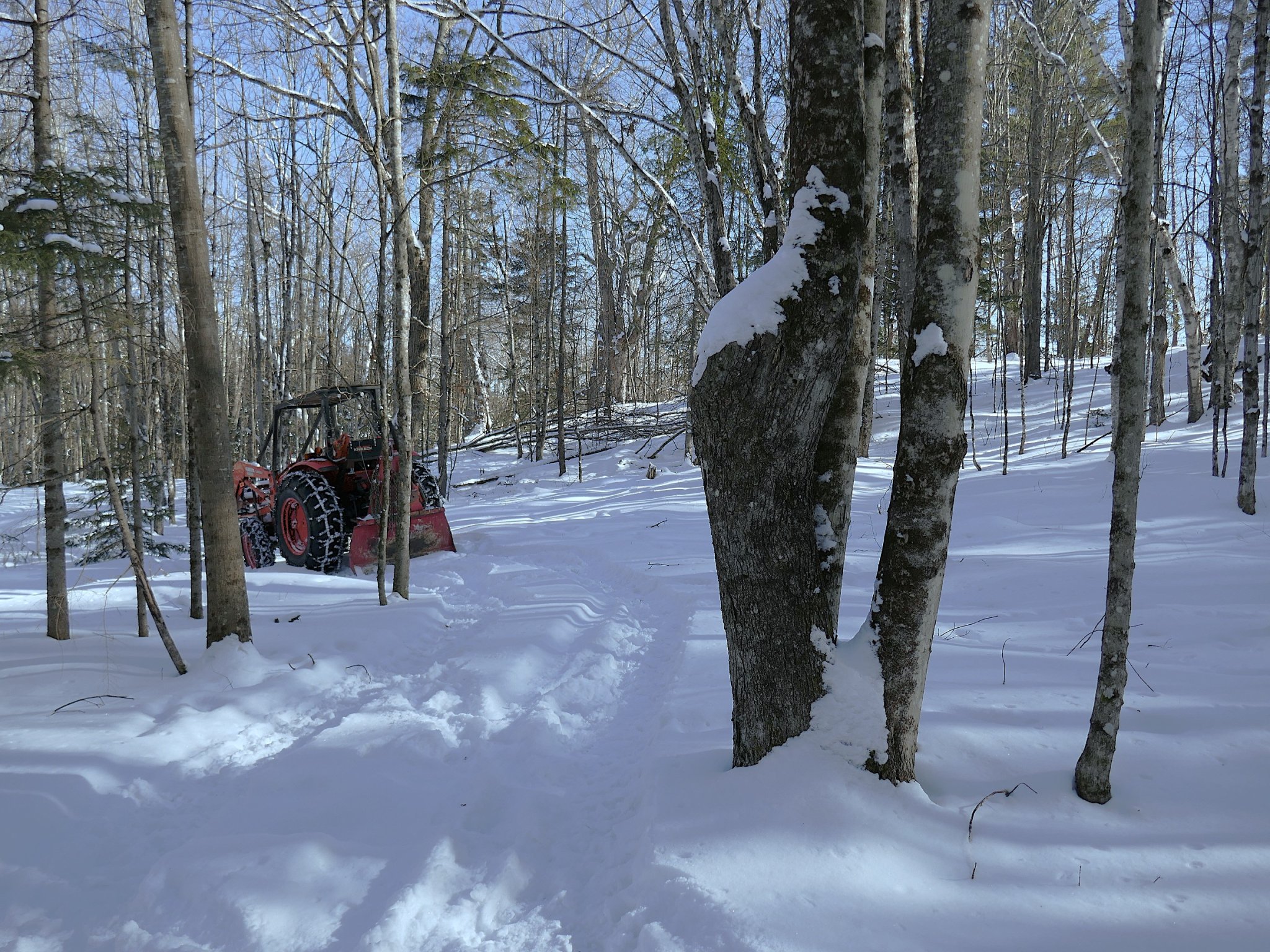

I also use that adapter but put the loader bucket on it, angle it down to pack the snow and smooth our dog walking trails thru the woods. A lot easier to go forward instead of back . dragging like I did in the past

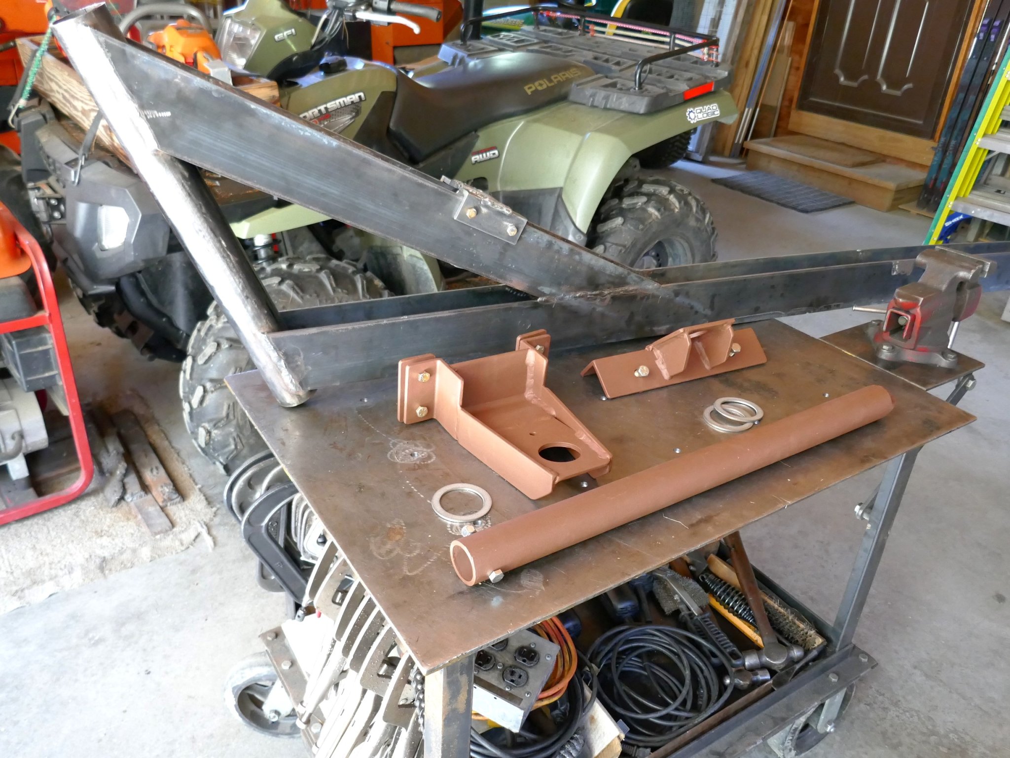

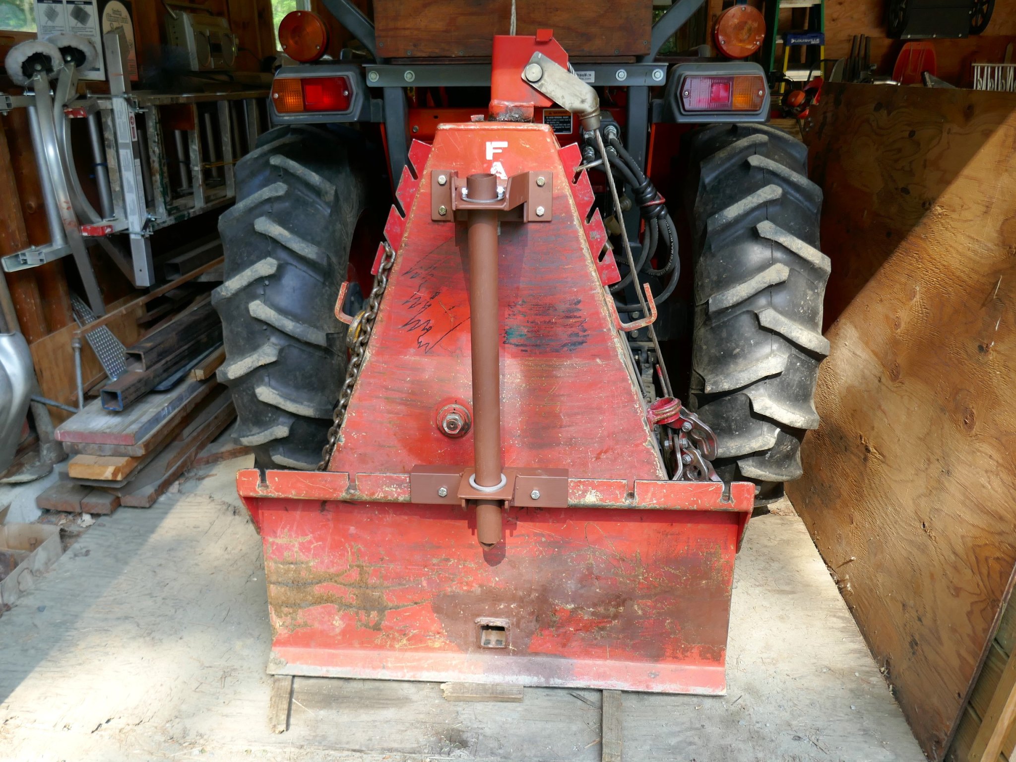

It is mounted on my Farmi JL290 winch/L3010 tractor. A couple pics...

Thanks. It is mounted on my Farmi JL290 winch/L3010 tractor. Swings on a pipe in a pipe type hinge. I put a lever actuated automatic brake on the winch so I didn't need to use the brake rope when lifting. A couple pics....
View attachment 147357 View attachment 147358
gg
I'm impressed with all the details, thanks for sharing the photos on it.

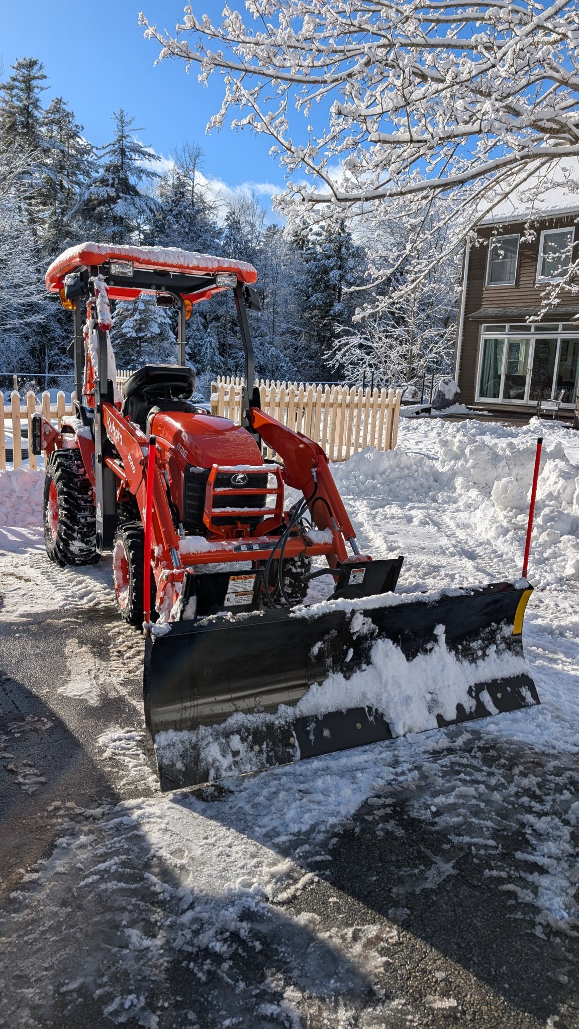

Installed my new Land Pride plow on the B26 and plowed the driveway (~450') to get the hang of it. We had 5-6" on the ground from two snows this week, but we'd just been driving on it. Going down to -6F here tonight and I thought I should get rid of it before it becomes a skating rink.
Waiting on a poly cutting edge that's on backorder.
That's awesome. Kind of like the smaller cousin to the STB1596 I have. Looks like you have hydraulic angle set up too which is the way to go. (y)
Yes, when I bought it, I really wanted a grapple, so I had them put the third function on it.
Still haven't bought that grapple. Forks and now this have been more immediately useful. 🤷‍♂️
