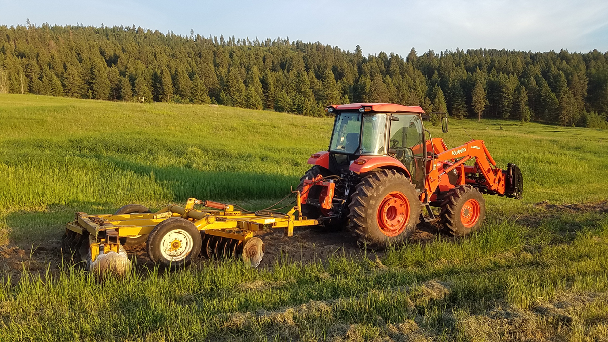

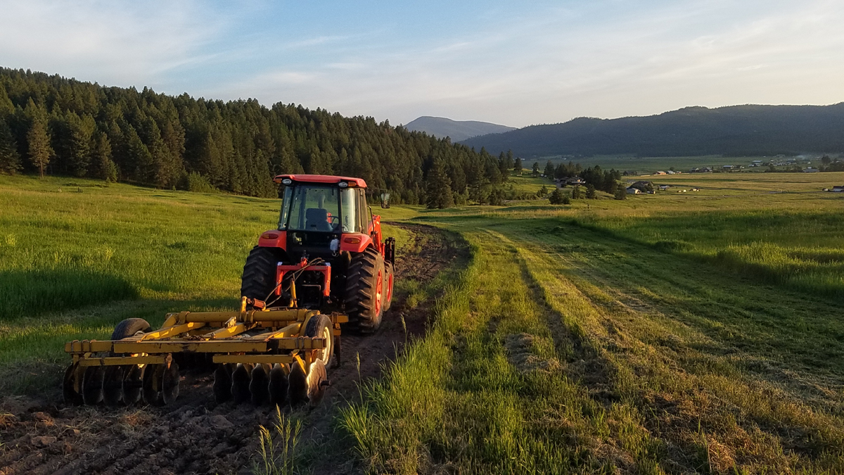

Yes and no. A good heavy disc on a larger machine, yes. Lightweight discs suitable for an L series will be disappointing.
7,585
10,528
Good to know. I've run my disc around and it's very effective but you make a good point about the lighter variants.
Your disc looks substantial enough to be useful. Those lightweight models for smaller/lighter tractors really just jump and skip across the ground. An appropriate sized Fred Cain plow will work on smaller tractors pretty well.

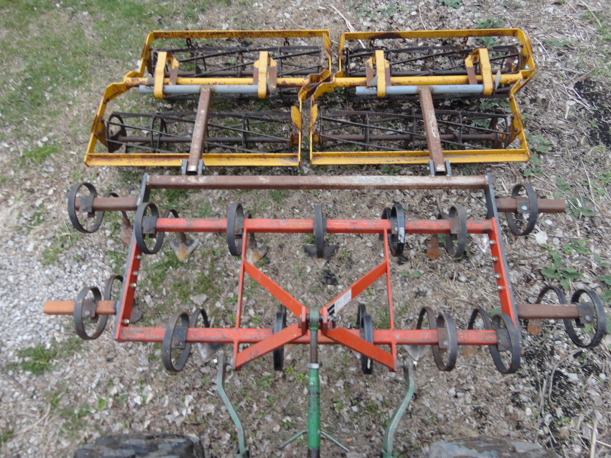

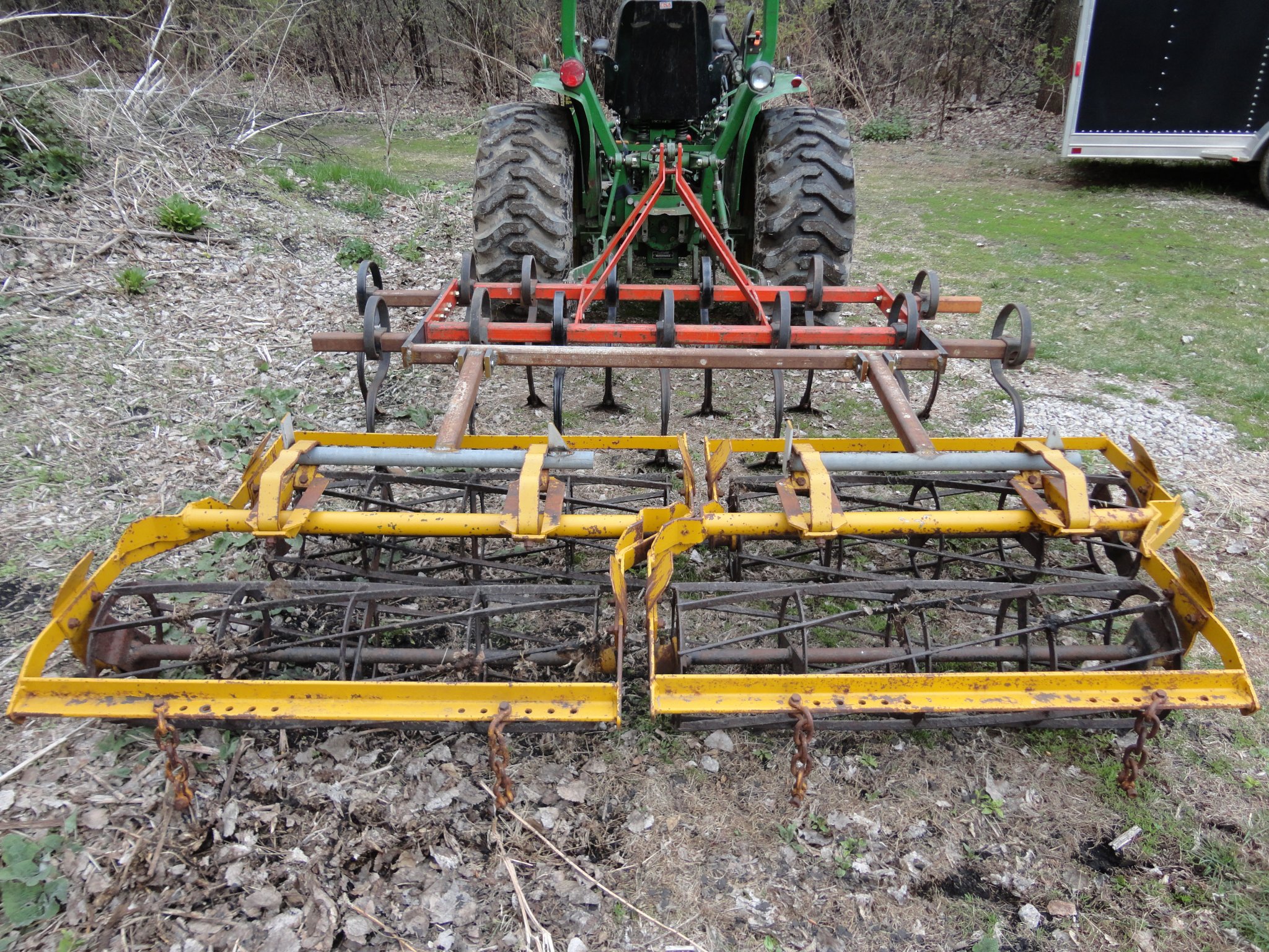

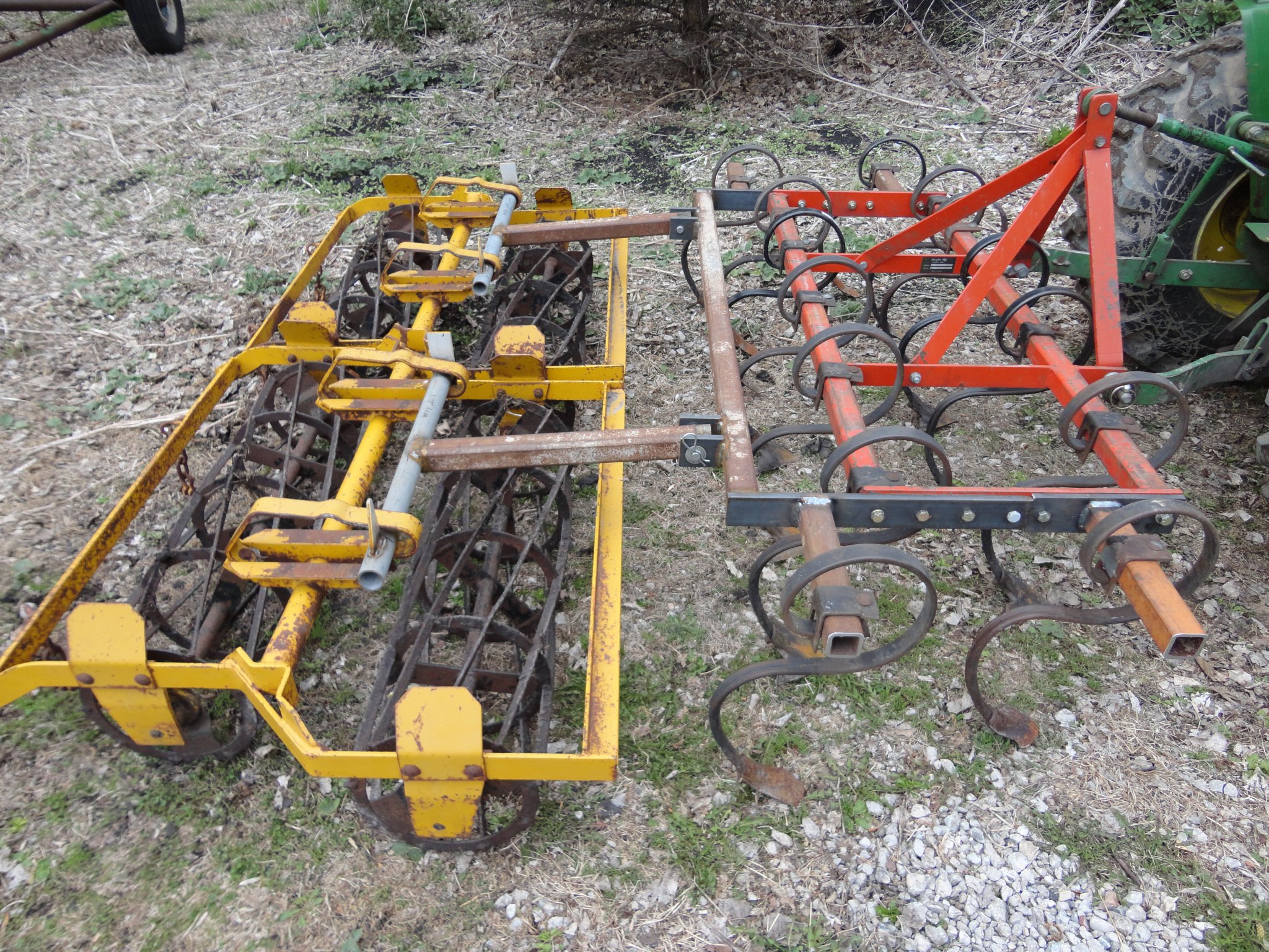

A 3pt cultvator sized for your tractor can be found reasonably priced on the used market, most likely.
You can then hook a couple of used drag sections behind as you go after you've loosened everything up and maybe cleaned up some of the small saplings ripped out.
Here's my cheap outfit put together from used eqipment that I use for seed bed prep on 3 acres. The rolling baskets added certainly do a nice job of breaking up clumps and final leveling. I added a couple of wings on the 5 ft cultivator so it would match the width of the two rolling baskets.
Total width is about 7 ft =/-. Pulled easily behind the B2650 (25 HP) Makes for a quick job on 3 acres!
View attachment 121780 View attachment 121781 View attachment 121782
That would be good to use after the Fred Cain plow does the heavy initial work.
