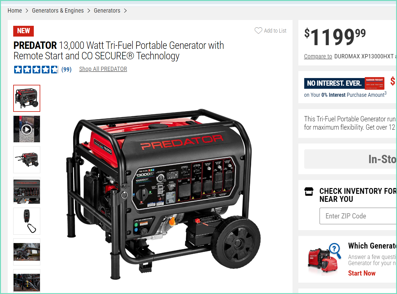

I mean, if you want cheap - go big! :):) Order the same POS from Ali Express:
Even Harbor Freight (a company well known for high-quality, long-lasting, investment-grade tools and equipment) can't match the CHEAP of that Westinghouse unit!

Before you are too quick to disparage products made in China (or elsewhere overseas) recognize that they are capable of making some really good stuff.
The difference between Chinese JUNK and decent products... lies with the specifications for the product and quality control.
I would not argue that many Chinese products (when left to the devices of the Chinese) are indeed pure junk.
On the other hand, when built to specifications, products can be quite good. Westinghouse generators are engineered in the USA and built to 'specs' in Vietnam (and some in China). They have a fairly good reputation.
POS until proven otherwise. These are quite literally the cheapest gensets available here. You'd have a tough time convincing me that 'specifications' under control of 'USA Engineers' go much beyond the landed cost...
