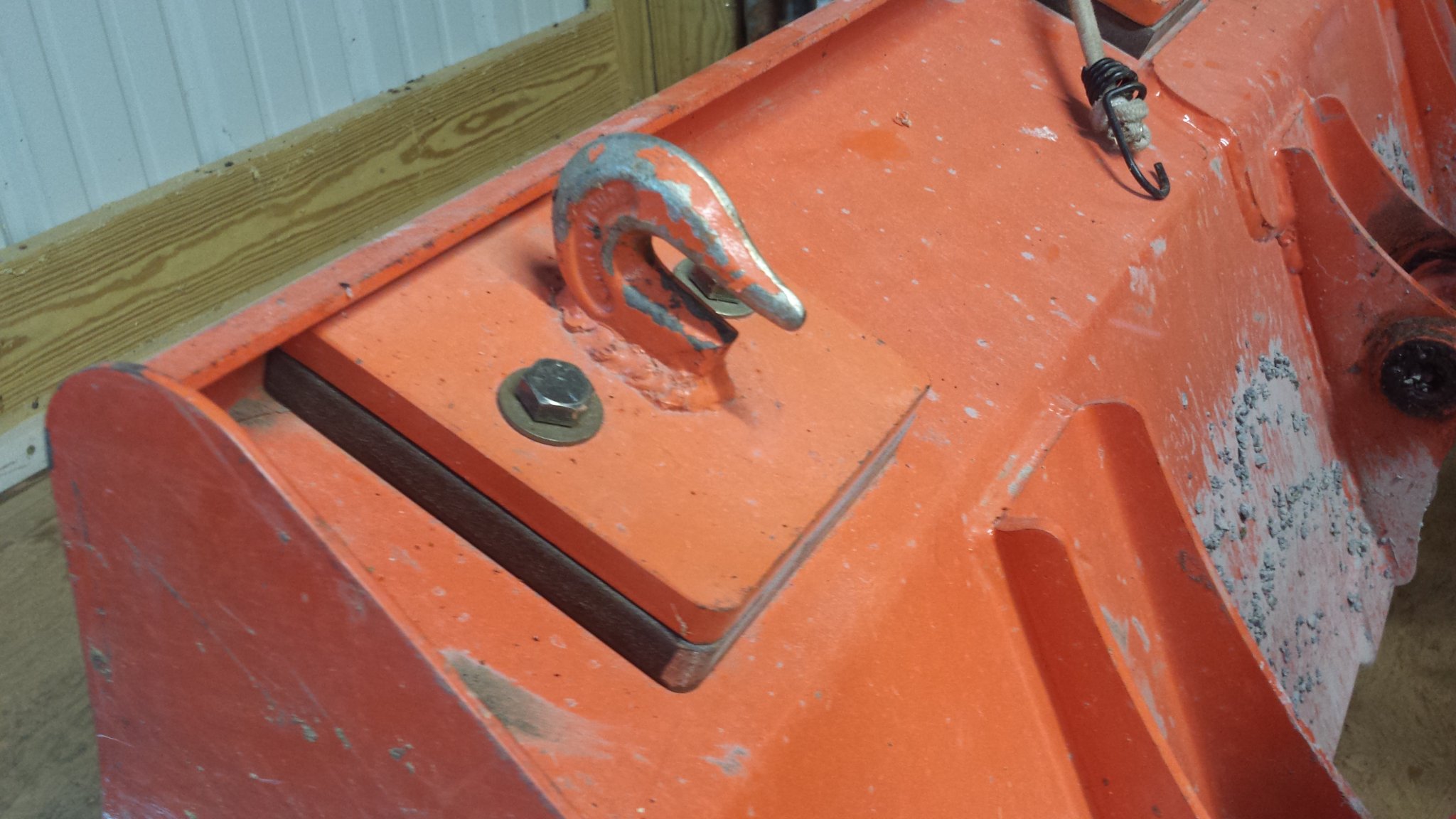

Curious - bolting not an option? Reason being - not that a is not good enough, IF you pull a little to hard on something, the bucket metal could bend.
I supporting plate adds to the hook thus allowing more pressure to be placed over more area on the bucket.
Then again - many will say - the BX series will not be strong enough to mess up the metal on the bucket!;)
i have 2 hooks on my BX welded at the outside seams (free install by the dealer). they arent going anywhere. probably wreck the loader before you would hurt the bucket.
when welding on something with electronics i always disconnect the battery, for the bucket though, if its SSQA its much easier to just drop it. like Jay said, cover stuff up. OR if you drop the bucket back the tractor up a ways.

I welded my hooks to the large angle iron and bolted that large angle plate across the entire bucket top. Put hooks in line with the bucket arms.
