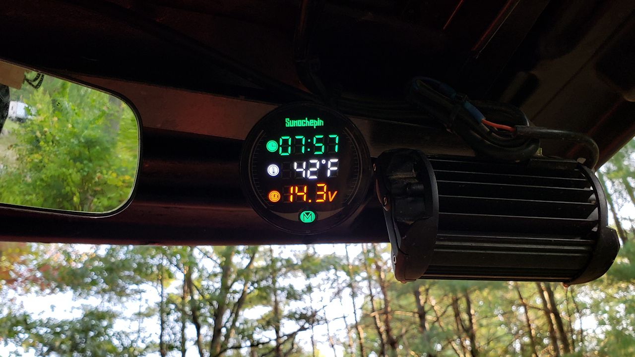

I know if it sits a few days it is more noticeable. That is what prompted the battery replacement. I checked for any parasitic drain and it was drawing 3mv. If I unplug my clock it is 0-1mv.
Unplug clock? Aftermarket?

Very nice = I am not sure which of the three pieces of data are more important..... but I'll take one! Where did you find?
FYI - it is a 24hr only clock. The voltage is right on the money. The temp seems right, I didn't test it.
