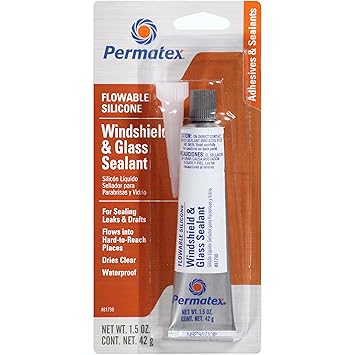

The glass is probably not sealed well - it happens! Use a hose to put water under pressure against the edges of the glass and see if you can detect a leak. If so, then use a flowable sealant similiar to below and see if that helps. If not, you may have to remove the glass and properly reseal. You can do an internet search to see how the old sealant and glass are removed - for example, dental floss is one method but there are others.
