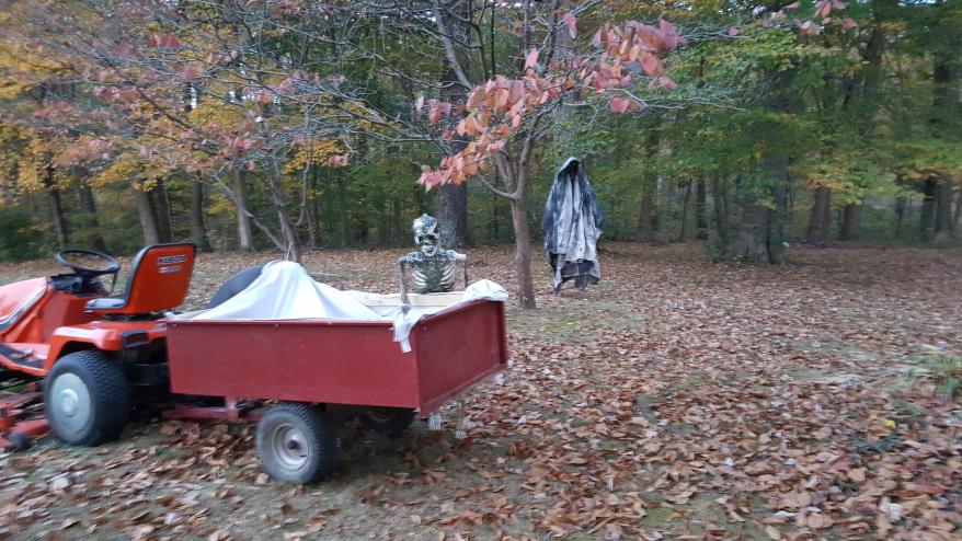

It's a 3x5 wagon. There's at least a foot and a half legth on the wagon hitch. I'm trying to use it as a leaf catcher. Backing up is difficult to control and sharp turns nearly tips the thing over.
Here's a pic. It was taken in the fall so don't mind the halloween decorations.

The cyclone rakes have a hitch that attaches to the mower rear axle/transmission in two places so it can't jacknife when backing up. The catch is you'd have to change out your two trailer wheels for ones that swivel so the trailer can move sideways when the mower turns. Since yours is a small trailer that should be possible to improvise. Heck order the wheel sets from cyclone rake.

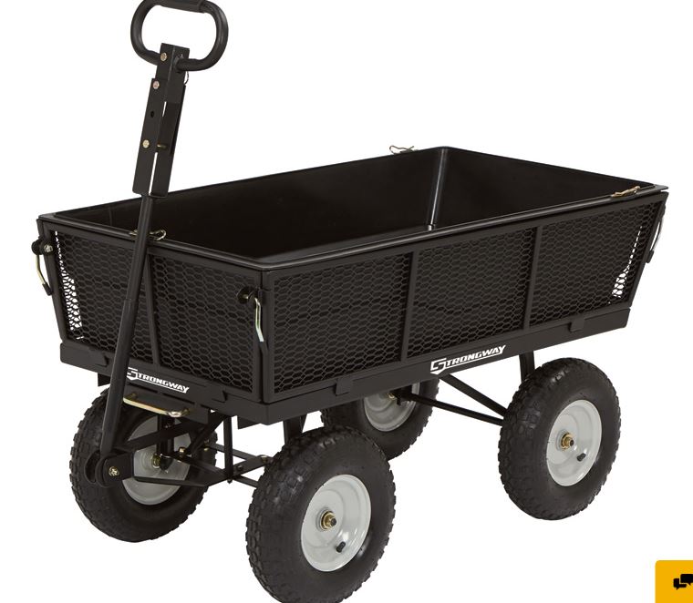

That's not a wagon, that's a trailer!
This is a wagon:
The trailer you have is about the easiest implement to maneuver with, that is unless you do as sheep farmer said and set it up like a cyclone rake.

Another suggestion beside the longer trailer tongue is to put car trailer hitch ball on your tractor and then on the trailer tongue put the matching hitch.
In my family, with 4 brothers living in the area we adopted a 2" ball as our standard and the same on any trailer. lawn roller, boat trailer. Then you can borrow or move things around with your lawnmower when normally you would need your car. This style of ball hitch has no slop in it so backing up is easier.
Often I go to a local steel place and buy a piece of 2-1/2" x 2-1/2" 1/8" wall square tubing. Bolt the hitch to the tubing and the tubing to the underside of the existing trailer tongue. In that way should you want to sell a trailer like yours, all you have to do is unbolt the square tubing and it is back to original.

It looks like from the picture that you are trying to catch the leaves from your lawn mower, and if so, then a rigid connection is helpful so that whatever collection tube you use is as short as possible and can stay the same length. Otherwise when you turn left it will come out of the wagon.
