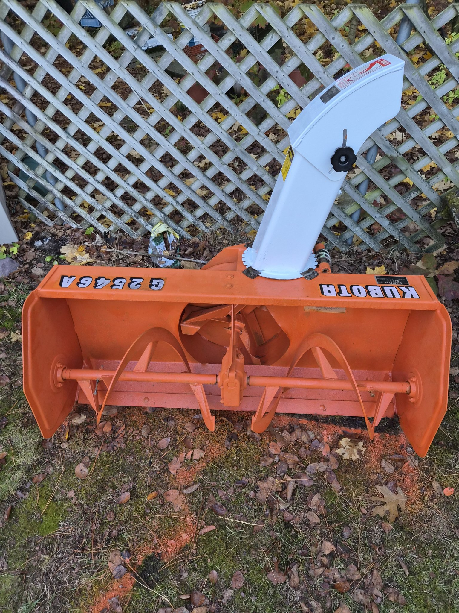

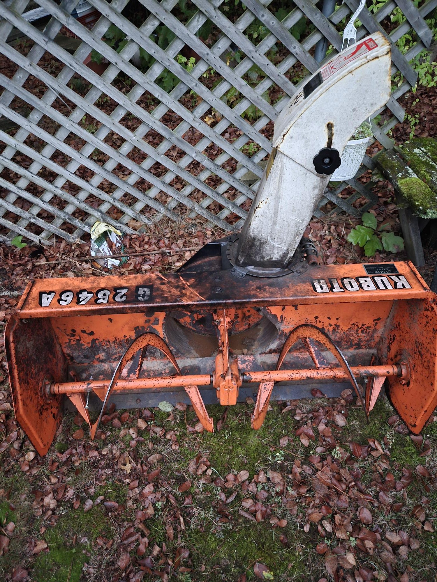

I'm very anxious to get some snow this year and that's a mouthful! I'm used to using my walk-behind Husqvarna (it's also orange so I thought it would be okay to use the brand name :)) two-stage blower. I recently picked up this used G2546A this year with a used G5200H tractor; they threw in the G2003 snow blade also which is in really good condition. The tractor runs great, but still going through some clean-up and painting. Just finished the clean-up, painting and maintenance on the 2546 though and I thought I'd share how it turned out. I ordered a new impeller for it (it may end up being a shelf spare), but as it sits the drive works smoothly with no binding at all. It was in pretty rough shape being used on a LONG gravel driveway, so it should get a more gentle use on my asphalt, not to mention regular maintenance!

Awesome job, cleaned up real nice.
Two observations - might want to retrofit a couple skid plates on the bottom edge so it doesn't cut into the driveway. Maybe get a couple real shear pins, the one on the left looks a bit wonky, but hey if it works...

Thank you! It has the skid plates on the back side, should be good giving it enough clearance to avoid damage. Yes, not sure what the previous owners were thinking, probably a case of just have a bolt that would fit. I bought a box of shear bolts, but they must be for the impeller because they are slightly larger than the holes on the augers.
