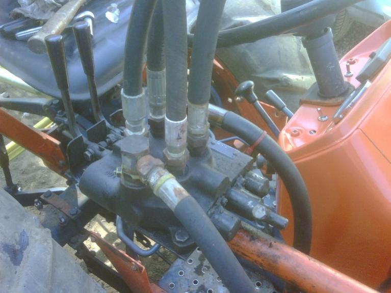

But what do you think about upgrading one size up of cylinder~?
Would it be worth it to improve the performance~?
Joe.
1. if there is a 25% increase in lifting power, you can bet your sweet arse that there will be a 25% decrease in speed. Maybe it's not exactly the ratio, but you can determine the volume of the 2 cylinders and subtract the volume of the 2 rods to determine how much more fluid needs to be pumped into the larger cylinder.
2. There needs to be a 'weak link' in the system. Any mechanical system needs a week link. The weak link is basically the end of the line safety of your tractor. I suspect increasing your cylinder strength by this much will do more harm than good to some of the more critical framing or sub framing.
3. If it's too slow, captjack said was his problem he doesn't need more lifting force, he simply needs more GPM.
