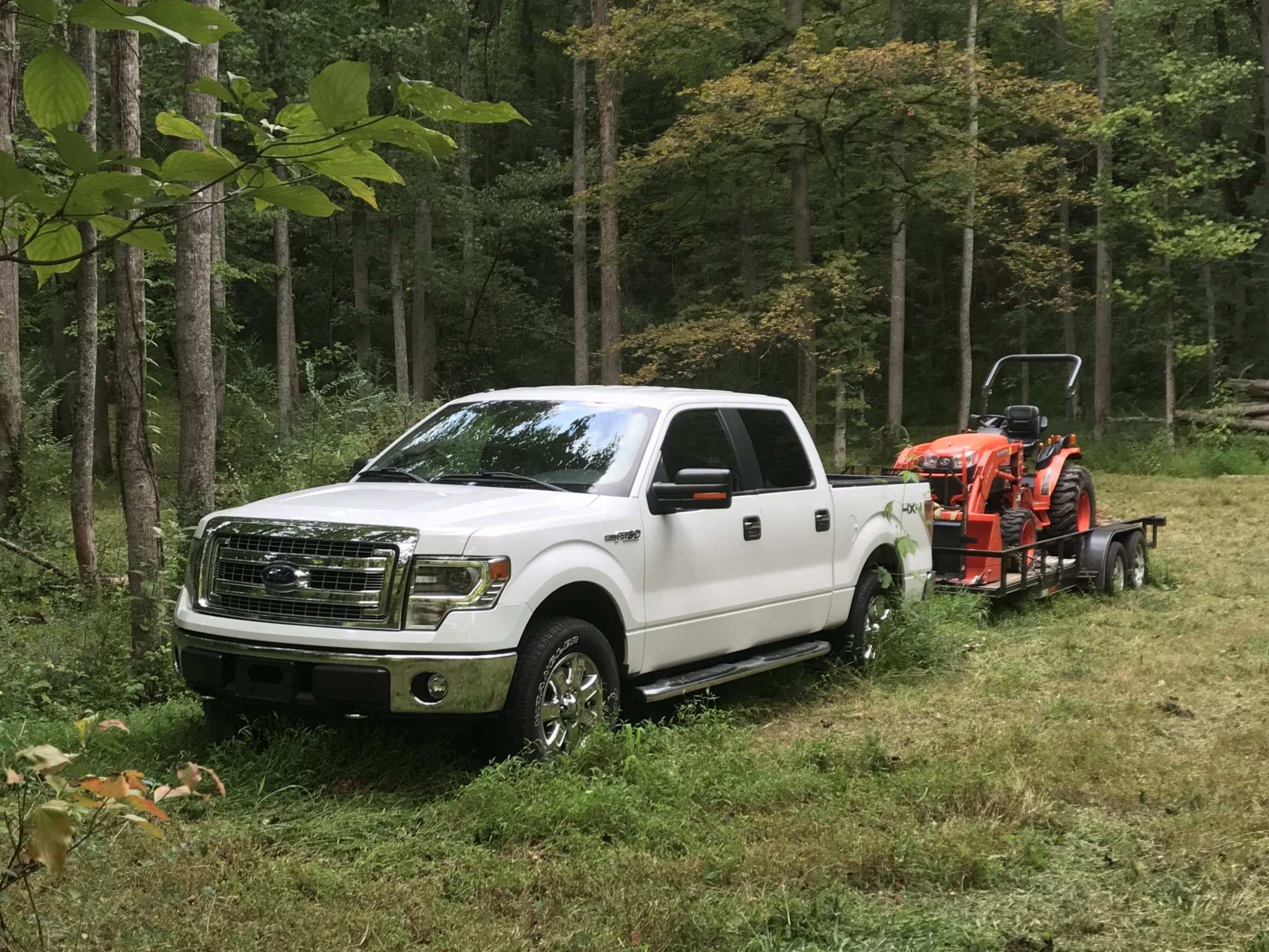

Many mile Interstate trips, or just around town?
beckmurph
Kubota LX2610TLB/Woods finish mower/woods rotary cutter/
Aug 23, 2012
274
144
catlettsburg, ky
The white F150 had the 5.0 engine.
The gray F150 had a 2.7 Eco boost.
Both did fine pulling my Kubota.
Grossing about 11,500 lbs.
