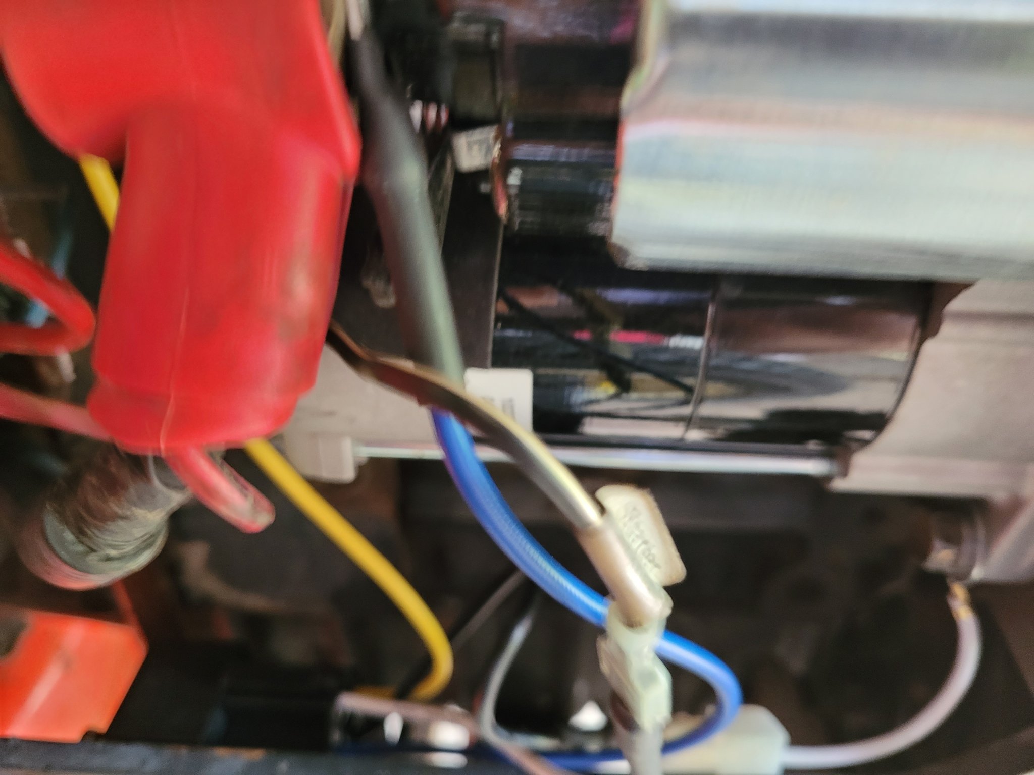

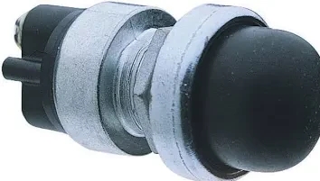

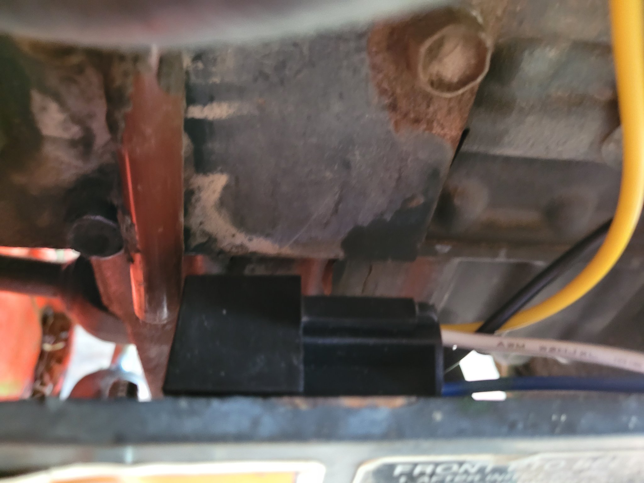

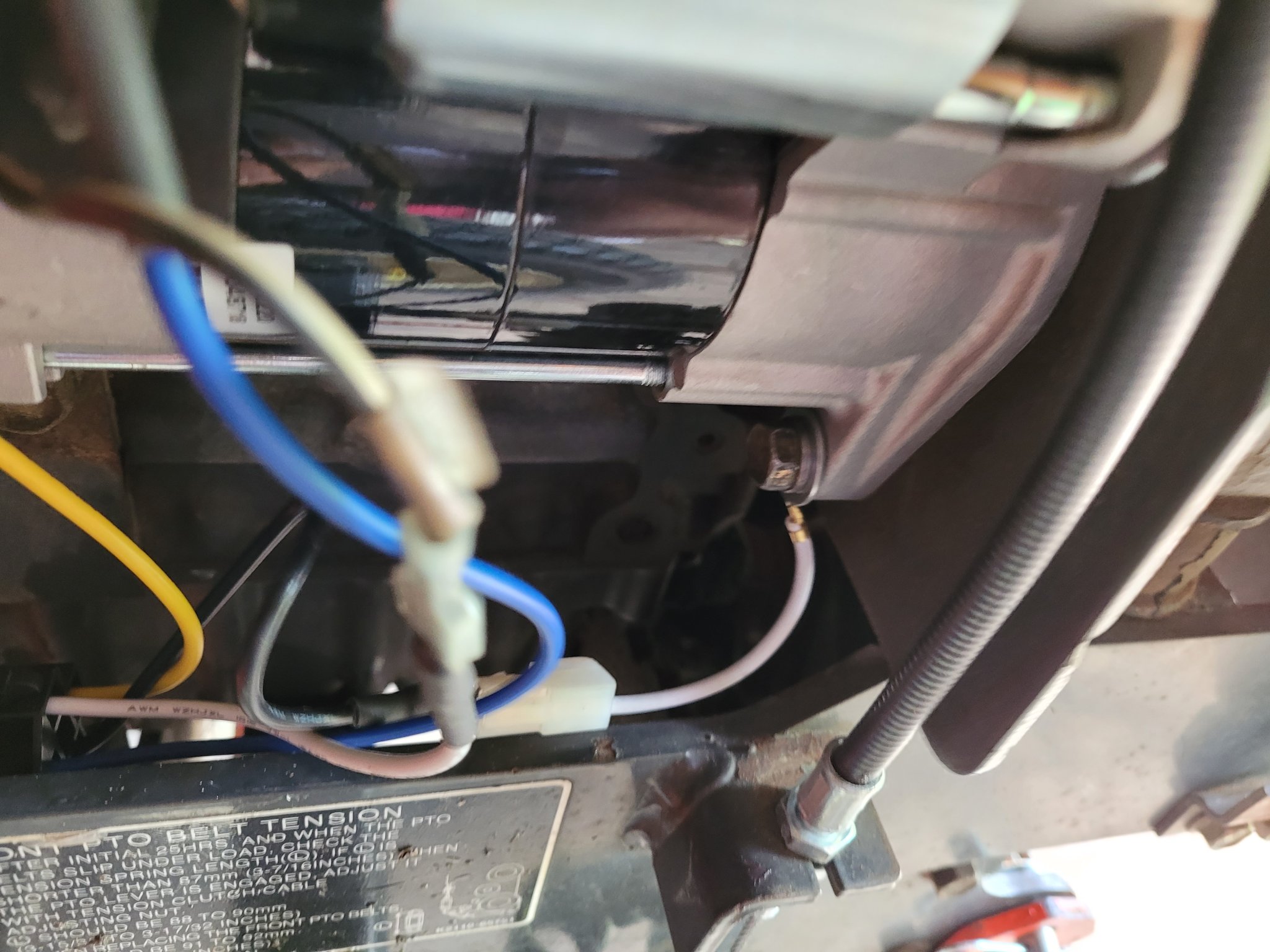

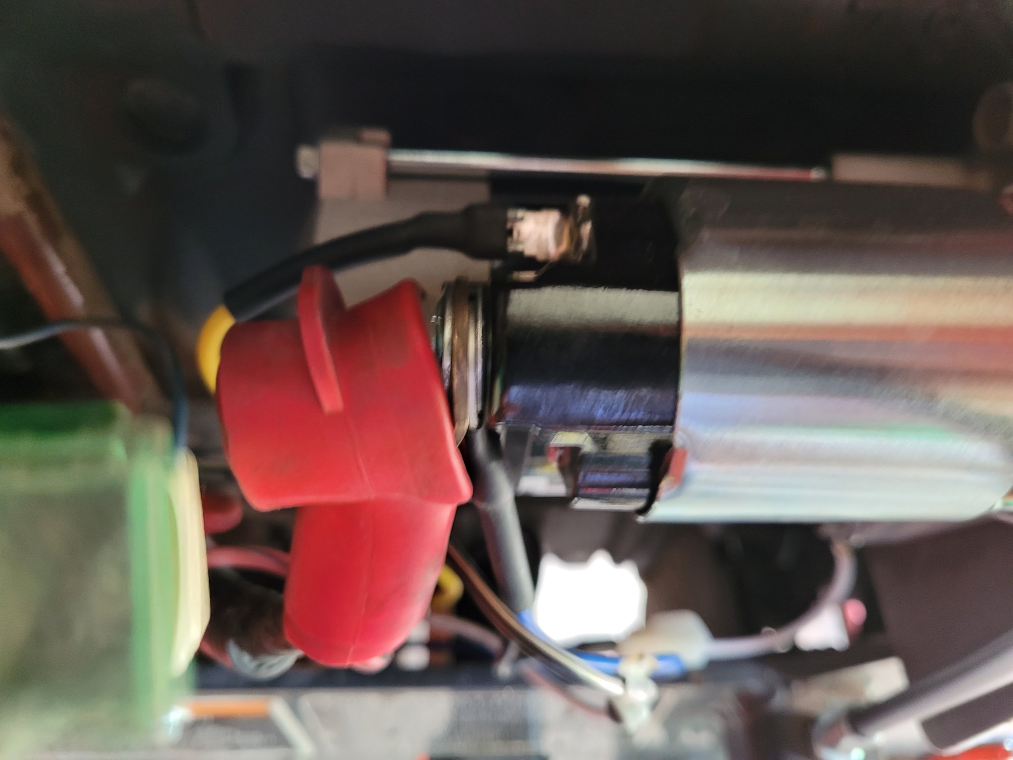

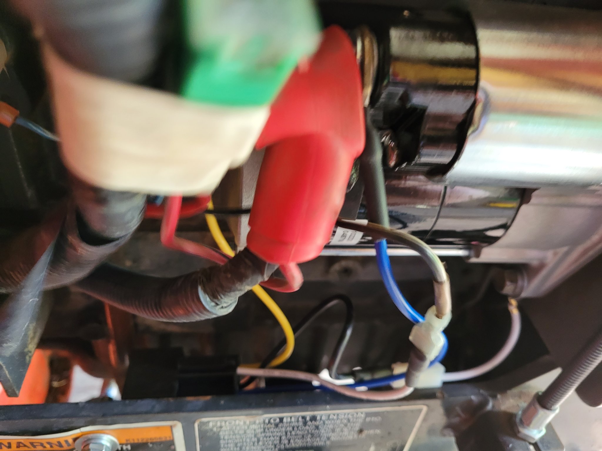

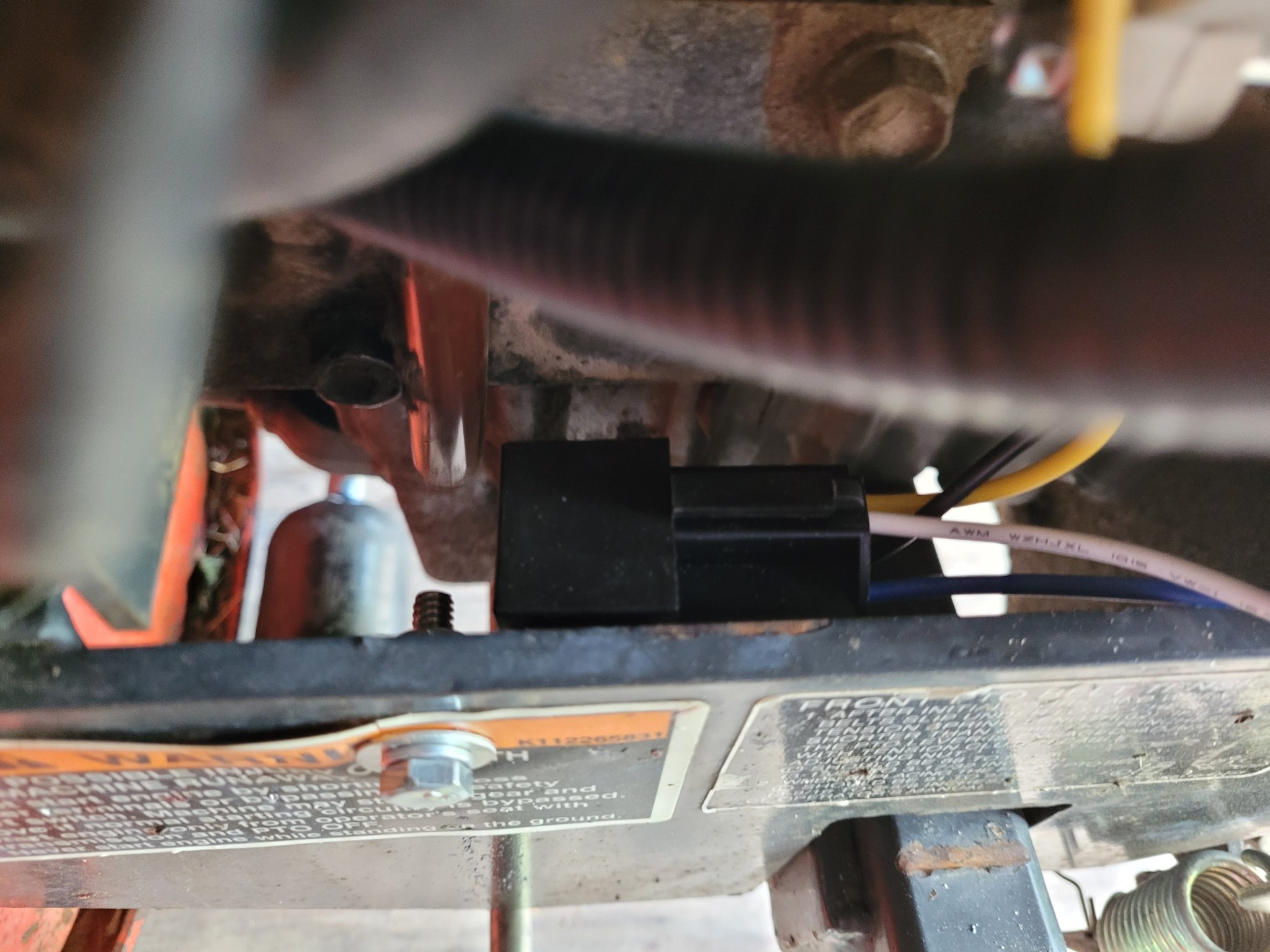

I bought a whole box of these Amazon.com: 5 Pack - EPAuto 30/40 AMP Relay Harness Spdt 12V, 5-PIN SPDT Bosch Style : Automotive
They come with wire harness, plug, and bracket. I used one for my starter relay installation, another for my tow behind sprayer harness I added, and another for my lighting system I added/upgraded.
View attachment 106860 View attachment 106861 View attachment 106862 View attachment 106863 View attachment 106864 View attachment 106865
So do we just think the starter relay is going bad and needs replaced?
