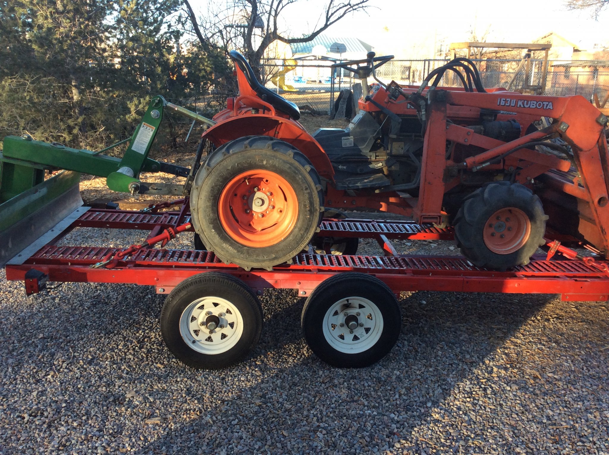

I would only buy a trailer if you will need it after you get the tractor home. Otherwise shipping it should be cheaper. I built a dual axel trailer for my B7100. The 6100 are light but it is nice to have an extra tire on each side if one fails.
