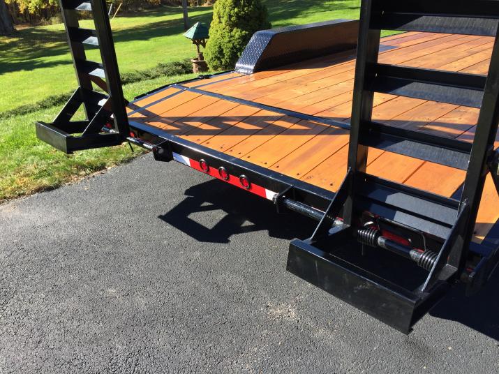

Should I use cinderblocks under the back of the trailer loading/unloading, being that its a dovetail? Do they make something specific, or better, I could bolt on down the line?
It looks like your ramps have the stands built in that will prevent loading and unloading from lifting the rear of the truck. No need to further support the rear of the trailer. You will have to pay attention to existing grades where you load and unload though. When you pull up on the trailer the added weight will squat the trailer a little and if the ground is unlevel you may find the stands on your ramps stay in contact with the ground preventing you from being able to lift them. Just pull the truck/trailer forward and they will flip up and take the weight off.

Oh yeah. Would you look at that, it looks like I have some sort of built in stand on the spring ladder. :D As you see in the second photo with the ramp down. there is a bit of space. Should I put some wood under that too, or will it be better to have some wiggle room? (ill probably put a sheet of ply wood anyway just to protect my driveway)
I wouldn't add anything. You want some wiggle room and even if those supports touch the ground when loading, its very unlikely it will pick the back end of your truck up.

Oh... you wont want to let this one slide...
In your picture showing the distance between the support and the ground... You've got the ramp bar resting on the ground. Flip that over and rest it on the trailer. You don't want to load the trailer with it resting on the ground. It wont end well. They are easy the straighten out since you have a rub rail...

Thanks for the clarification eipo, Also, I'll make sure the bar is resting on the trailer when I load for the first time. Wouldnt want to bend it on my first load.
