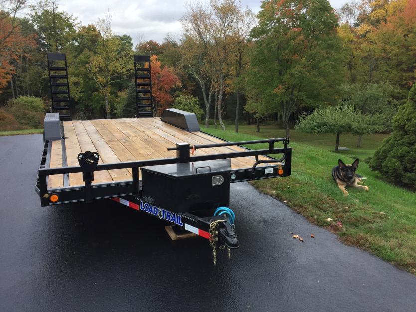

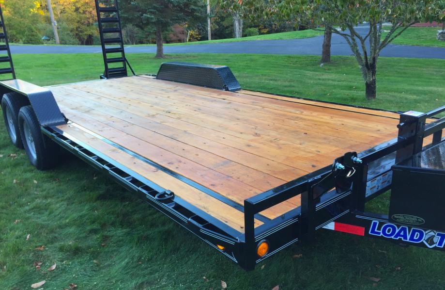

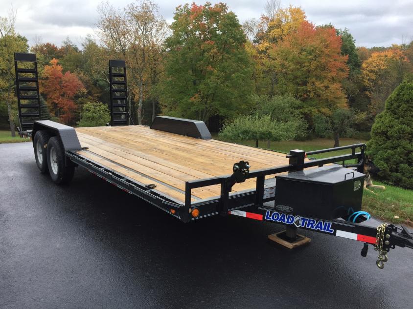

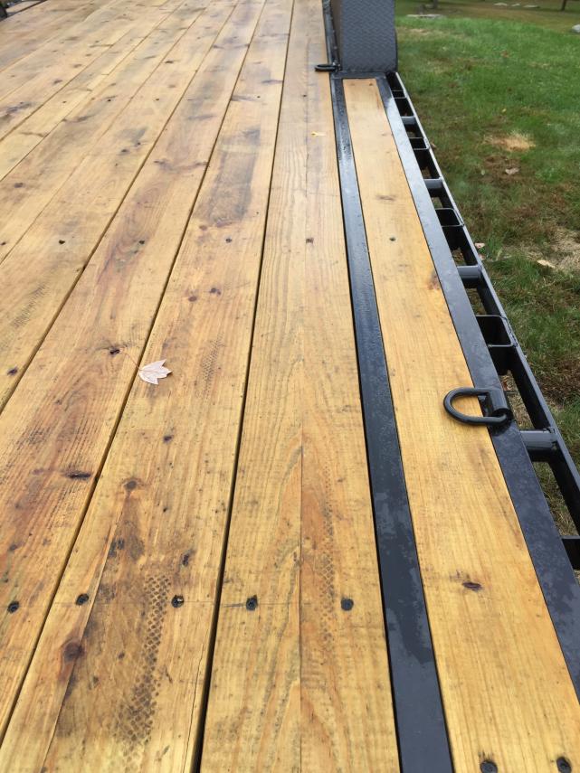

Hey guys, After seeing "Unloading tractor from Trailer causes accident in PA" :eek:
http://www.orangetractortalks.com/forums/showthread.php?t=27153
and being that I just got my 20' dovetail trailer yesterday, and I live in PA (double whammy) I think nows a good time to ask for any advice or tips on how to best deal with loading, unloading, driving and storage.

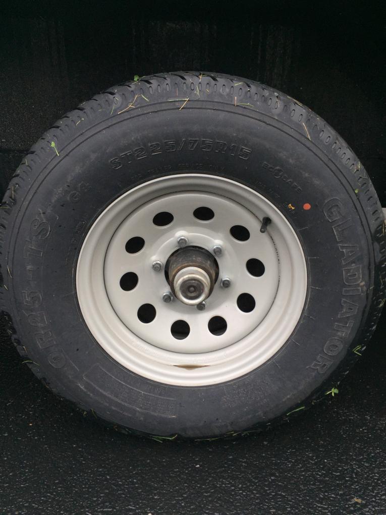

I upgraded my truck tires to E rated ones. I'll get my WDH on order as soon as I sell my old tires. The dealer sat with me and we set the gain on the truck brake controller and he gave me some basic driving tips. (make wide turns and don't hit anyone) ;)
So the fastway one step wheel chock is the best way to go? Chock the truck too? Keep the brakes on, 4x4 engaged, flat surface, best practices? What if I have no choice but to load/unload on incline/decline?
What about storage, do I cover the tires like campers do? Spray it with wd40? Cover it with a tarp? Its going to be sitting in the woods basically.
The wood has a few minor warps in it, and one plank has a big ol crack in it. I'm assuming it's not a big deal, the dealer said to seal it with thompsons or something similar.
It has a mount for a spare, the dealer just forgot to add it, I'll get it when they're done with my tractor (the kubota rep is going to disassemble the gear case and put a bore scope inside to take a closer look)
As usual any or all advice/comments would be appreciated.

What a nicely appointed trailer. Slosh some 50/50 burnt oil/diesel on the deck and let it soak in and you're pretty well good to go. I wish I'd known about the tie down rails like yours has before getting mine. Haven't had the need to load up yet and still need to do some trial runs to work the kinks out. Your rig will make it a snap.

Do not put anything on your deck that will make it slippery such as oil. Those boards will last a long time just the way they are. I had a trailer just like the one you have and it towed great. I towed it with an F 250 super duty. My deck got slick once and I almost put my skid steer off the side while loading it. Just remember that you have the extra length behind you as a lot of bad things can happen fast. Watch the weight on the front of the trails so you don't get a whip effect.

What I did was watch the back of the truck while loading for the weight on the front of the trailer. If you have it to far forward you will know it when you are hauling it. Another tip is once I found the right spot for the weight distrubtion on the trailer I nailed as small piece of wood to the deck so I would load it the same all the time. My skid steer weighs about 9000 and I just center that slightly forward of the first set of wheels on the trailer. I don't know what your tow truck is but learn to set and use the trailer brakes as they can save your bacon sometime.
13,064
4,425
I have a trailer I had custom built about 1985. It had 1"x12" rough cut oak I picked up from the saw mill for decking. I laid out the boards and clamped them, then bolted with lag bolts. When the lumber dried out I had about 1/2" gaps between the boards.
I soaked the lumber each summer with boiled linseed oil. When the weather was in the 90's I'd dump it on and brush it around. It soaked in quickly.
Those boards lasted until one finally developed a crack and it was just where my trencher tire needed to be! Those boards lasted about 22 years.
I added some more stringers and got some metal for my replacement.
For safety I would suggest you weld some feet, on the bottom, at the hinge point of your ramps. It looks like they are hinged. Then when you swing them down, the foot will already be there. Your trailer will never kick up (like in the article you referred to) because it can't go down in the back.

Very nice looking set up.
Water proofing the lumber is a good idea.
A extended time of shade and a covering of leafs and moisture is hard on the paint, lumber and the iron. Some wind moving across it is good. Be careful with tarping the whole thing.
If your using straps for tie downs remember they cut or rub in half much easier than one would think, best not to have them where they can rub on any kind of edge.
If you even have a shadow of a thought of wether it is tied down good enough, then tie some more. Usually front and rear of tractor and good idea on the attachments also. Even if they are attached to the tractor. I think some areas require it. Grade 70 chain in 5/16 or 3/8. Heavy duty wide straps like about 2 1/2 inch or so.
Tuck your chains or straps up from underneath the rub rails then hook them. This allows them to stay hooked even if slack develops.
Blocks, or something under the rear of the trailor at the ramps is a god idea for heavy loads.
I usually do not put mine in 4x4 for loading operations but if you are in doubt then why not :) chocks on the trailor wheels if on a slope is good idea. I always set the emergency brake. Even on automatics.
Wet or mud or leaves on the bed of the trailor or tires of tractor and to much tire spin and you can go SIDEWAYS on the deck of the trailor when on a cross slope.
Keep the front end loader as low as you can at all times, especially when loading.
Seat belt when loading !
Every one and every thing on the road seems to be careless or inconsiderate. Since your often traveling slower or with a larger space between you and the next vehicle in front of you many will cut right in.....
I like my trailor breaks to grab quickly as soon as I touch the truck brakes, helps in slippery conditions to keep the trailor behind you. Of course you do not want them sliding. Your trailor break unit should have two adjustments, how fast the brakes grap and how hard they grab. Have the trailor break unit in EASY reach to manually apply the trailor breaks. Very helpful on ice bridges, long downhill runs.... and other times also. Use it for practice fairly often so that if you need it you will not have to think about it.
If you stop at a gas station, resturant etc walk around the trailor and check tie downs and latches on the hitches etc. Sometimes they work loose on the road and sometimes they have help on working loose in the parking lot. Theirs all kind of people out there.
Low tire pressure equals blowouts. I keep a tire gauge in the truck.
Is your jack and tire wrench tough enough to jack up the LOADED trailor and get of those air impacted attached lug nuts off?
Several 4 x 4 chunk of lumber tapered at the end is handy, as a tire chuck for blocking tires and also to drive ONE tire up onto so you can take of the other tire next to it for flats. No jack needed often times.
Safety kit reflectors etc for on the side of the road is not a bad idea. Set em up way way way back from where your fixing a flat, you want the idiot driver to have time to realize they ran over your reflector and still have time to dodge you.
Ya i know it was a long post but so many ideas kept popping up, i been hauling since before i was legal to drive 40 years ago :)
Enjoy your new outfit

When I Park mine, it too goes out in the woods behind my house. I run it up on some pressure treaded 2x8 about 4ft long to keep the tires off of the dirt.
Don't treat the deck, when wet it be slicker than Goose Poo!:)

Concrete blocks break very easy believe it or not. Do not use them for blocking up the Trailor in any form or fashion
2nd that. Don't use cement blocks for blocking. Go buy a 6x6 and 2x6 and cut them up for blocking. They are relatively cheap and much safer.

I appreciate all the info Redlands. Very helpful. A lot to learn so I'll be taking it slow. I'll use some pressure treated 6x6's for blocking, till I can get a permanent solution, makes sense.
Zin01, I've got a tundra, my model max's out at at 9400 lbs tow capability. I'll be towing the B2650 with FEL and BH. Approx 5,000lbs. The trailer is 3,000 lbs
Truck has a tow/haul button that I engaged, so you're saying I should downshift even in tow mode? The toyota manual said I should run it in S4 but it wasn't explained clearly I thought tow/haul mode alone would be sufficient.
Tughill Tom, Good idea, I'll run the tires up on some boards and keep it off the ground. I hear that when some people store things with wheels you're supposed to raise it off the ground completely relieving the pressure on the tires. Any truth to that?
and oh, i already went out and bought some deck stain/sealant (olympic 6 year stuff.) I think it should be ok. I went with a nice cedar tone...:D

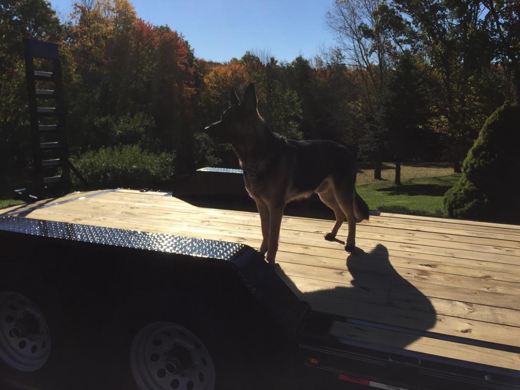

Love my Shepard, he's been playing on it since I got it back! He's scoping out all the deer he can chase down :D

"Burnt Oil" is a term I heard most of my life referring to the oil from your crankcase when you change oil. Mix it 50/50 with diesel it makes a good exterior wood treatment but you do have to let it soak in.
Treated lumber tends to be slick already but adding this to it and letting it soak in on a hot day is popular in some regions for trailer decks to sheds and and barns. If you tend to beat your wood to failure before it rots I wouldn't bother. Heck, I need to do mine too.
