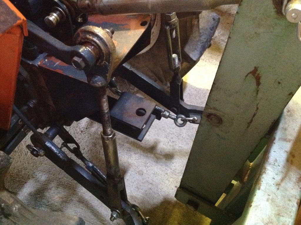

First. get a 3-point quick hitch... your life will never be the same! Then, get a 3-point drawbar (sorry, I can't post a link to this yet because I'm a new user... system won't allow it). You can swap it out with your box blade in about a minute. This makes moving all of my trailers (bumper pulls and goosenecks) a breeze... so much easier than using my F350!

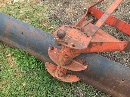

My used back blade came with a hitch ball in one of the holes intended for adjusting the blade position. Haven't used it, yet. Could be handy, but seems like the trailer tongue would have to be pretty high to allow it.

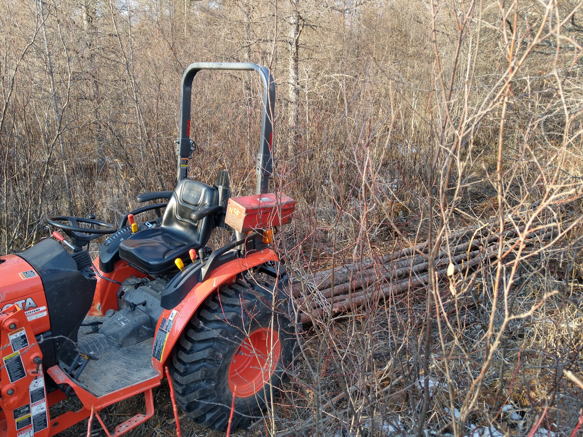

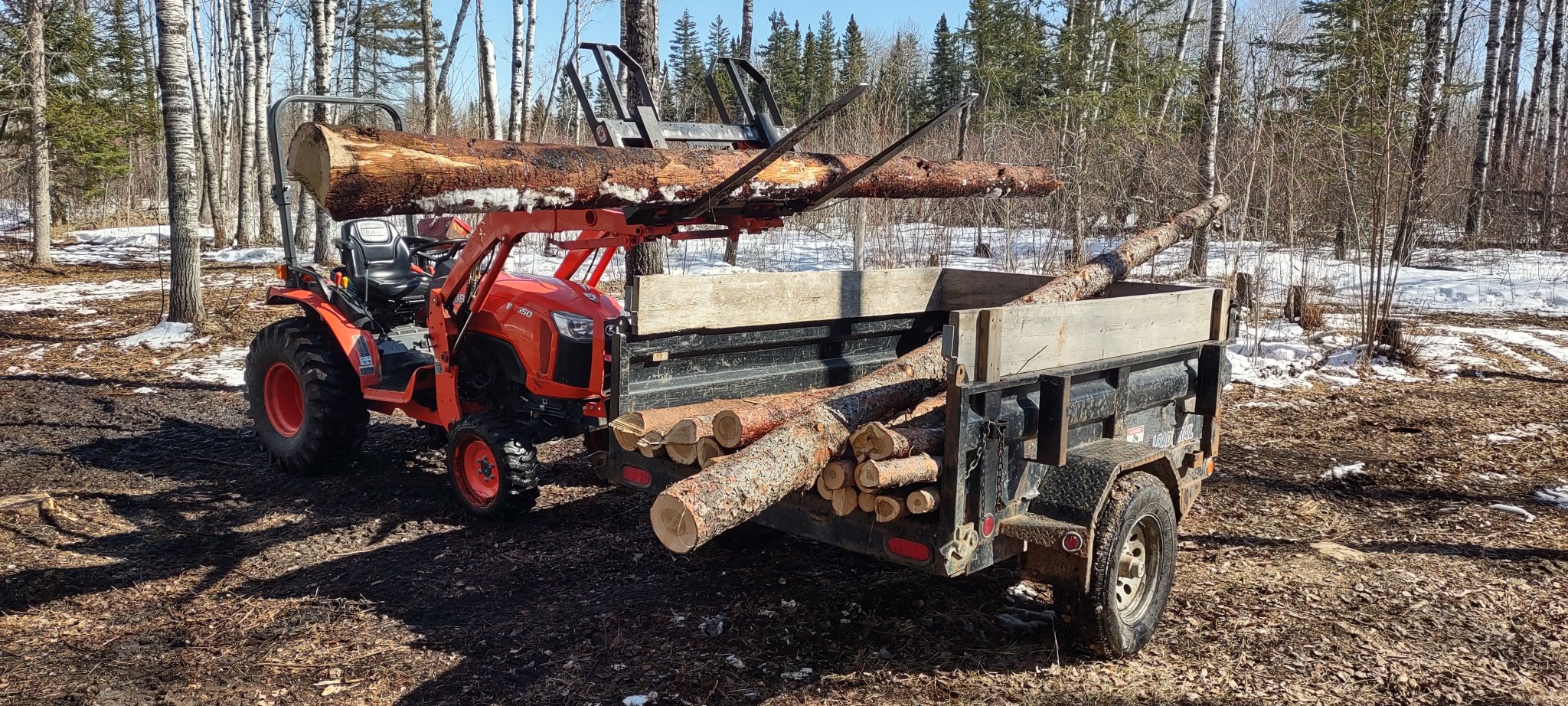

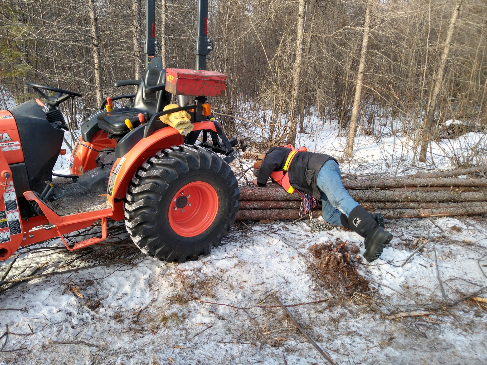

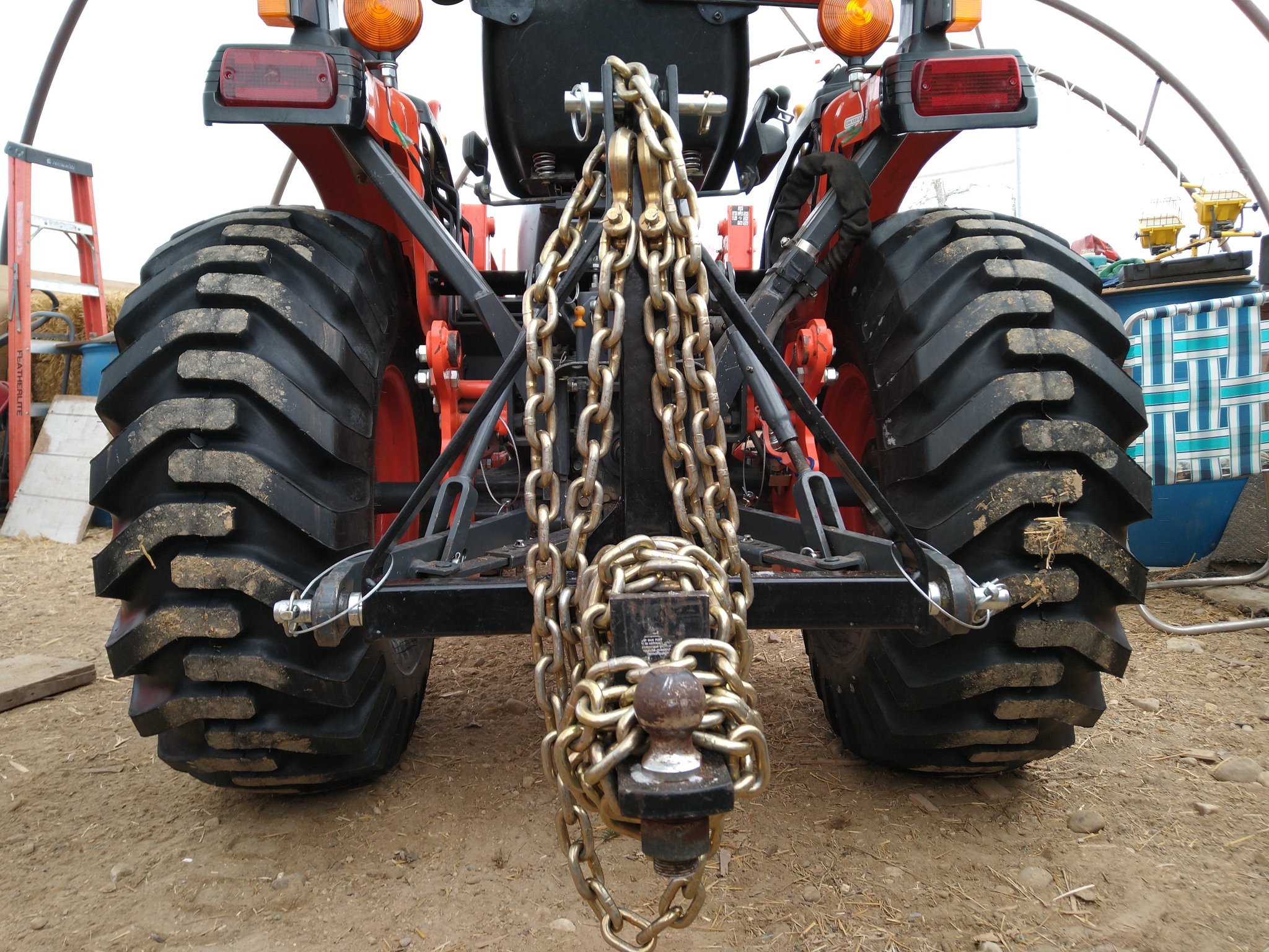

I got one of these and haven't regretted it in the least. Not granite countertops, but a full load of green tamarack (the pics show part loads) isn't light, either. And rough trails (roads) for sure. You may want to look up some kind of 3-point chain or bar stop system to keep the 3-point firmly down where you want it, so it doesn't flip up to its topmost extent with braking and a load behind it, or when unloading where loads shifting back can make tongue weight go negative. I travel very slow and easy with my hitched loads and keep the tongue height well under control, so haven't really needed a stay.

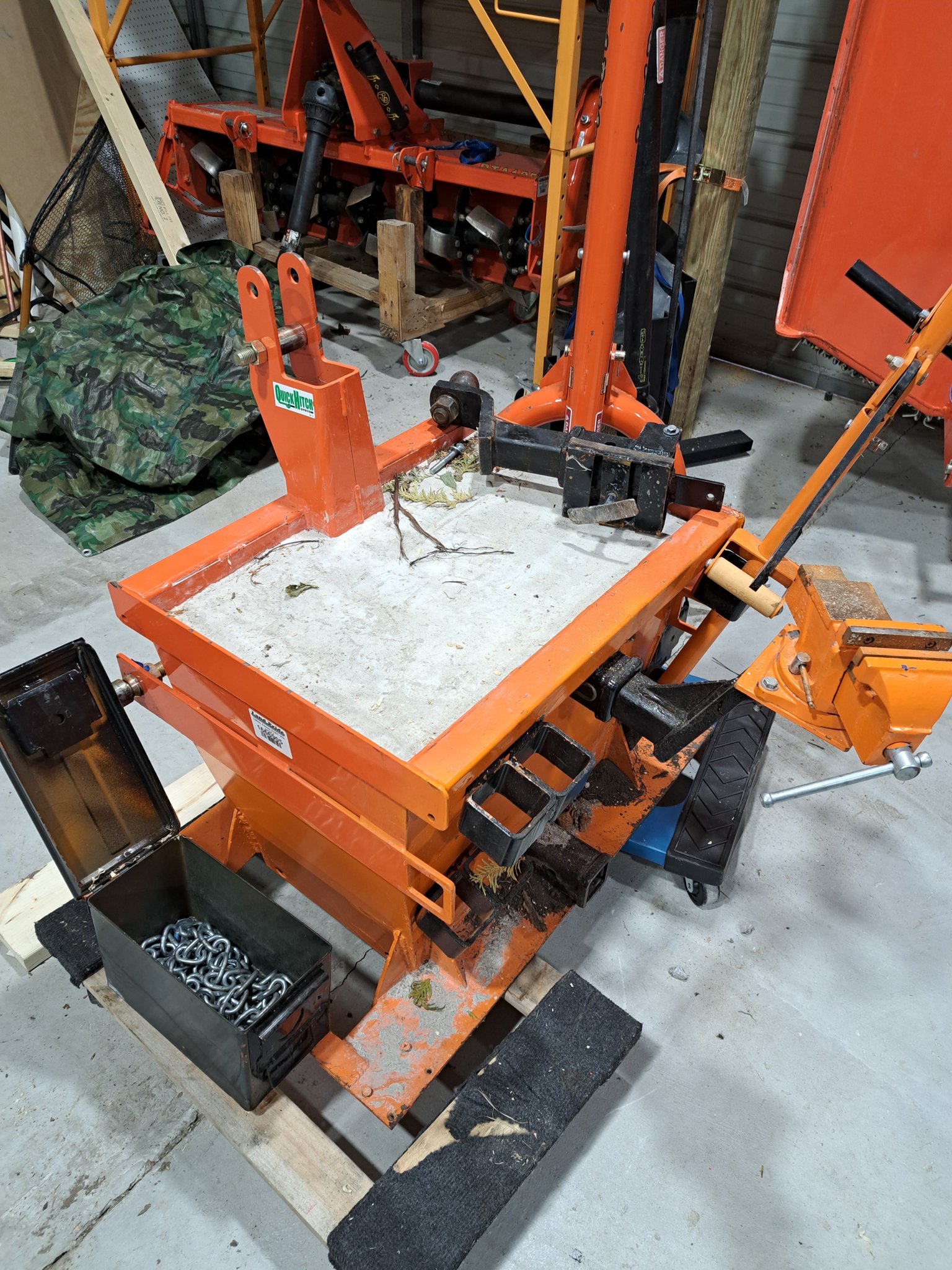

Got 2 on my ballast box.
