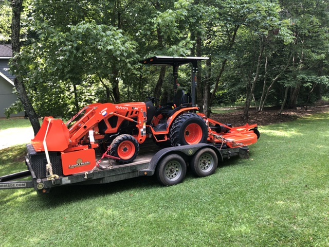

LX2610 on a Gatormade 16’ trailer. I lost some room with the toolbox and box scrape up front. And didn’t have enough tongue weight. May remove the box for a smaller unit that mounts in the tongue triangle. Dual 3500# axles, brakes on both.

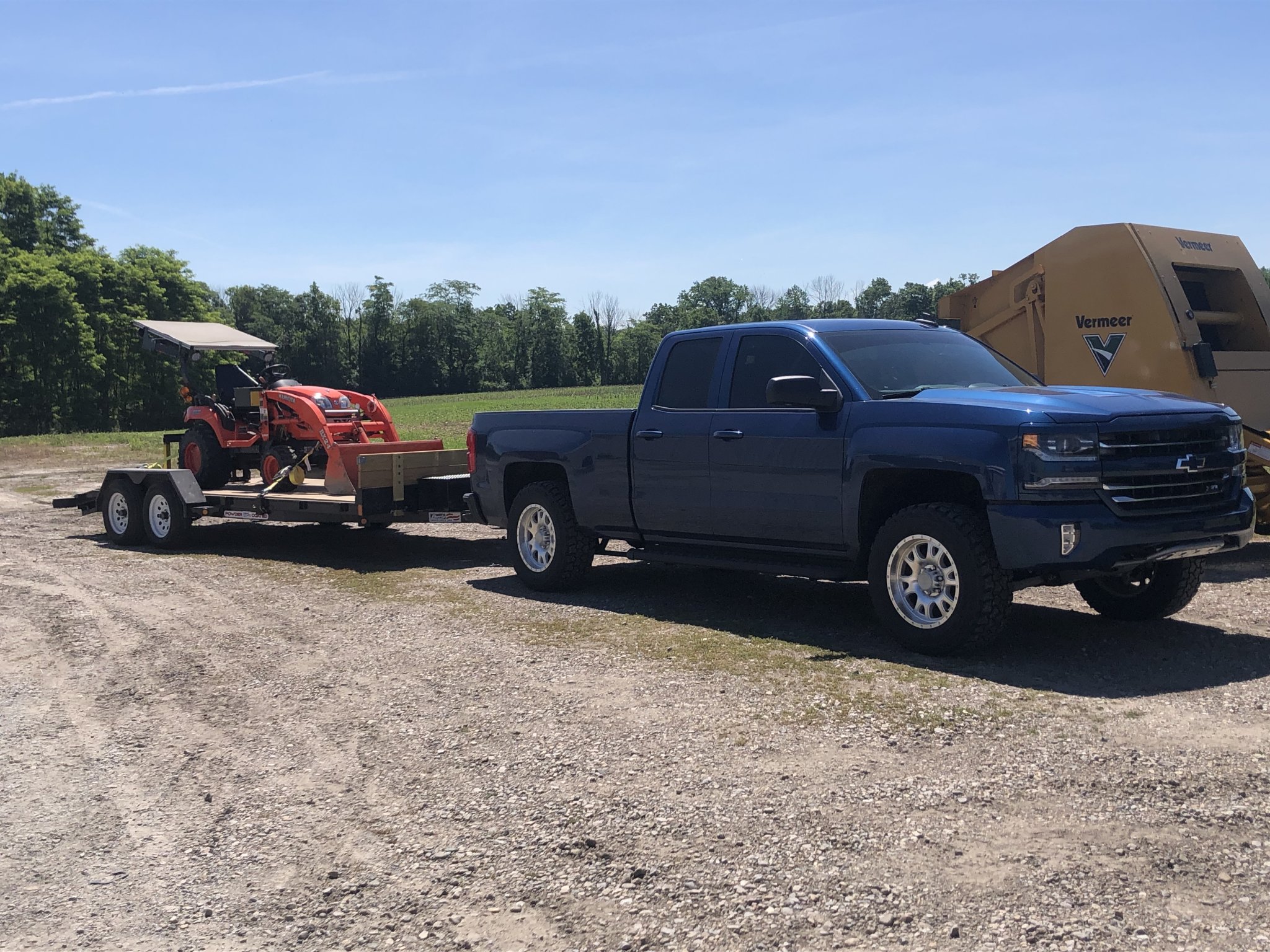

Do you own any attachments? Do you plan to get more? Do you ever plan to haul them? Are you good with a trailer?
I haul my tractor everywhere and I have been doing it for over 20 years. I have hauled them on/in just about everything. I always seem to have some configuration of attachments with me.
For me I would go with a MINIMUM of 20'.
In theory this will last you 10 years or more, get the right size if possible to avoid needing to upgrade.
This was my heaviest setup at 4463Lbs, + 1825 for the trailer = 6288.

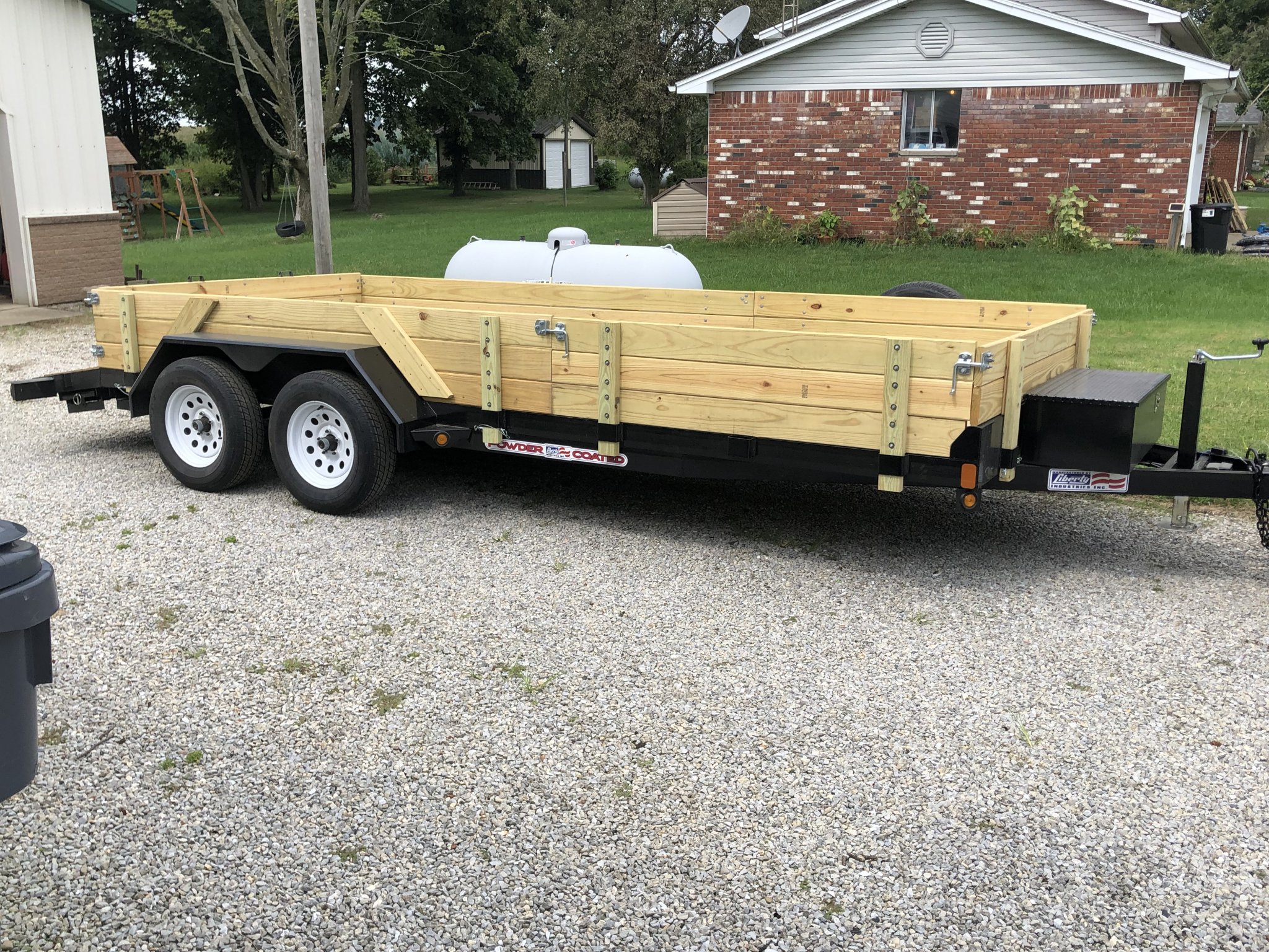

After much comparisons, I went with a Liberty Industries 18ft 7K car hauler. It has brakes on both axles, a set back 12K jack to allow dropping the tailgate without hitting the jack, and stamped steel dimpled ramps. I built side boards to haul loose materials.
