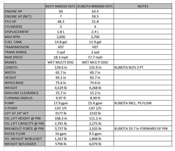

@nota4re, this is a very good thread that you started. I didn't know anything about Kioti a few weeks ago but I started looking closely at them recently and was able to drive an RX7320 yesterday which was revealing. There is no question that Kioti offers an incredible value and possibly a better option for many of us that end up buying a Kubota. I would have really liked to test or at least look at an NX6010 HSTC since that's the most obvious competitor to the MX6000 HSTC that I have coming in soon.
When I compared the MX6000 with a cab to the NX6010 with a cab it confirmed for me that if price is not a concern I'd pick the MX mostly because I prefer a 4 cylinder 2.4L engine putting out 60 hp net over a 3 cylinder 1.8L engine putting out 60 hp gross. I don't know what the NX costs because unlike Kubota's website I'm not able to "build and price" a tractor so I don't know if the NX is $10k to $15k cheaper but it probably is, particularly once you add in all of the desirable options. I think the cab interior of the NX is nicer based on photos but ultimately I feel that I made the right choice with the MX. Kioti is too much of an unknown for me and despite the specs on paper where the NX is superior, mostly in lift capacity, I don't think I'd be in a situation where the difference would be important.
If I were choosing between an M7060 and RX7320 the same problem of engine size shows up. The M has a 3.3L engine compared the 2.4L in the RX which is the same displacement as the MX engine. Other than that the RX checks all of the boxes, and if ever I am able or willing to sell the MX6000 ROPS model and decide that I need or want an M7060 or RX730 I'll be taking another long look at the RX.
I will say that although the Kioti dealership up here is basically one guy in a shed, he's very knowledgeable and extremely nice. I do have a great relationship with the local Kubota dealership so that's definitely a big draw for me, plus they have a proper, full-service facility that I find myself visiting way too much. :)

As I referenced, the DK4210SE has a lift capacity to full height of 2,474 lbs. In contrast, the Kubota MX series is 2275 lbs and the L4701 is only 1684 lbs. From a price perspective, maybe the L4701 is closest - but the DK4219SE has 50% more front lift capacity. That is significant. Even if you move up to a Grand L, the specs just do not compare. (The total gpm hydraulic flow in the Grand L is 13.9 gpm compared to 16.5 gpm in the Kioti... resulting in less lift capability.)
I think it should be noted that the MX and L4701 both have 4 cylinder, 2.4L displacement engines compared to the 3 cylinder, 1.8L engine in the DK4210SE so that accounts for some of the cost difference.
It is interesting to look at the differences in lift capacity. If you look at the table in my previous post, the NX loader/bucket is significantly lighter than the Kuboto loader/bucket. The difference in lift capacity is very similar to the difference in loader weight.
All of your points are very good - most especially the type of dealer supporting each product and their proximity to you!
The other thing is that you are comparing larger tractors than I was. Where my opinion that one was better than another - in the segment that I was more closely scrutinizing.... and it doesn't mean that the same opinion would necessarily apply to a larger, higher-HP segment.
But, it's all-good. I'm just sharing my findings. I just think where it's possible, buyers should have a look at other options - maybe the worst thing that could happen is that it could help you negotiate a better deal on that new Kubota!
