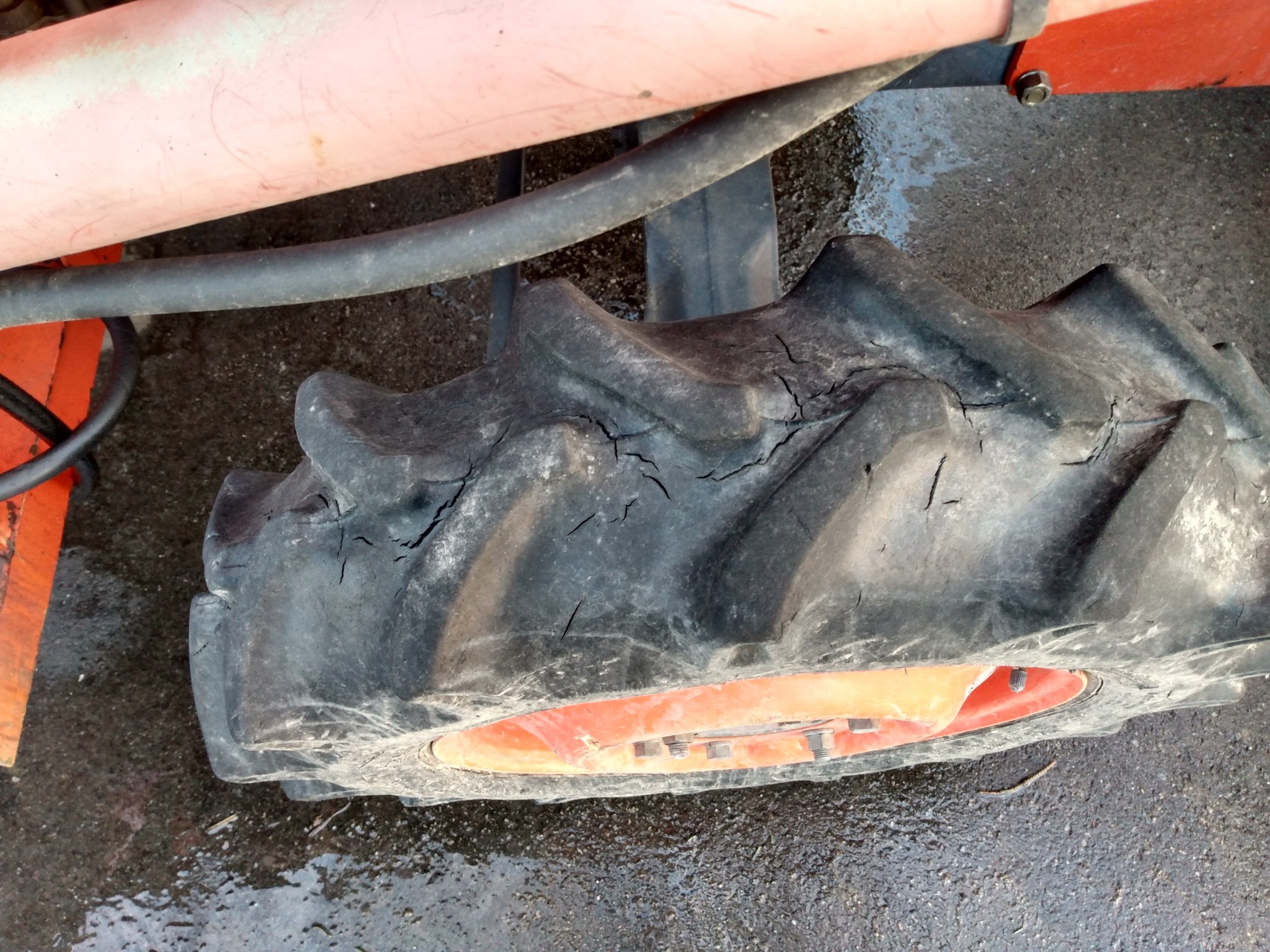

Proper storage is required to avoid problems like this. Due to some abuse and weather damage I offered half (plus $500) of this tractors worth if garaged and in good shape. I think I offered to much and was still rejected.

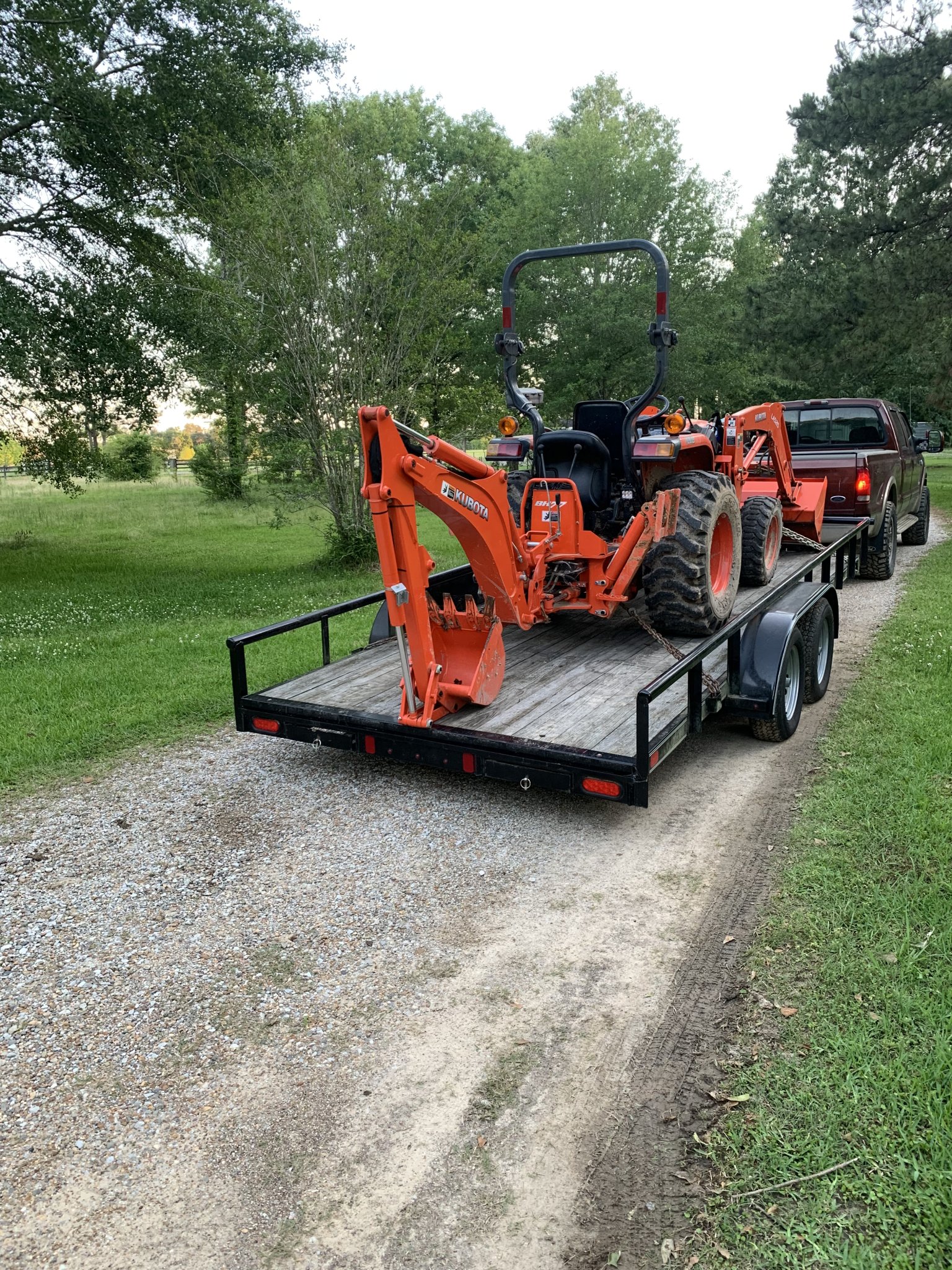

No the back hoe doesn’t stick up above the ROPS, and it’s roughly 18-19ft long, pics for reference…(trailer is 18ft)
