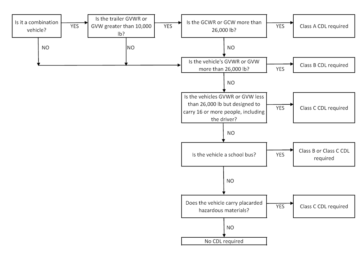

NorthwoodsLife said:
My concern now is wether I have to stop at the hiway scales ??
I'll be traveling cross country, non commercial. Personal use only.
Run through this flow chart ... it might help. Seems to me that you don't need a CDL and don't need to stop at weigh stations. Every weigh station I passed on the 600 mile trip from Sheridan, WY to Kalispell, MT pulling a 15k registered trailer behind an '02 F250 7.3L stated "vehicles over 26,000lb must stop" and mentioned nothing about GCVWR. I didn't stop at any of them and had a CVW of 19,500lb.
You need to remember it is highly up to the state laws as well as the mood of the cop. Also check to make sure you have the truck registered right for combination weight. It's been a big push around here.

Interesting.
But running through the chart above using @NorthwoodsLife truck and trailer he doesn't need a CDL and therefore doesn't need to stop at a weigh station. I'm probably being a bit slow but what would he be in violation of assuming that the max trailer weight doesn't exceed 12.5k, his GCVW doesn't exceed 19.5k. and adding in tongue weight, fuel, occupants etc., his GVW doesn't exceed 10k?
Truck GVWR > 10k
Max trailer weight > 12.5k
Trailer GVWR > 15k
GCWR > 19.5k

yes no disagreement there. However, we all still have to comply with GVCW rating. That's why it's a rating / limitation.
I'm really slow this morning and still not seeing the value of @NorthwoodsLife derating his trailer. Obviously he wouldn't be in compliance with the stickers on his truck or Ford's published specs if he were to load up the trailer to it's GVWR of 15k, but as long as he keeps it under 12.5k I don't see why he would get a ticket.
