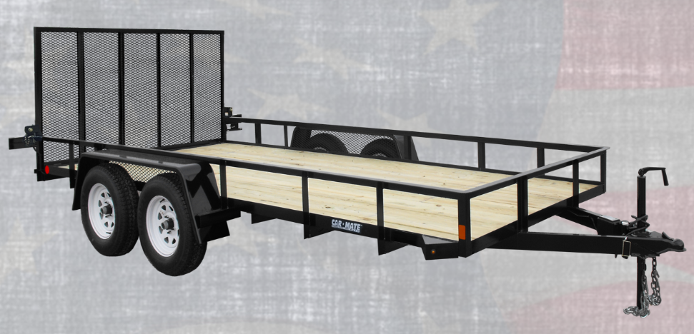

I have a 14 foot, 80" wide trailer.
I'm wondering if this is possible or whether it's a horrible idea.

The trailer:

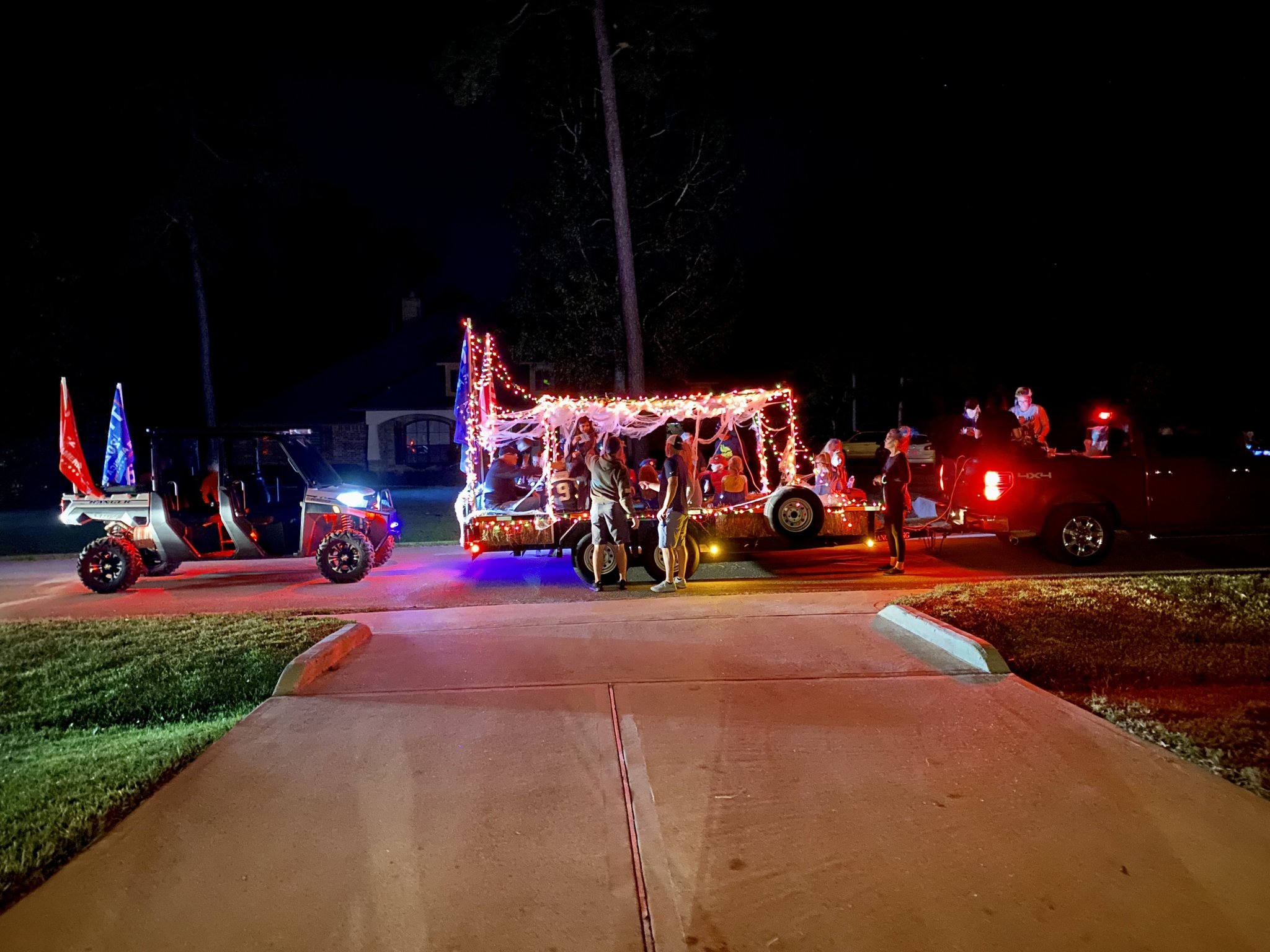

In our subdivision, all the houses are on acreage, so the kids can't run house to house to trick or treat.
The residents sit out on lawn chairs on their driveway near the street. . .
Every Halloween we get around 100 kids all riding on flatbed trailers with hay that ride through the subdivision.
We give out single bags of popcorn to each kid.
Last year we gave out 92 bags of popcorn. It's cheaper than candy and the kids like it better.
Consider using your truck instead of the tractor to pull the trailer. You could use the flashers on the truck to give more visibility to your trailer.
It would be a safer option.
It would be a safer option. View attachment 111368
That what I'm going for. Looks like a great experience for the kids.
All the houses are on at least 2 acres.
In my neighborhood we sit at the end of our driveways, have a portable bonfire and drinks.
The picture may make it seem like a busy roadway. It's actually very private. The only people who drive down this road are the people who live there as there is no exit. The type of road where we can play catch in the road and stop whenever a neighbor happens to drive by.
