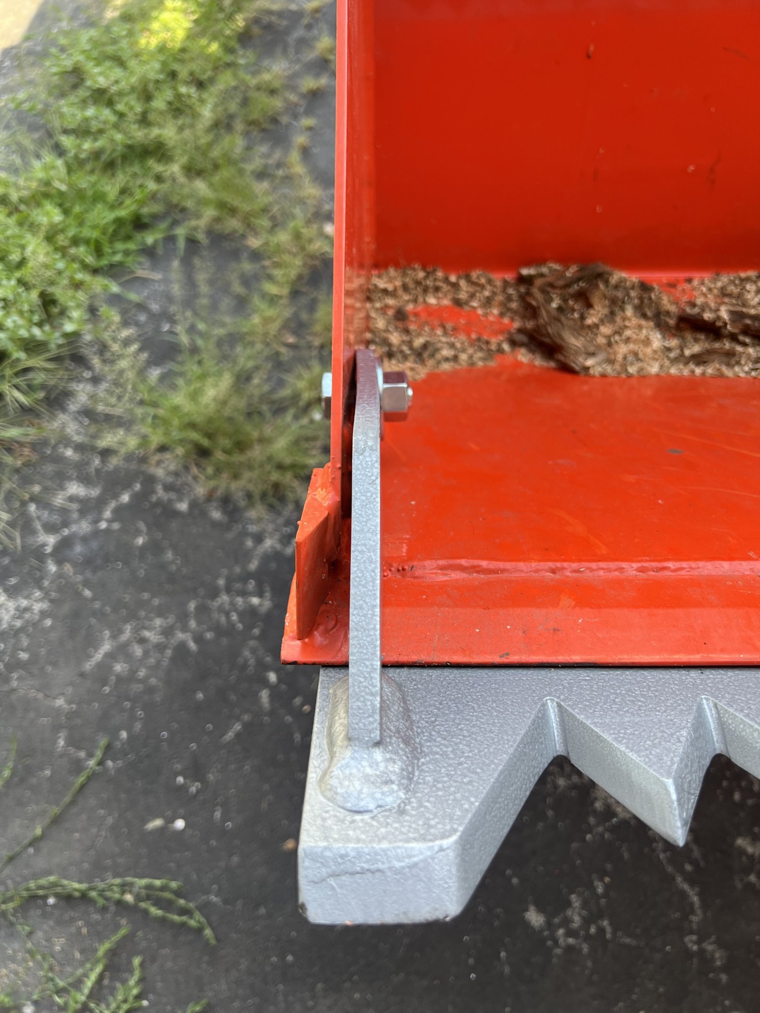

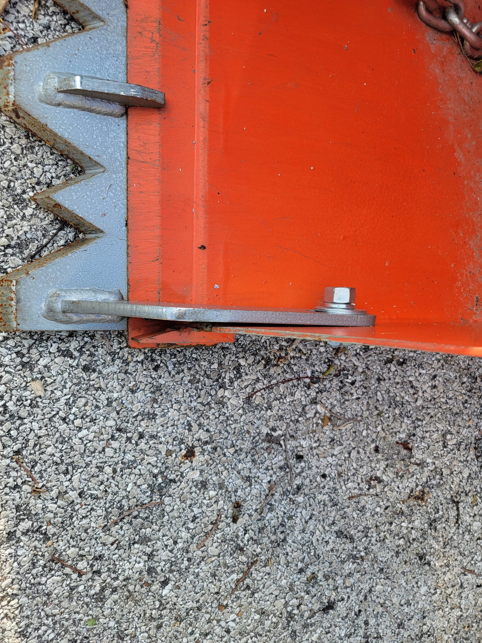

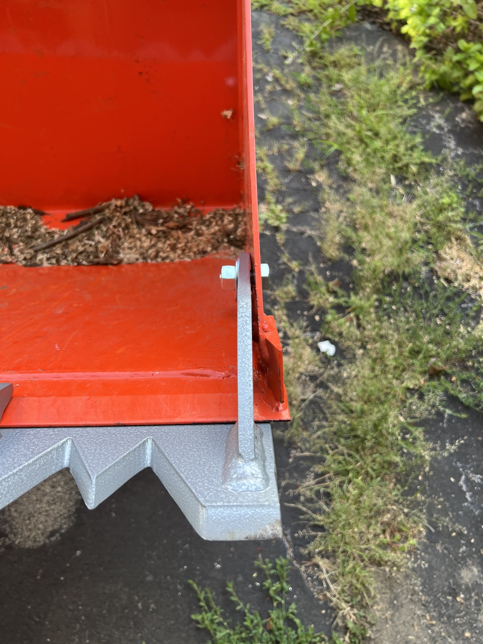

Hello, I just got a Bxpanded Piranha toothbar for my B2601 and had a couple questions.
Is it normal for the bottom cutting edge to not cover the bucket cutting edge? Mine is about an inch short.
In the package it came with two flat washers and a lock washer per side, but the bolt wasn’t long enough to actually get the lock washer on so I went without. Has anyone had issues of the bolts coming loose without a lock washer?
I want to be clear, the toothbar itself looks good, it’s heavy duty so no complaints. I called yesterday afternoon to ask and was transferred to someone else and just left a voicemail so I figured I’d ask about other experiences.
adding a picture of each side to show.

Mine fits about the same as yours shows…I remember there being a bit of an issue with the bolts and washers, pretty sure I got one side started then used vice grips to pull the other side against the bucket side to get them on (it’s been a few years since I put it on 😂).

I tried that, but didn't have a pair big enough to actually pull the toothbar mounting tab over enough to get the lock washer on. I actually got two pairs to try and get it pulled over as much as I could.

Width is fine. The bars on the sides are bendable enough to form to the sides of your bucket. Looks like they need to be first tightened more, then install the lock washers.
Unlike other tooth bars most people don’t need to ever take off the Piranha tooth bar.
They make world of difference digging and clearing brush. Enjoy!
C clamp?
11,242
4,817
You need to fill the gap between bucket and bar with washers.
Also be sure to neverseize the fasteners, cause you do NOT want the bar on when pushing 'white' in 3 months time !

Those side bars will bend flush against the bucket sides when tight enough. Looks like you used a wood block to tightly engage the bar to the bucket edge. Get in the dirt!

After snapping the pictures, I did crank down the bolts tight. There is still a gap, but my bucket has some welded on pieces on the inside that the bar mounting tabs are tight against so it looks worse than it is.
I didn’t grab my impact, but maybe I’ll do that to see if I can get it tighter to bend a bit more. I don’t have a M18 high torque, but I have a mid torque, and a pneumatic impact so that should do it. 😅
I do like the idea of adding some never seize and possibly a lock nut if I just can’t get the lock washer on.
