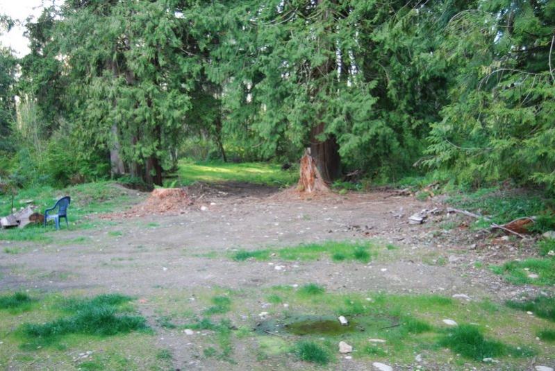

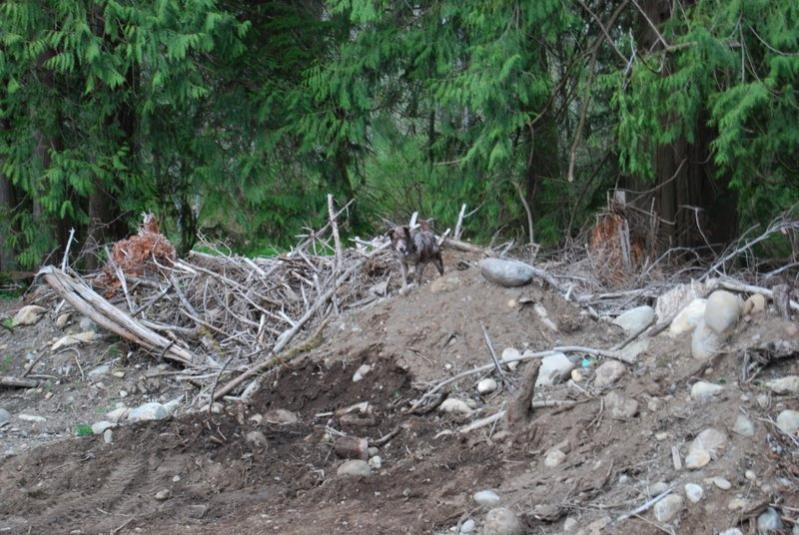

It's been awhile since I have posted, but I wanted to add my praise of the Piranha. I put it on my B7610 in 2013 and have used it to clear slash piles, move logs, 75 yards of gravel, level ground, and the list goes on. I added Green Machines "The Thumb" at the same time which made the tooth bar even better. Here are the before and after pictures of one of the 3 slash piles. This one started at about 60'x40'x10'. This never would have been cleared if it wasn't for the tractor and Piranha.
